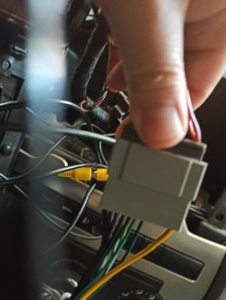

  • Request for USB cable pinout and wire colors
    #47 19769144
    BartekNowaczyk
    Posts: 7
    Hello, can anyone send photos of the USB cable to these Chinese radios, there are cables with 6 and 4 pin terminals, I would need information on which pin comes with which color from the USB socket. I miss a cable and I would like to try this recovery using the keyboard because my radio stops on the Android man and does not want to start. Eunavi radio for Peugeot with tactile buttons on the left side and microSD slot. No knobs. Please reply. Greetings
  • #48 19769200
    bubu1769
    Posts: 8065
    Help: 1177
    Rate: 2375
    Give me a photo or an exact model of this radio.
  • #49 19769271
    BartekNowaczyk
    Posts: 7
    Welcome to the photos again, the radio with which I have a problem is visible

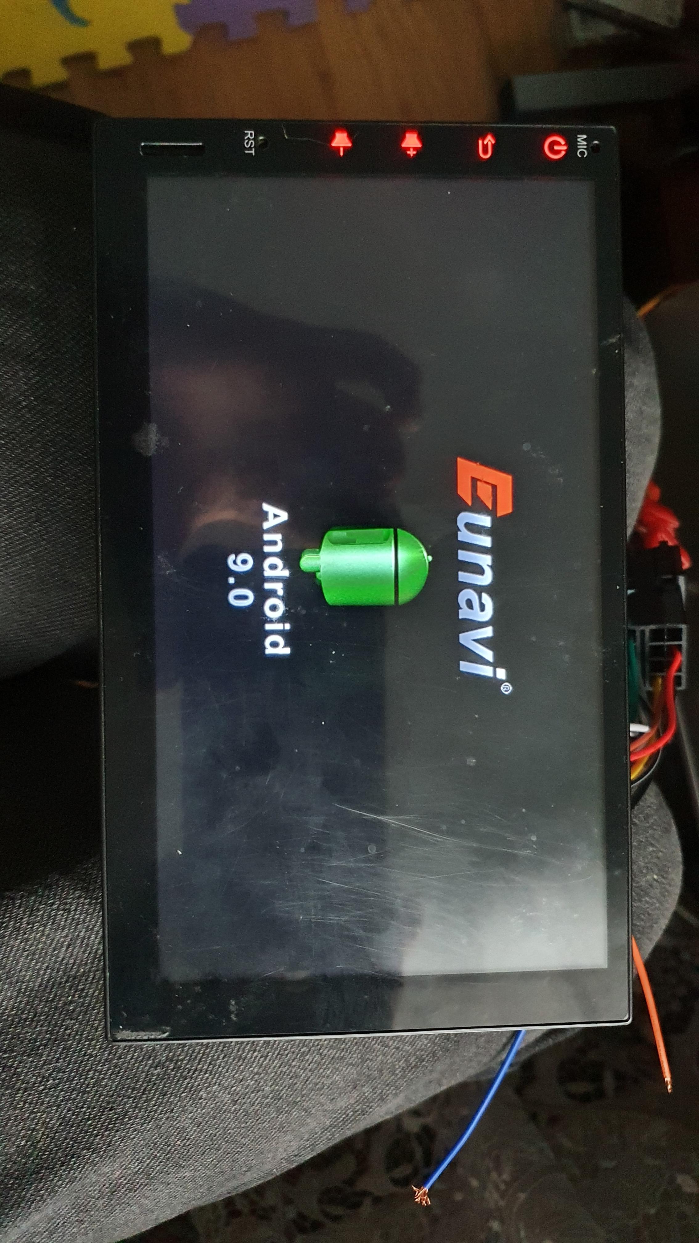

  • Reset button only triggers a normal reboot
    #51 19769544
    BartekNowaczyk
    Posts: 7
    Unfortunately, after connecting the keyboard as described above, the combination of alt print screen and keys does not work, I think it is connected well because after powering the radio, the keyboard lights up, maybe any other suggestions to get to the recovery menu on the radio that I sent in the pictures above? After pressing the reset button, the radio resets absolutely long holding the button causes the same long period to start the radio, the process does not start until you release the button, when you start the Peugeot logo starts, then the eunavi logo and the spinning android and so it stands unchanged

  • Keyboard shortcut failed to enter recovery mode
    #53 19830372
    screammarket
    Did you manage to enter Hard Reset?
  • Keyboard shortcut failed to enter recovery menu
    #54 19830638
    BartekNowaczyk
    Posts: 7
    Unfortunately, so far I am waiting for suggestions
