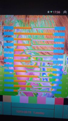

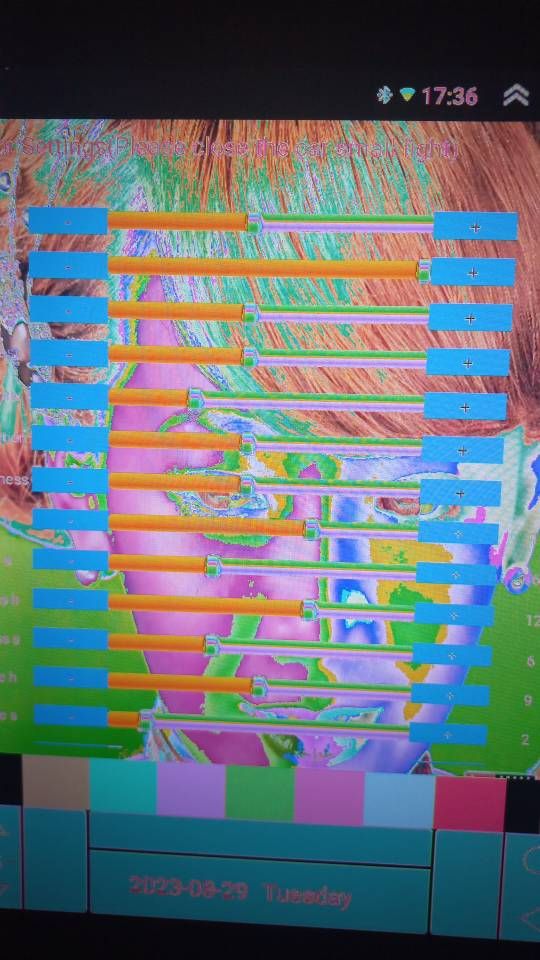

    ekoschs7117
    Glitched screen with colorful distortions and vertical bars.
    I have a problem with the color or resolution too.
    Reboot, clear cache, factory reset are not working to recover the display.
    Anyone?

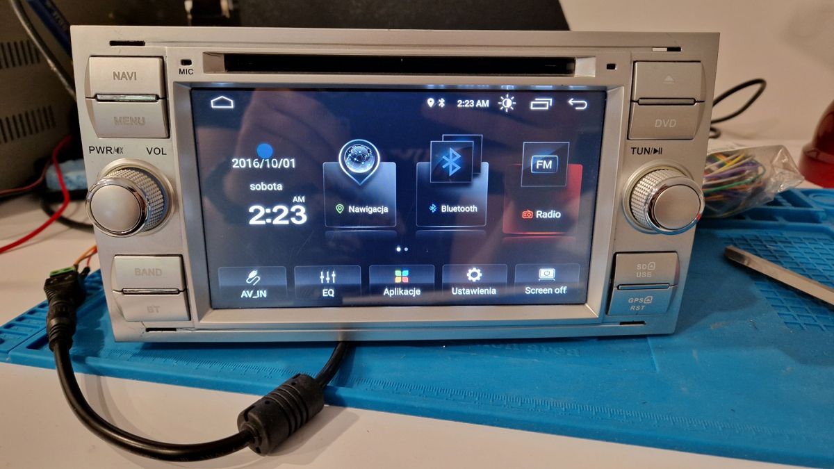

    #65 21120109
    bartoszkola621
    >>20752887 .
    In the case of my Ford radio from Shenzen ZYC Car Electronics (zycgotec), knocking on the touchscreen a few times with 5 fingers while the "FORD" logo was displayed (before booting android) actually helped and automatically started the factory reset process.
    This solved my problem with getting stuck on the "Android" logo during boot up caused by memory overflow.
    Exact radio model:
    Shenzen ZYC Car Electronics ZYC-7239 Siliver
    ZYC-7In 06FuTe 8227L-A10.0 S
    Shenzen ZYC Car Electronics car multimedia system with touchscreen. .

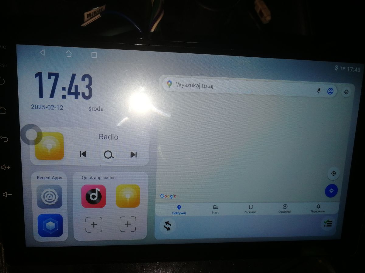

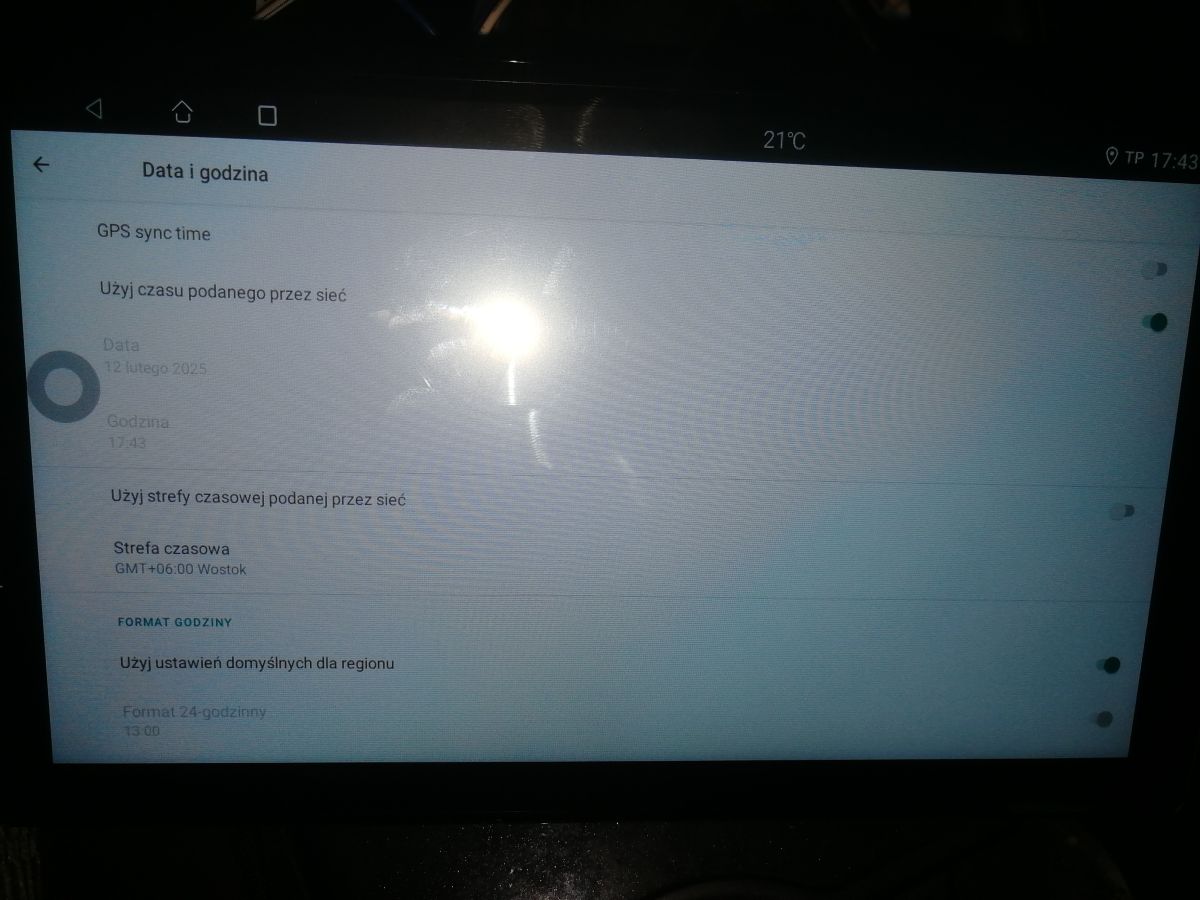

    Please help. I was playing with the settings of the radio from china (9 inch screen with Android supposedly version 14) and I messed something up, namely I was playing with the settings of "blut", "host" and yes I changed the start screen settings in the vehicle settings options.
    Now the touchscreen does not work properly. I probably messed up something with the resolution. Also the illuminated buttons on the left side do not work.
    When I turn on the car and switch on the radio, the start screen appears, but I can hardly start anything on this screen. I can start the radio, like a music or video programme, but from the buttons under the steering wheel, as well as set the volume. The only thing that appears when I press on some part of the start screen is the "Date and time" settings screen. I can't set the time, like the date and the screen behaves strangely. There is nothing to undo, back to the home screen. Before the crash I was looking at calibrating the screen and maybe I messed something up here.
    Restarting does nothing (restart by pressing the button inside in the top hole of the radio). The android boots to the home screen and the same as I described at the beginning. After turning the car off with the key and restarting, the radio starts and the rest of the buttons under the steering wheel work, and further non touch control, or rather misbehaves.
    My question now is whether I have corrupted the radio soft, and whether there is anything that can be done about it. I cannot enter the factory settings to return to the initial settings. I am referring to a hard reboot.
    I am attaching pics of the screen.
    Please help.

    #67 21650719
    AdamG123
    Posts: 122
    Help: 14
    Rate: 60
    I played around with this radio on Saturday. I entered the settings with the mouse and the scroll button worked. It was possible to enter the settings as before, but still the touch on the screen does not work. I suspect a badly calibrated screen. I don't have much time at the moment, but I will check the calibration in my spare time. If it doesn't work, I will check the factory settings. I have not yet checked the keyboard.
  • #68 21657057
    AdamG123
    Posts: 122
    Help: 14
    Rate: 60
    I redid the screen resolution settings and everything is back to normal. I also adjusted the function of the buttons on the left side and everything works. I entered the settings using the mouse. After setting a good resolution, the mouse is no longer needed.
