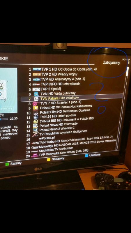

    I am looking for someone who knows how to delete information (message) on the screen in the upper right corner.
    On zgemma h2h I installed openpli 6.1, I downloaded oscam and all settings. The television works perfectly but the screen says "stopped" and in no way I can turn it off.
    Please help.

    I don't know this image, but maybe it is something responsible for timeshift?

    I think you're right but I still don't know how to turn it off. I changed the settings to disable timeshif and no warnings after stopping and still the same thing that after restart the message disappears for a few seconds and then comes back and does not disappear. Zgemma H2H / OpenPLI 6.1: Removing Stopped Message on Screen - Oscam Settings & Solutions

    And under the Record key you have selected Do not record?

    under the Record key I have options what I want to do. I can record - I checked
    I am still looking for a solution to the problem.

    See the memory cleaning plugin, run it or remove it.

    problem solved - I have run ClearMem plugin and the message has been disabled.
