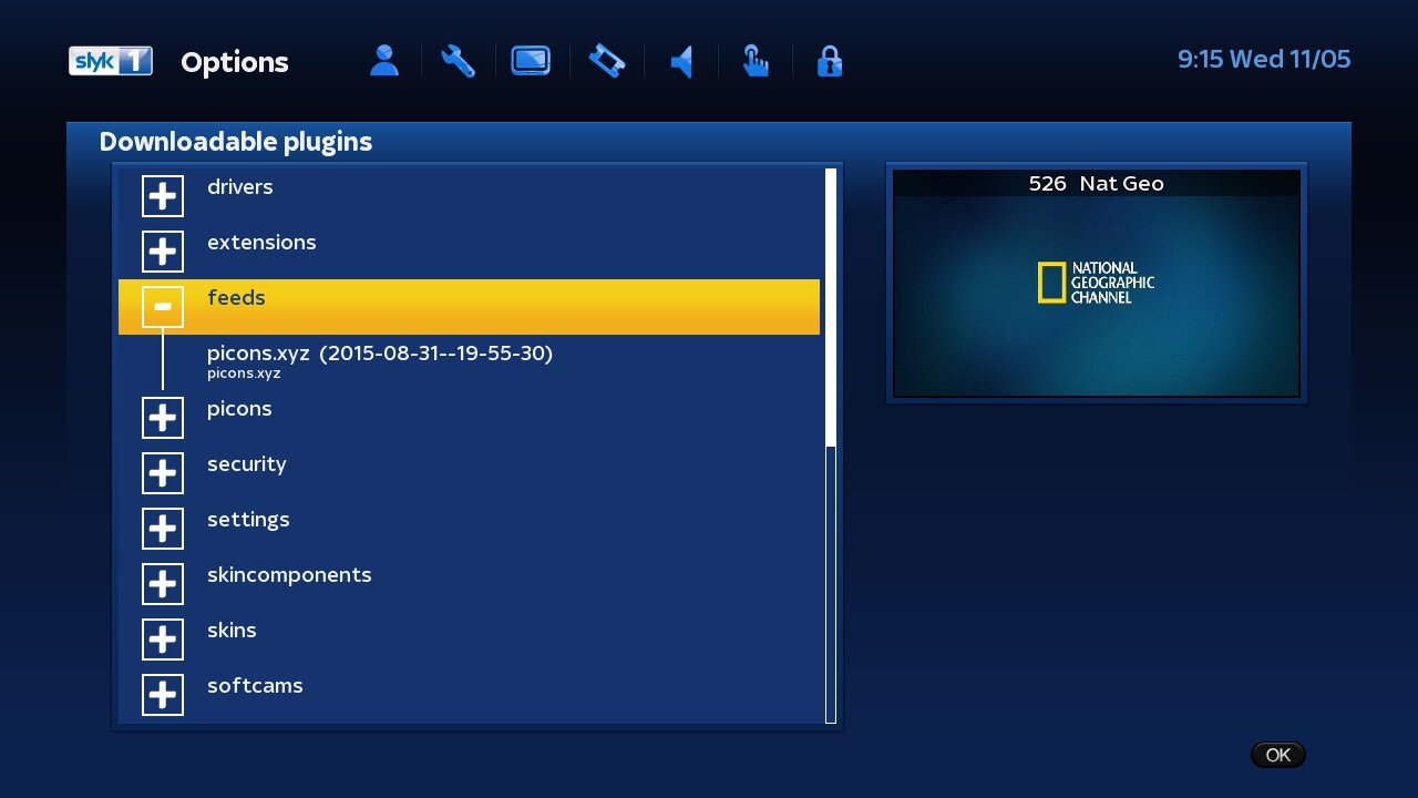

    Hello ,
    Zgemma H2H soft Open PLi 6.2 decoder I have a problem.
    Namely, in this post https://www.elektroda.pl/rtvforum/topic3459709.html, the first photo, in my case just the picon of the channels, there are only the channel number and name.
    How to set it, if I do not have a window like in the third photo from the top with options -> Display picons in the channel list .
    The picons for each channel are at the bottom of the TV screen in the Channel Info bar. Picons are also on OpenWebif.
    I don't have a picon, when I switch to the TV channel list. Bukiety "POLSKA FULL" Channels are numbered but there is no picon for any channel?
    Can someone help me out?

    This is how there are Picons in the bottom "bar" of information, ie that you have everything and only a matter of software.
    In the options, search for and download a driver?

    Look at this . I don't have this tuner. Zgemma H2H - Zgemma H2H Open PLi 6.2 no Pikon in the channel list

    I was suggested:
    Come in
    System Settings menu -> Allows GUI -> User interface -> Then Display picons on the channel list -> Give the green button save
    The worst thing is that if I do this the user interface, I only have Alternative numbering mode, Info bar display time and secondlnfofar display I DON'T have an item display picons in the channel list?
    EDIT EDIT EDIT
    One of the colleagues on the fb group suggested -> Change user mode in the menu to expert . Because you definitely have a simple one.
    I did the menu on expert because I had a straight one and it showed up show picons in channel list . Picons are now visible in the channel list !!!.
