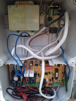

    I have a question, I have a problem, I have an avidsen double-leaf gate, but the switchboard / driver is so strange :) picture below
    I have two remotes programmed, original advisen 104700, now I bought my wife PHOENIX CONTRAT 50, apparently a replacement. And now I have a question how to go about it? To make it work

    1. Open the receiver and find the small SW1 button.
    2. Press and hold this button until the receiver turns on.
    3. Within 5 seconds, press the button on the remote control you want to register until the LED on the receiver starts flashing.
    4. After a few seconds, the LED diode on the receiver will turn off, which means that the receiver exits the programming mode.
    ps Not all "replacements" for these control units want to fit.

    I only have buttons like that
    Car
    Rf
    Clear
    RfLamp
    And
    Lamp
    O / C
    I looked on the internet, it seems to me that it is an avidsen sw200d1 control board
    For posterity I found a French manual I translated:
    Press the RF button for 2 seconds. LED1 will turn off.
    Within 10 seconds, press the button on the remote control, LED1 will blink 3 times
    If the system does not receive the code from the remote control within 10 seconds, LED1 will flash without flashing.
    Up to 8 remote controls can be registered.
