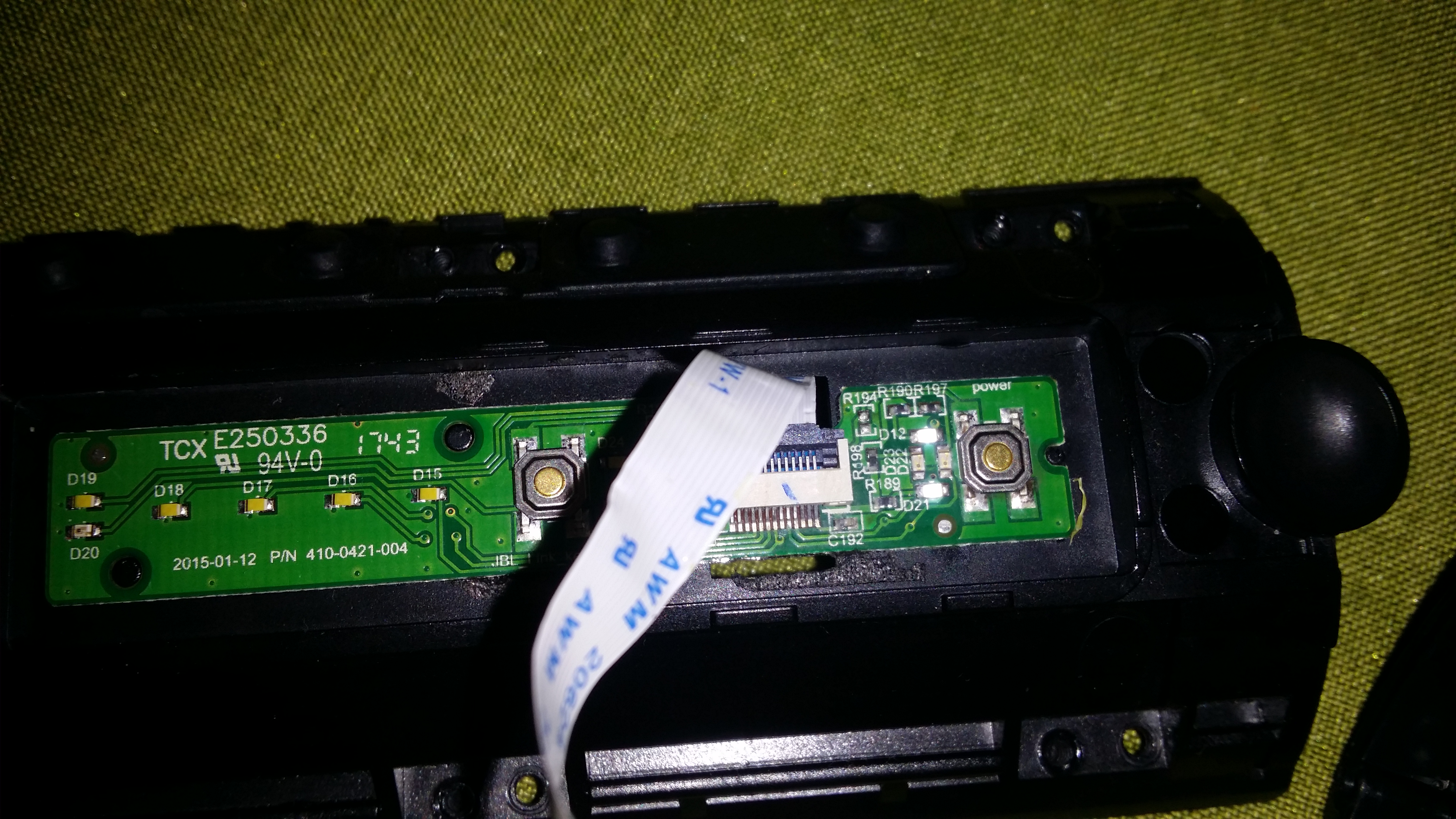

    Added after 26 [minutes]:

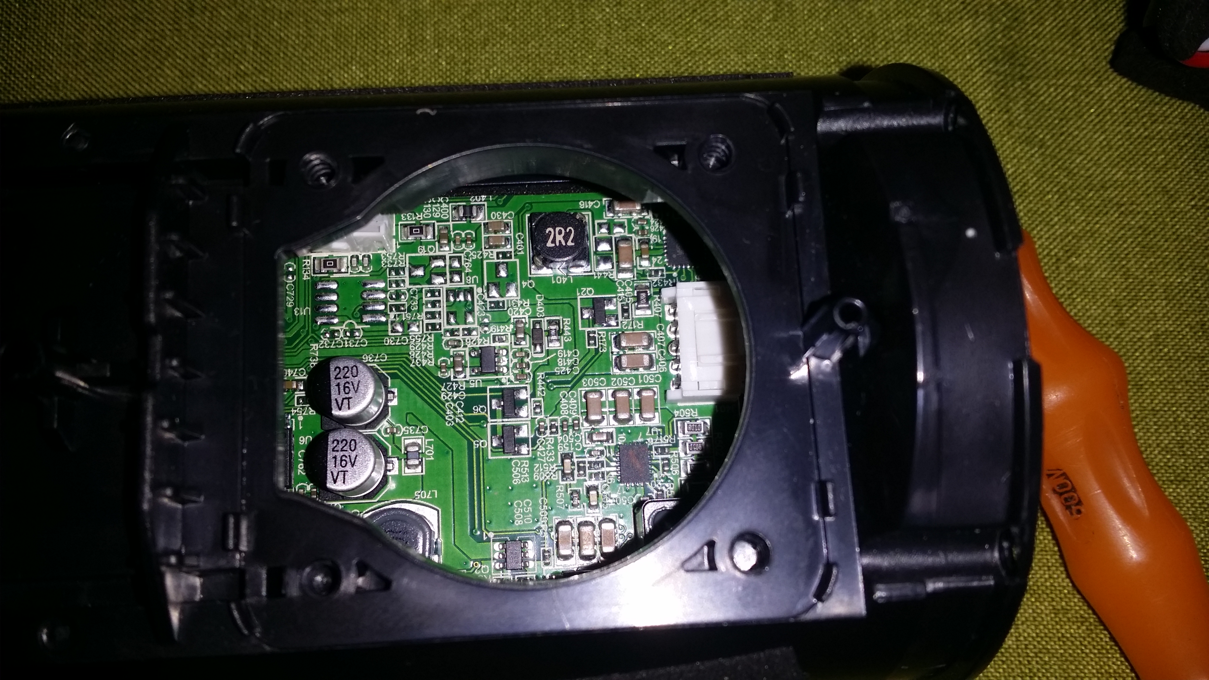

    Volume keys connected and now Almost everything works, almost ehhh ...
    Loud works, does not wheeze, everything is working, but bluetooth does not work, I will press the key, as if looking for the LEDs are blinking, but the phone does not find the loudspeaker ...

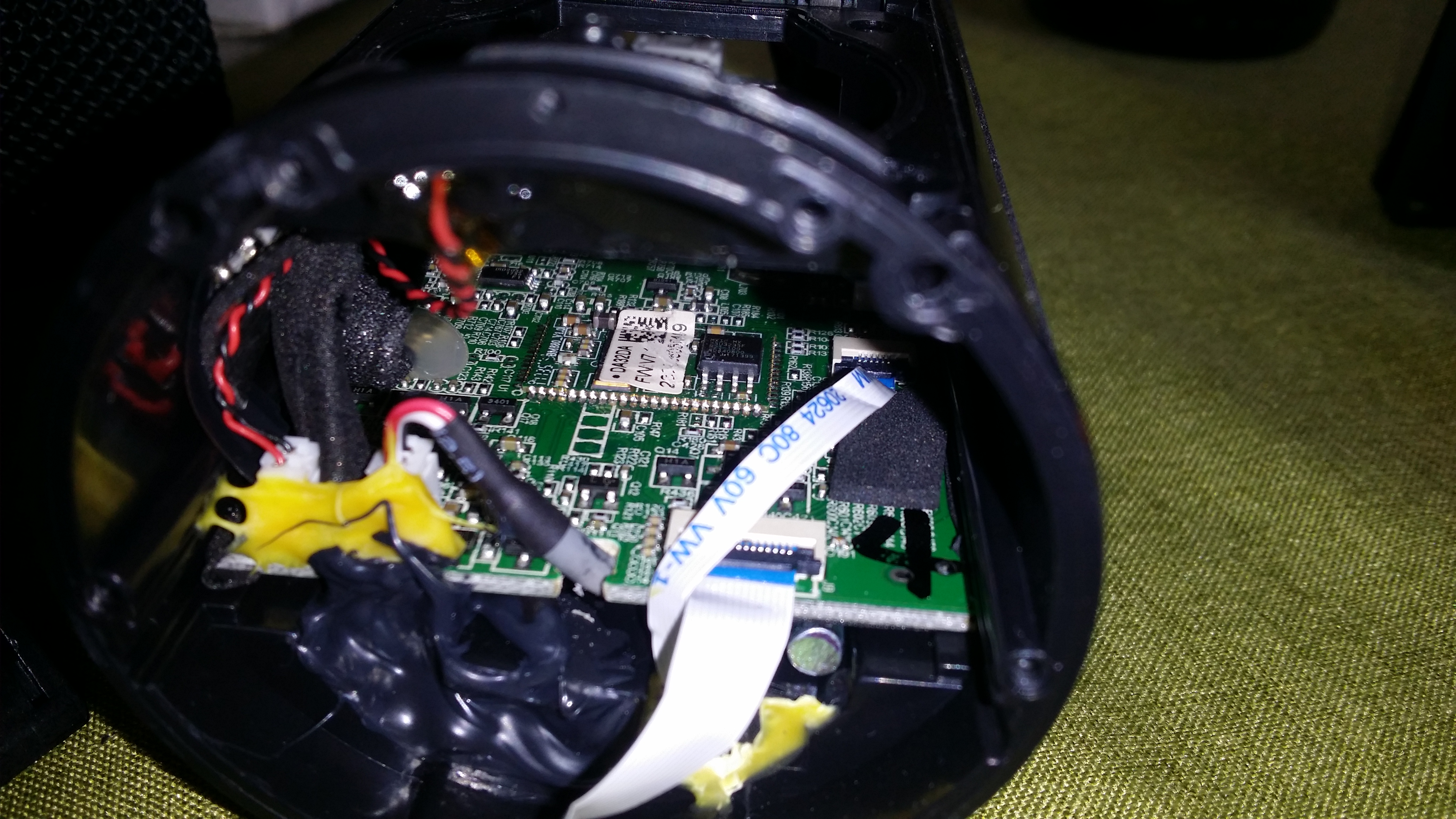

  • #32 17231276
    Qudlatyy
    Posts: 196
    Help: 18
    Rate: 36

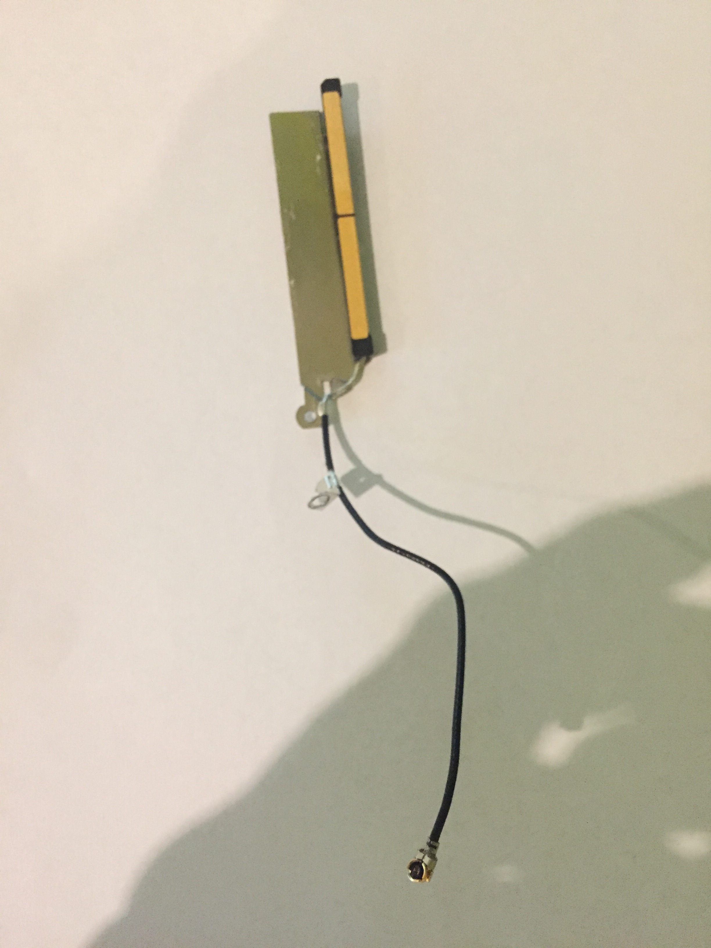

    Another trivial question is whether you connected the antenna JBL Flip 3 - Won't turn on or charge, no response please help.
  • #33 17231332
    kacperos9371
    Posts: 535
    Help: 13
    Rate: 145
    So the antenna is connected, I also connected another one for a test (from a MacBook) because the original one is stuck, but bluetooth still does not work. Even if the phone is 5 cm from the plate.
    Added after 29 [minutes]:
    I have already found the reason, there are badly signed button names on the button board, bluetooth is replaced with the phone, after checking it is fast, bluetooth works. This week I will assemble the speaker and write how it works. I would like to thank all of you for your help and the most to Mr. Qudlatyy. Kind regards.
  • #34 17231397
    Qudlatyy
    Posts: 196
    Help: 18
    Rate: 36

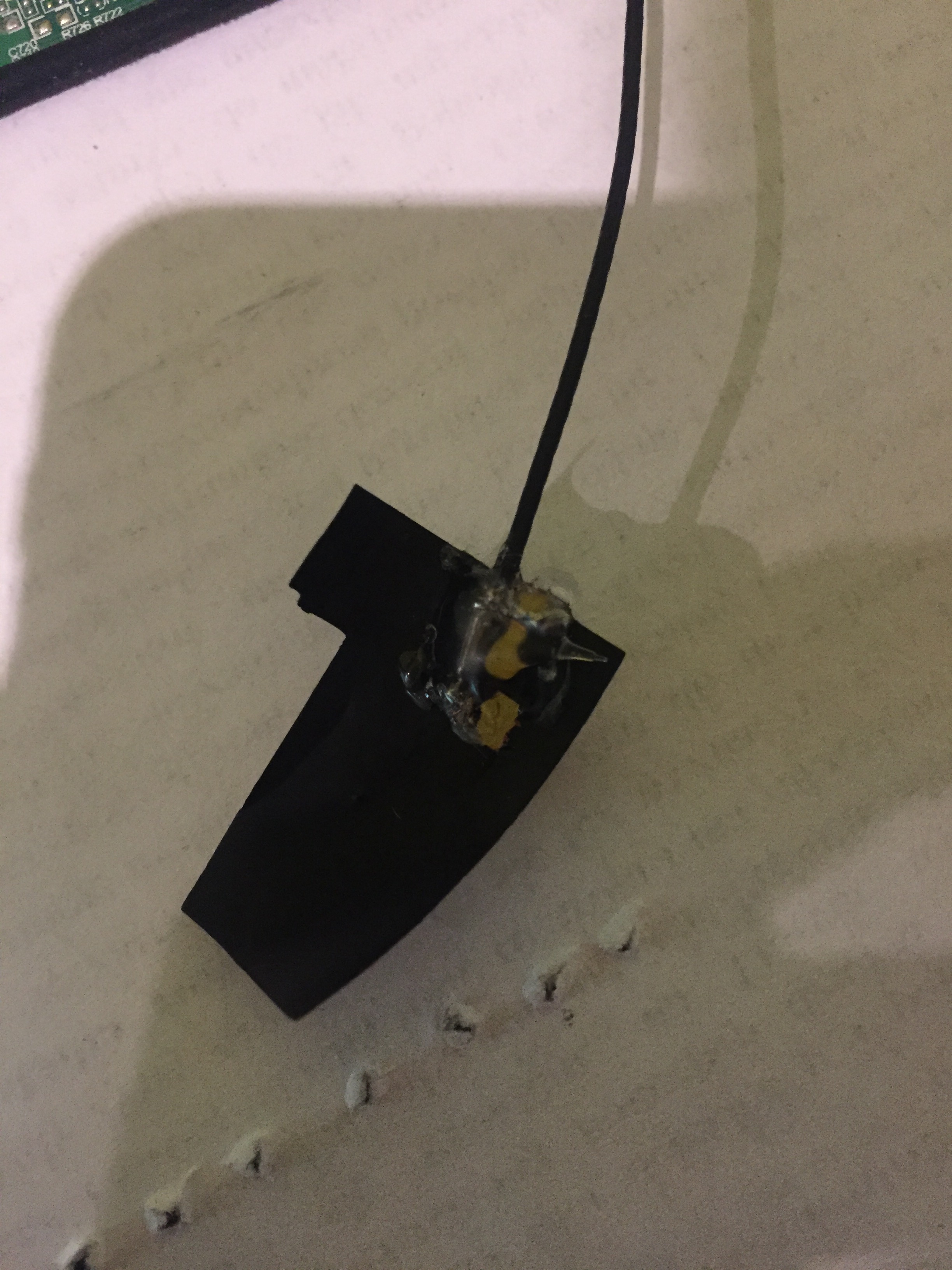

    Give me a picture of that sticky antenna
  • #35 17231407
    kacperos9371
    Posts: 535
    Help: 13
    Rate: 145

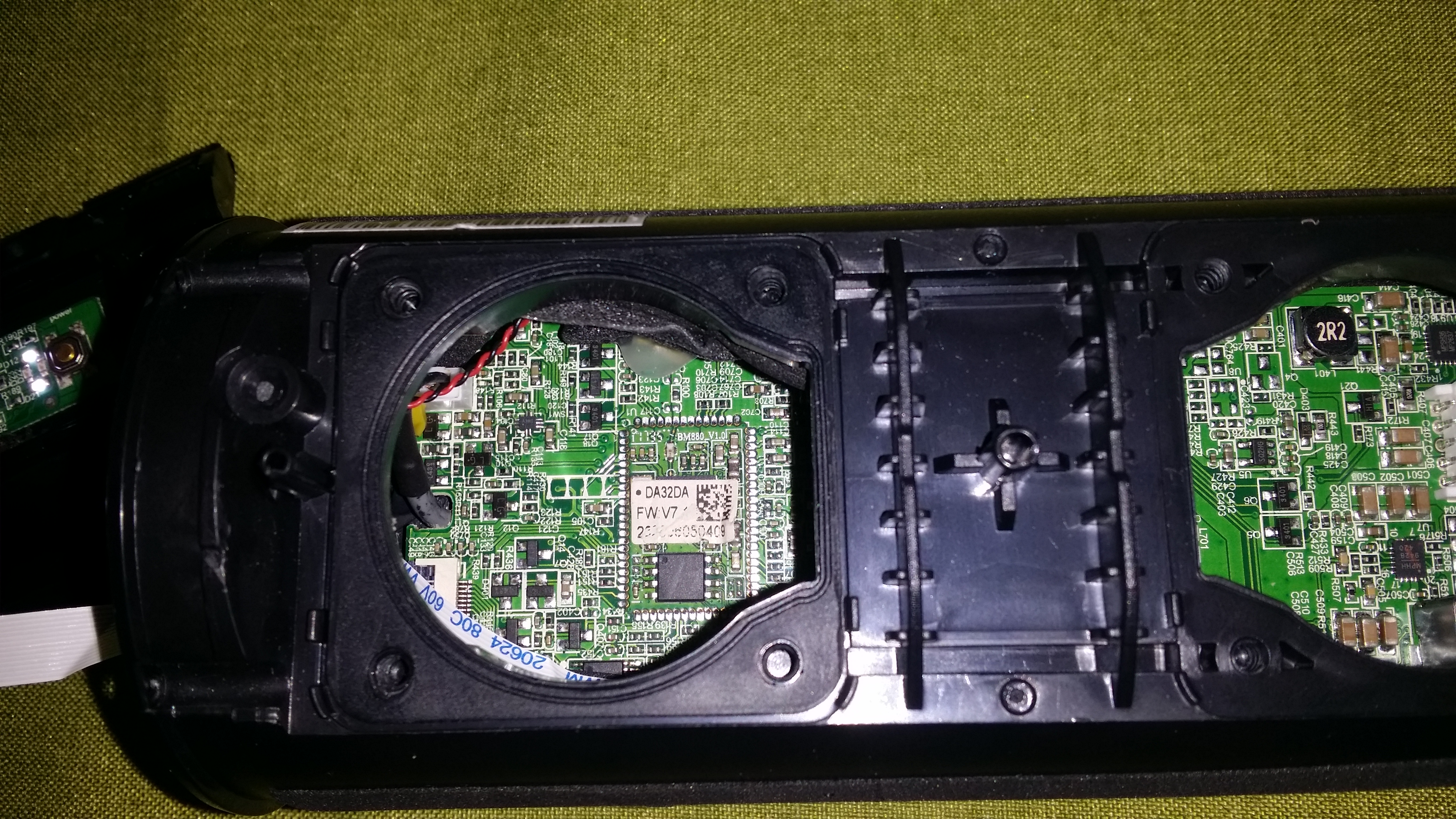

    Can I use the original one from the MacBook as in the second photo?

  • #36 17231689
    Qudlatyy
    Posts: 196
    Help: 18
    Rate: 36
    In my opinion, the one from the MacBook is not suitable
    The stuck one would have to be cleaned and re-soldered
    It looks like some kind of silicone or "warm glue"

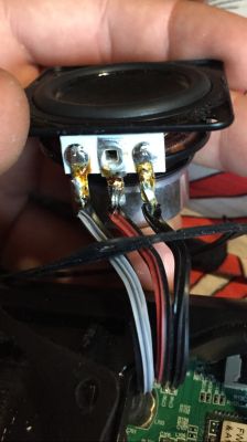

  • #38 17238112
    kacperos9371
    Posts: 535
    Help: 13
    Rate: 145

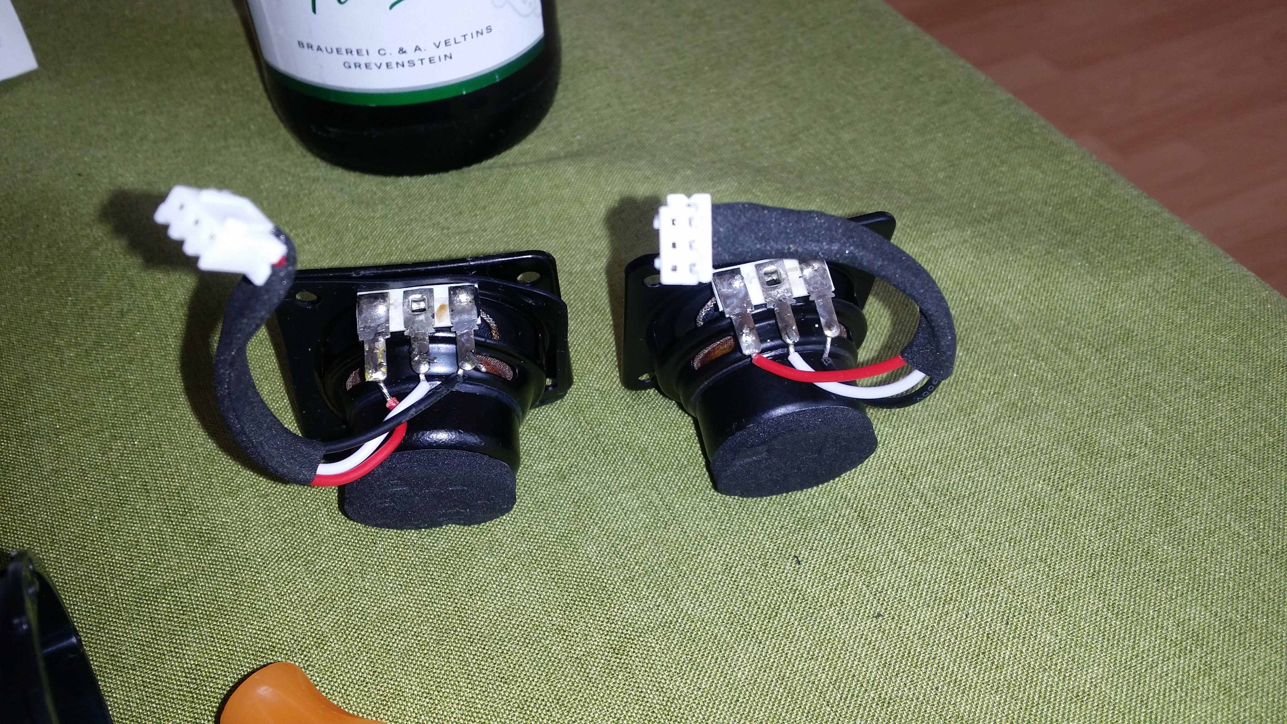

    The loudspeaker is already assembled, it sounds good.
    One more question, are the speaker cables well soldered?
    They were so soldered before but is the order right?
    [img-0] JBL Flip 3 - Won't turn on or charge, no response please help.

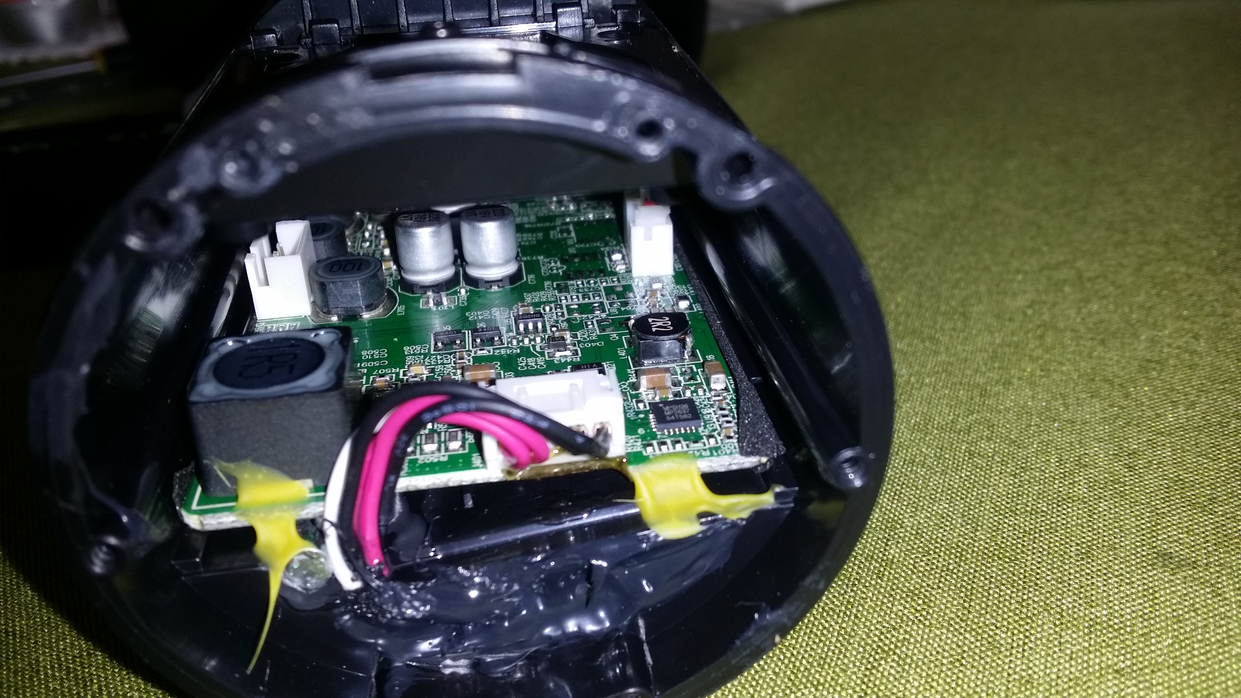

    Thanks for the answer, I actually connected the tape from the buttons the other way around, hence the problem. Unfortunately, the loudspeaker still does not work, which is what it used to be - it turns on, the welcome music and nothing else. It loads normally, but can only be turned off by pressing blut + vol +. The music doesn't work because of Jack. Anyone have any idea what might have died? I will also write that for me the cables are soldered differently to the speakers than for your kacperos.
