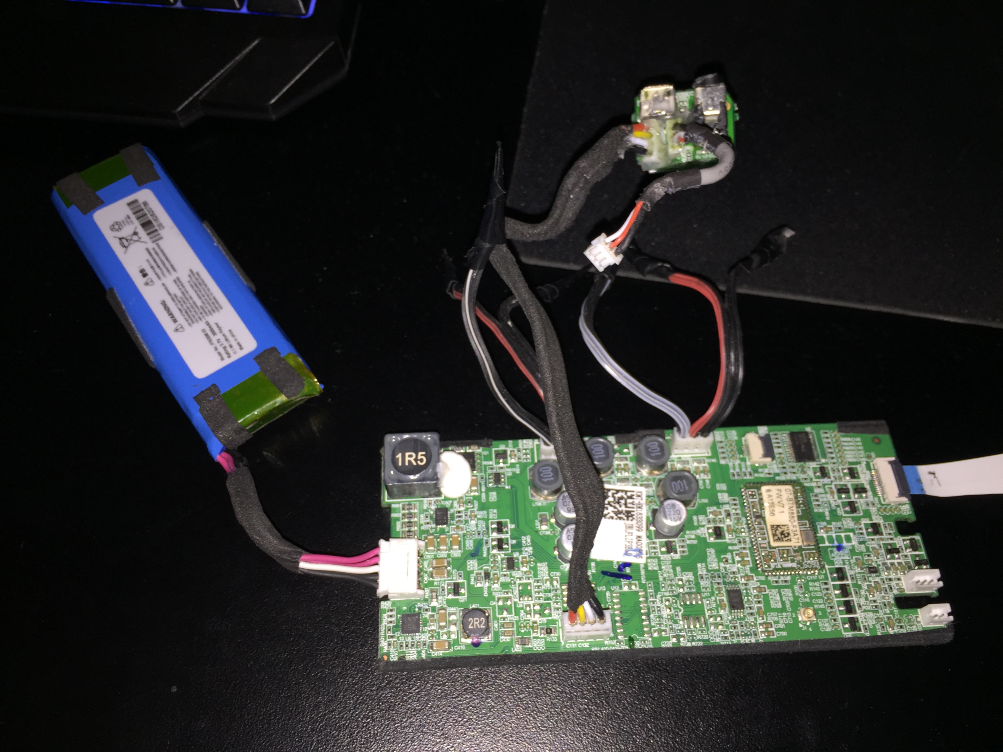

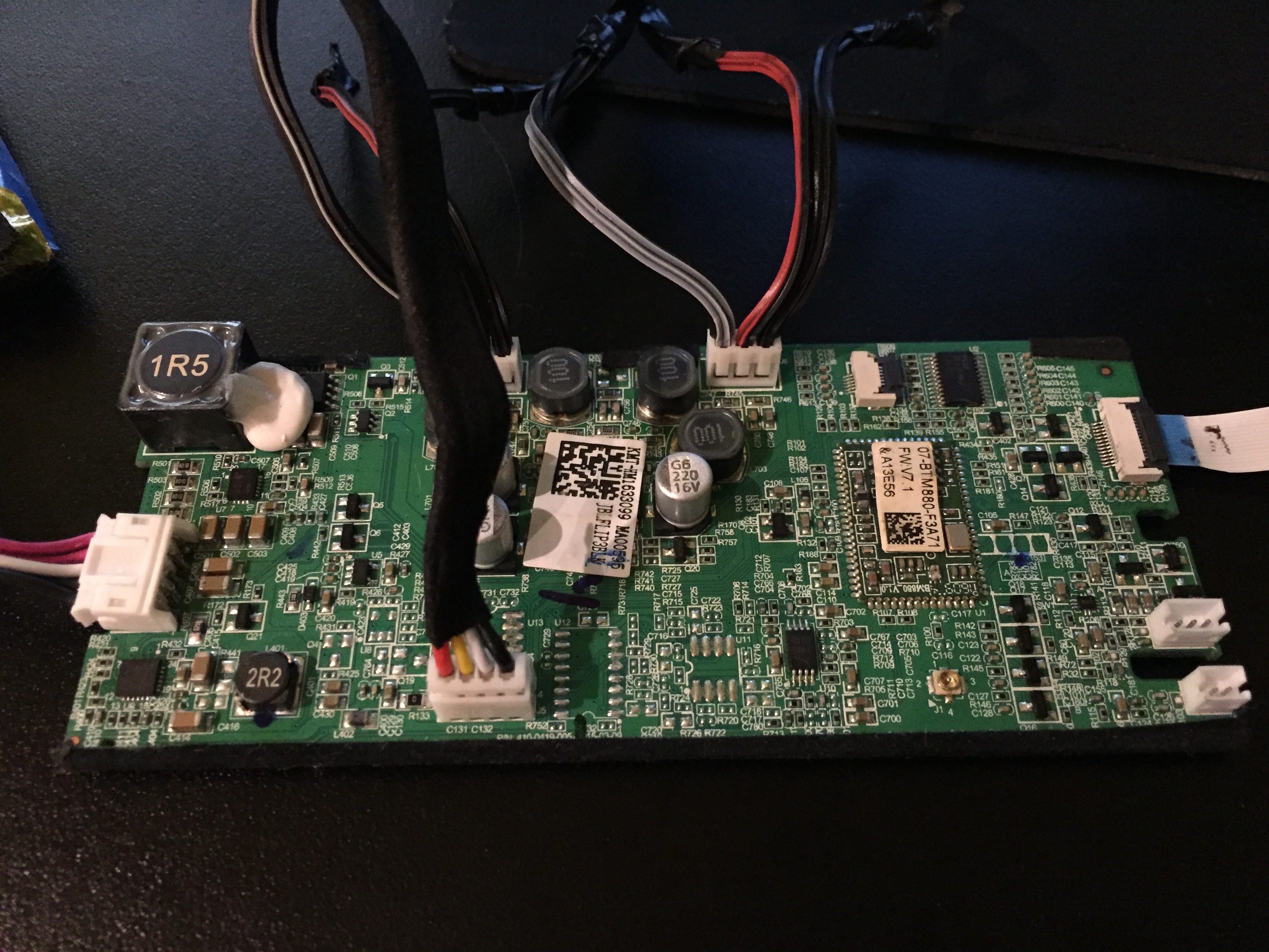

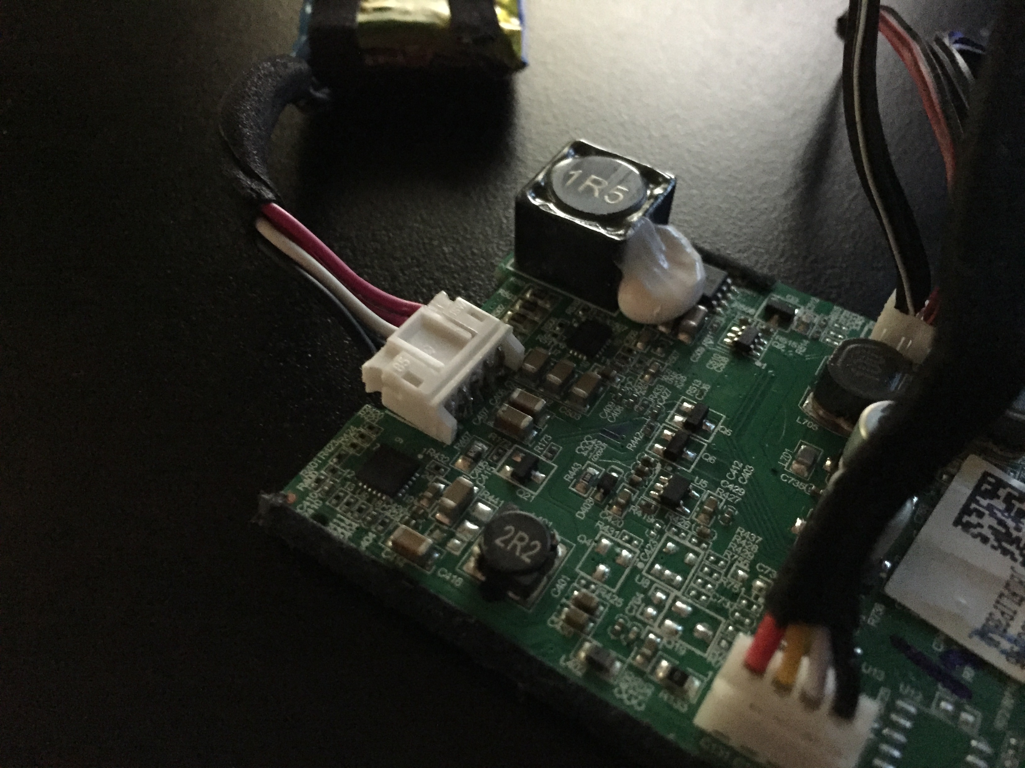

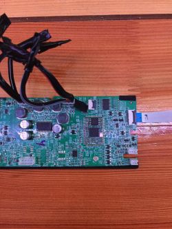

    I bought a jbl flip 3 speaker that would not turn on.
    Initially, I thought that the problem was with the battery or the micro usb socket, but both of these parts turned out to be working.

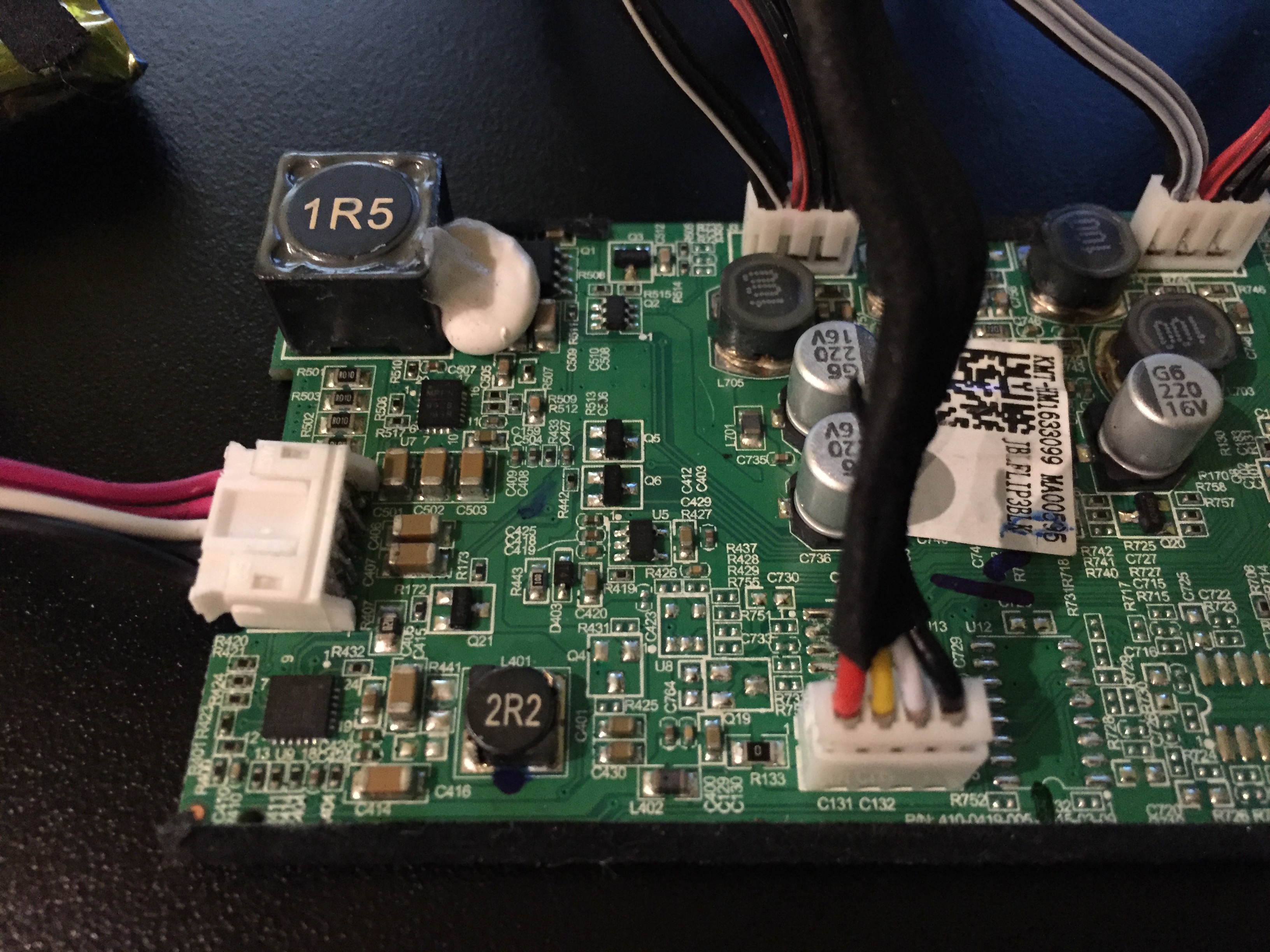

    In the loudspeaker you can see that someone has been transferring the battery connector.
    Holding the power switch for 30 seconds does not give anything, nor does connecting the charger.
    When you click the power button, the lights around it will only flash and that's it.
    Below are the voltage measurements.
    On the power switch before switching on 4.05 v, after pressing 0 v.
    The battery is 4.17v - regardless of the button combination, the voltage does not drop.
    Tensions on the board:
    vcc to gnd 3.283 v
    csb to gnd 3.278 v
    miso, clk, mos 0v
    vcc for mos, clk, miso 3.118 v
    All these voltages are available after pressing the power button, without pressing the voltages.
    I am asking for help in finding the fault and where to look for it, best regards.
    Photos in the attachment because normally would not stick.

    • JBL Flip 3 - Won't turn on or charge, no response please help. IMG_3318.JPG (1.6 MB) You must be logged in to download this attachment.
    • JBL Flip 3 - Won't turn on or charge, no response please help. IMG_3323.JPG (1.27 MB) You must be logged in to download this attachment.
    • JBL Flip 3 - Won't turn on or charge, no response please help. IMG_3315.JPG (1.78 MB) You must be logged in to download this attachment.
    • JBL Flip 3 - Won't turn on or charge, no response please help. IMG_3317.JPG (1.58 MB) You must be logged in to download this attachment.
    • JBL Flip 3 - Won't turn on or charge, no response please help. IMG_3316.JPG (1.33 MB) You must be logged in to download this attachment.

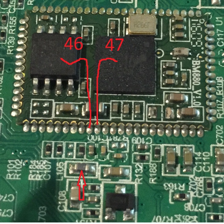

    In addition, I found one, probably a capacitor, missing on the U1 board. It may be preventing you from turning on.
    Give its designation from the diagram, because from this photo it is impossible to determine which capacitor it is.

    Unfortunately, as for the capacitor on the board, there are no markings in the diagram, only the entire U1 circuit is marked
    Which pin U1 is this capacitor connected to?

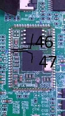

    The broken capacitor on U1 is connected with one pad to pin 46 and 47 and the other goes to the bga circuit.
    According to the diagram, it does not connect to pin 46, but to pin 47 C107 100nF.

    Rate: 145
    After applying the meter to the capacitor pad, it squeaks at pins 46 and 47 U1
    I don't know if it should be connected or not, no board drawing, give me a picture.

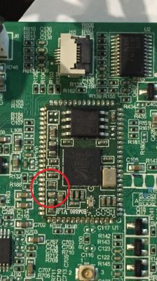

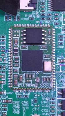

    JBL Flip 3 - Won't turn on or charge, no response please help. JBL Flip 3 - Won't turn on or charge, no response please help. JBL Flip 3 - Won't turn on or charge, no response please help.

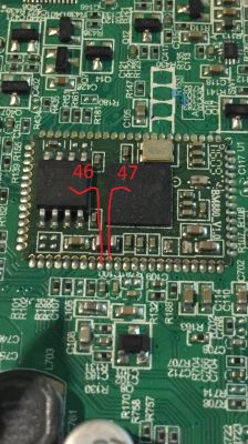

    Maybe mark these points.

    JBL Flip 3 - Won't turn on or charge, no response please help. [img-0]JBL Flip 3 - Won't turn on or charge, no response please help.

    This capacitor on pin 46 is not to be and is not there, and it is on pin 47, which is good.
    I don't know how you measured it, but if there is a short circuit between pin 46 and 47, the system is damaged.

    https://pl.aliexpress.com/item/BTA-RX-SPDIF-C...eceive-module-module-aptx-ll/32817066513.html
    this broken "capacitor" is actually a coil on the power line of the CSR8670 chip
    If there is no short to ground on both pads of this coil, it is enough to make a jumper in this place If there is a short circuit on one of these pads, the module should be replaced
    edit
    pins 46 and 47 are connected to each other via r185 having a value of 0 ohms
    there should be 1.8V to ground

    Thank you very much to Mr. Qudlatyy for your help.
    After making the bridge, the loudspeaker turns on at this point! :D
    There is only one little problem. The loudspeaker only works when I hold power, it turns off immediately after releasing it.
    So the diagram has nothing to do with what is on the board.
    L105 is the black element that connects to the jumper you soldered and there was probably a jumper (zero resistance) there, which is the power circuit.

    3.3V power flows through the L105 to pin 45 and 48. On pin 47 there is 1.8V coming from the U1 chip, which through the R185 resistor goes to the leg 46 It is used to power the memory MX25U3235

Why won’t my JBL Flip 3 turn on even though the battery is 4.2 V?
An open L105 inductor breaks the 3.3 V rail, so the MCU never wakes. The LED ring may flash, but voltage on pin 5 of U5 stays 0 V after the button is released [Elektroda, kacperos9371, post #17230126] Re-establishing the rail restores normal power-up.
How do I confirm that L105 is the culprit?
Measure resistance across its pads with power removed. You should read <0.5 Ω. OL means the choke is open. Next, probe for 3.3 V on pin 45 of the CSR8670 while holding Power. No voltage confirms rail loss [Elektroda, Qudlatyy, post #17230090]
Can I replace the missing “capacitor” near pins 45-48 with a wire?
Yes. The part is actually L105, a ferrite bead. If no short exists to ground, bridge the pads with a small tinned wire. This fix revived the unit in the thread [Elektroda, kacperos9371, post #17228173]
The speaker works only while I hold Power—why?
The hold-line fails to latch because Q5 never sees 0 V on pin 1. Usually R434 or the ribbon with the Vol +/– keys is disconnected, so VCC_switch_3V3 collapses after you release the button [Elektroda, Qudlatyy, post #17230220]
Which voltages should appear on U5 pin 5?
Expect 3.3 V with the button pressed and after latch. 0 V when off. The thread measured 3.3 V pressed, 0 V released, confirming latch failure [Elektroda, kacperos9371, post #17230126]
What part should I use for L105?
Any 0 Ω 0603 jumper or 100 nH ferrite rated ≥1 A fits. JBL’s original part drops <40 mΩ. Cost averages €0.35 [Mouser, 2024].
