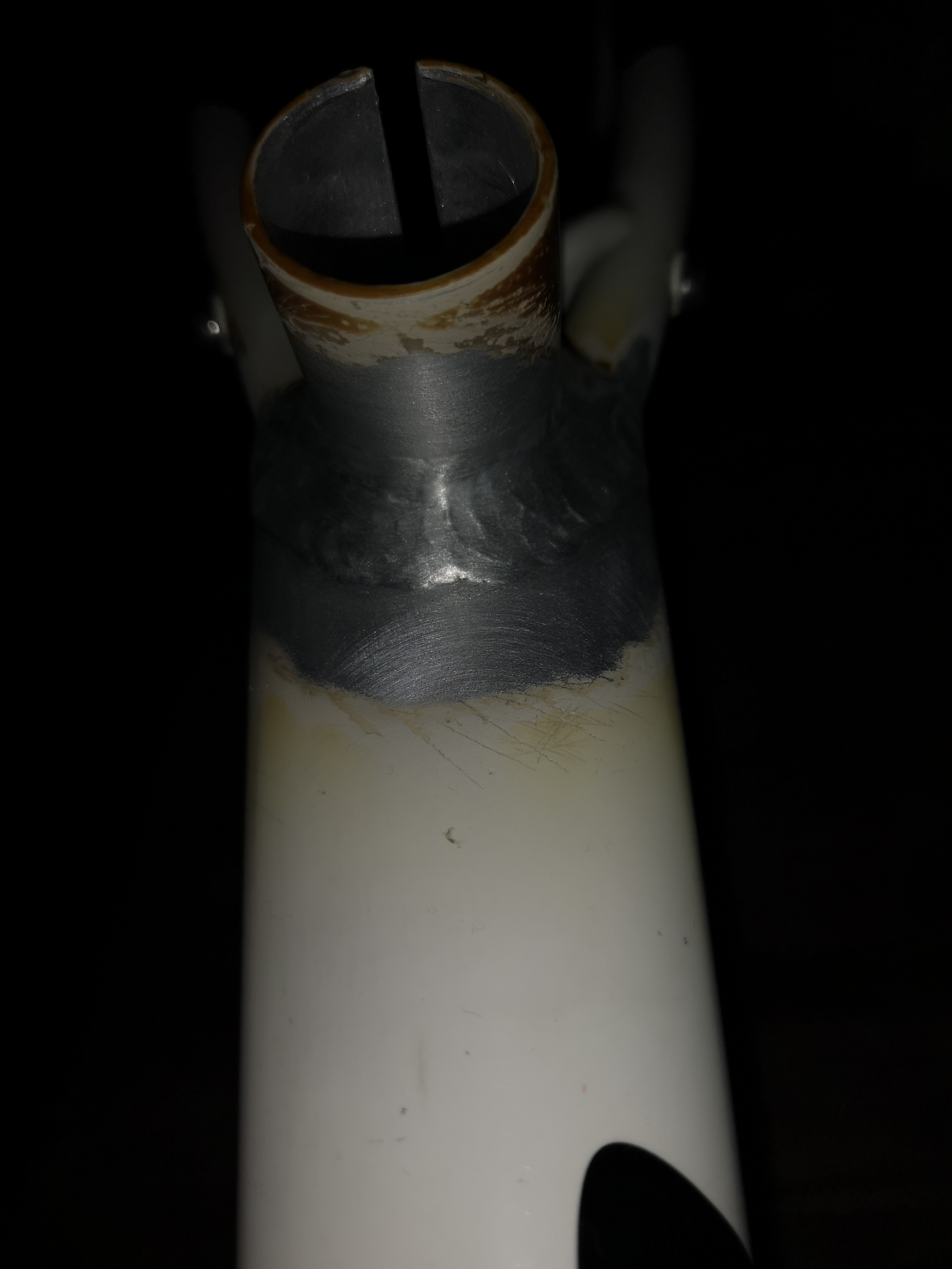

    telecaster1951 wrote:
    phanick wrote:
    I wonder how these 100-120 kg cyclists ride like in my case at 65 kg, such miracles happen ;)
    This frame has manufacturing defects. Cracks at the weld seam, which means that either the material was wrong or the weld was defective.
    Ergo comrade moderator totally untrue. The weld would be defective if it burst itself - the face of the weld. And it breaks on the border - correct. The frame is working, it is under stress - so the material gets tired, but it is not particularly resistant to the load. So it turns out that the frame is worn - it was not designed for such a big "jockey" and extreme use. Something for something - the lightness of the thin-walled structure itself, at the expense of mechanical strength. Instead of messing around with welding and investigating what went wrong after that, I'd just replace it, and that's it.

    I agree with you, but there is one "but". The bicycle frame, when properly used, should not break at the edge of the weld. Little. It has no right to break. If it is a MTB bike, and it looks like it and it is not a Tesco frame for PLN 50, metal cannot be released in this place. The weakest part of the frame is the rear triangle.
    Cracking at the edge of the weld may indicate a bad weld. With an incorrectly selected temperature, a microcrack appears at the edge of the weld. Slightly small, often hidden under the varnish. Over time, the crack will continue to develop until it finally shows up. In the robot, I have seen a vacuum armature more than once, bursting in exactly the same way. Except in this case, a microcrack means that the element ends up in the basket.
    I conclude that he never had a welding colleague from the practical side. At the weld / parent material interface, apart from the stresses caused by shrinkage of the cooling weld metal, there is always a narrowing of the material - caused by its drawing to the weld. Hence, it always breaks in this place - add fatigue changes to it.
    If my aunt had a mustache, she would be an uncle. It will break sooner at the weld boundary, where the structure of the material is changed, than where the material is in the "factory" condition. Nothing is forever - the frame tubes are squeezed, stretched, bent - it's not a 100% rigid structure.
    From my own experience as a welding technologist, I can say that what my colleague writes cannot appear in a properly made welded joint. The narrowing the colleague mentions is called an undercut and it is unacceptable.
    This border is the heat-affected zone. Cracks are also not allowed at this point.
    The only crack that can be considered not due to welding errors is a crack outside the heat affected zone.
    Surface welding imperfections in joints
    welded from metals by MSc Eng. J. Czuchryj and the relevant standards describe it exactly (this is exactly the PN-EN ISO 5817 standard).
    The reason for the formation of these cracks, I could initially assume, was the non-compliance with the welding technology of this material (such an assumption). When too much linear energy is introduced in place of welding, cracks occur. Aluminum, or rather its alloys, are very sensitive to this value. But what has been "fixed" is a tragedy. The question remains whether the person performing the repair used the appropriate binder. As I know life, it is often like this: aluminum is aluminum wire, which alloy is not important anymore.
    I am not a welding technologist there, but I did some welding in my life, I saw some welds and cracks in the welds themselves or in their vicinity. If the influence of arc welding on the structure of the material could be avoided, electron welding, soldering in some cases or braze welding would not be invented. But this is only my opinion, so the PhD thesis on the frame can be continued.

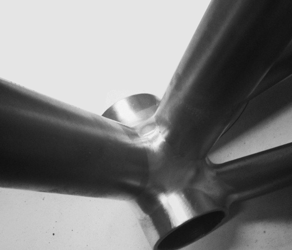

    Today I had an 'interesting discovery' - the bike at the beginning of the day started to sizzle strangely when you stepped on the pedals. Initially, only when you were sitting on the saddle, and then even standing. And here is the culprit:
    Welding 6061 Aluminum Bike Frame with Crack: Expert Advice, Costs & Alternative Solutions Welding 6061 Aluminum Bike Frame with Crack: Expert Advice, Costs & Alternative Solutions Welding 6061 Aluminum Bike Frame with Crack: Expert Advice, Costs & Alternative Solutions Welding 6061 Aluminum Bike Frame with Crack: Expert Advice, Costs & Alternative Solutions Welding 6061 Aluminum Bike Frame with Crack: Expert Advice, Costs & Alternative Solutions
    Since the thickest tube in the bike breaks, and in the most important triangle, in each of the three possible angles, it means that the frame has actually worn out ;)
    A crack in this place and in this pipe, in my opinion, proves very bad of the quality of the frame.

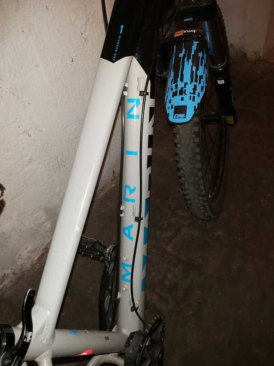

  • Axle impact likely caused crack at narrowest point

    The place of the crack is interesting because usually the frames break on the existing weld or in its vicinity. Here it broke at the narrowest point. I suspect the quick release was not tightened and during a stronger impact (e.g. jumping off / jumping on the curb), the axle hit the frame and it damaged it.
    You can weld, a friend of mine welded two aluminum frames and nothing happened to them, but it was not as critical a place as in the photo above. You can probably forget about heating the welded frame in order to eliminate stresses, first that the whole varnish will go to hell, and two that who has such a big oven?

    If you "did" at least one "stiff" driveway and then drove down 100 km / h down the hill, then you would find out how much the broken frames are worth, how long the "grinds" are and how scabs itch hehe.
