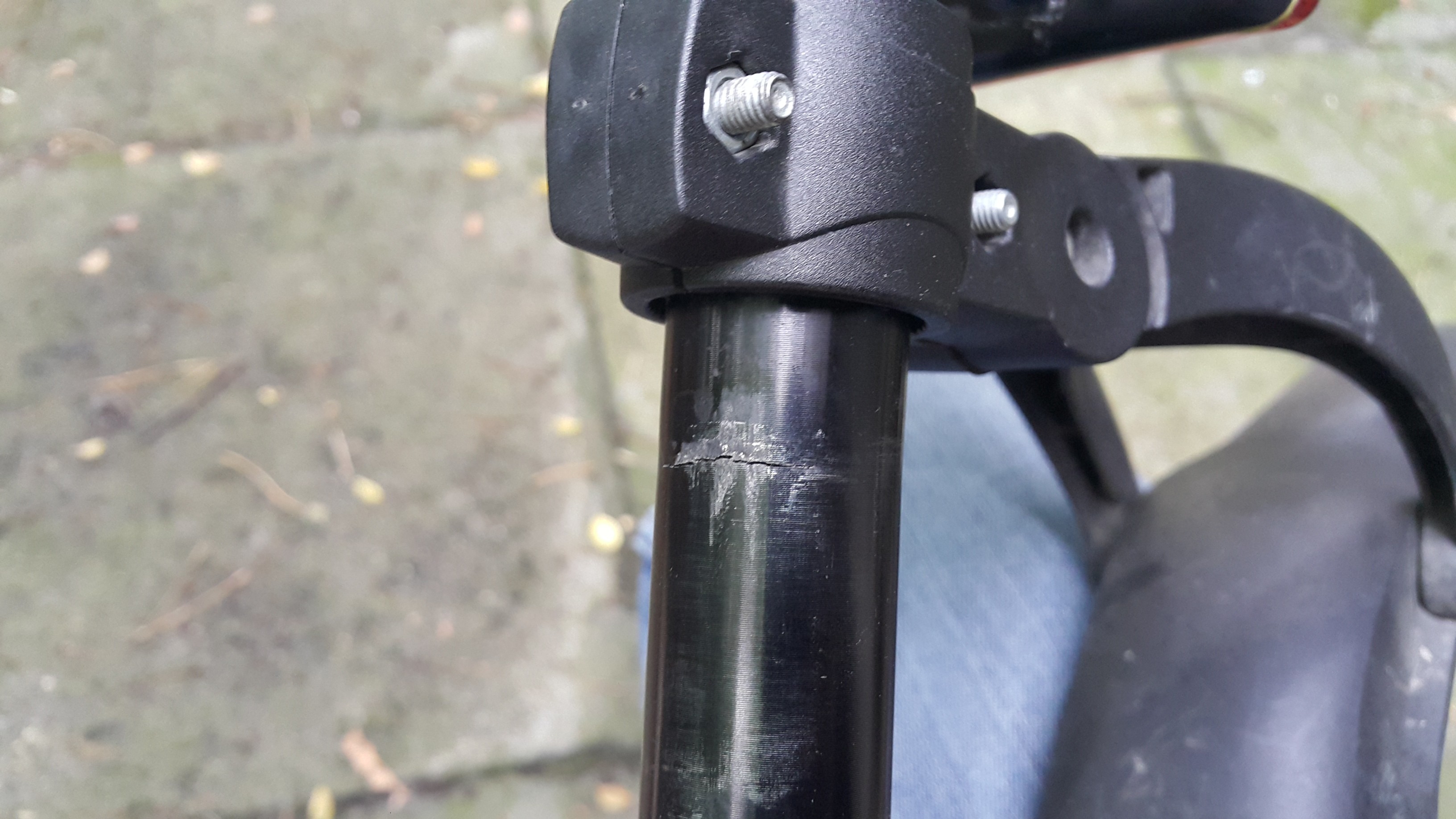

    Some time ago I noticed that my bicycle frame (aluminum, alloy 6061) has a clear crack in the vertical part, almost in the middle of the joint.
    Welding 6061 Aluminum Bike Frame with Crack: Expert Advice, Costs & Alternative Solutions Welding 6061 Aluminum Bike Frame with Crack: Expert Advice, Costs & Alternative Solutions Welding 6061 Aluminum Bike Frame with Crack: Expert Advice, Costs & Alternative Solutions Welding 6061 Aluminum Bike Frame with Crack: Expert Advice, Costs & Alternative Solutions
    On the bicycle forum, they advised me that the frame to be thrown away to buy a new one (the cheapest costs, already fairly decent, are about PLN 400-500).
    Many people broke somewhere on the seat mounting - I understand there, there can be a large moment of force, but here it is more of a compressive than a tensile force.
    In addition, none of the new frames was fully satisfactory for me (bad painting, hooks for mounting lines above the frame, and I prefer it under), which seemed the most reasonable solution when trying to weld for up to PLN 100.
    I gave up for welding, I have already traveled a bit in especially difficult conditions and the crack does not seem to come out from under the weld, hence the question, has it been welded well? I gave 70 PLN for welding. I am a bit dissatisfied with this sanding over the weld (they probably sanded a millimeter of the pipe, instead of just removing the varnish) and in general, they did not handle the bike too delicately (paint splinters in several places).

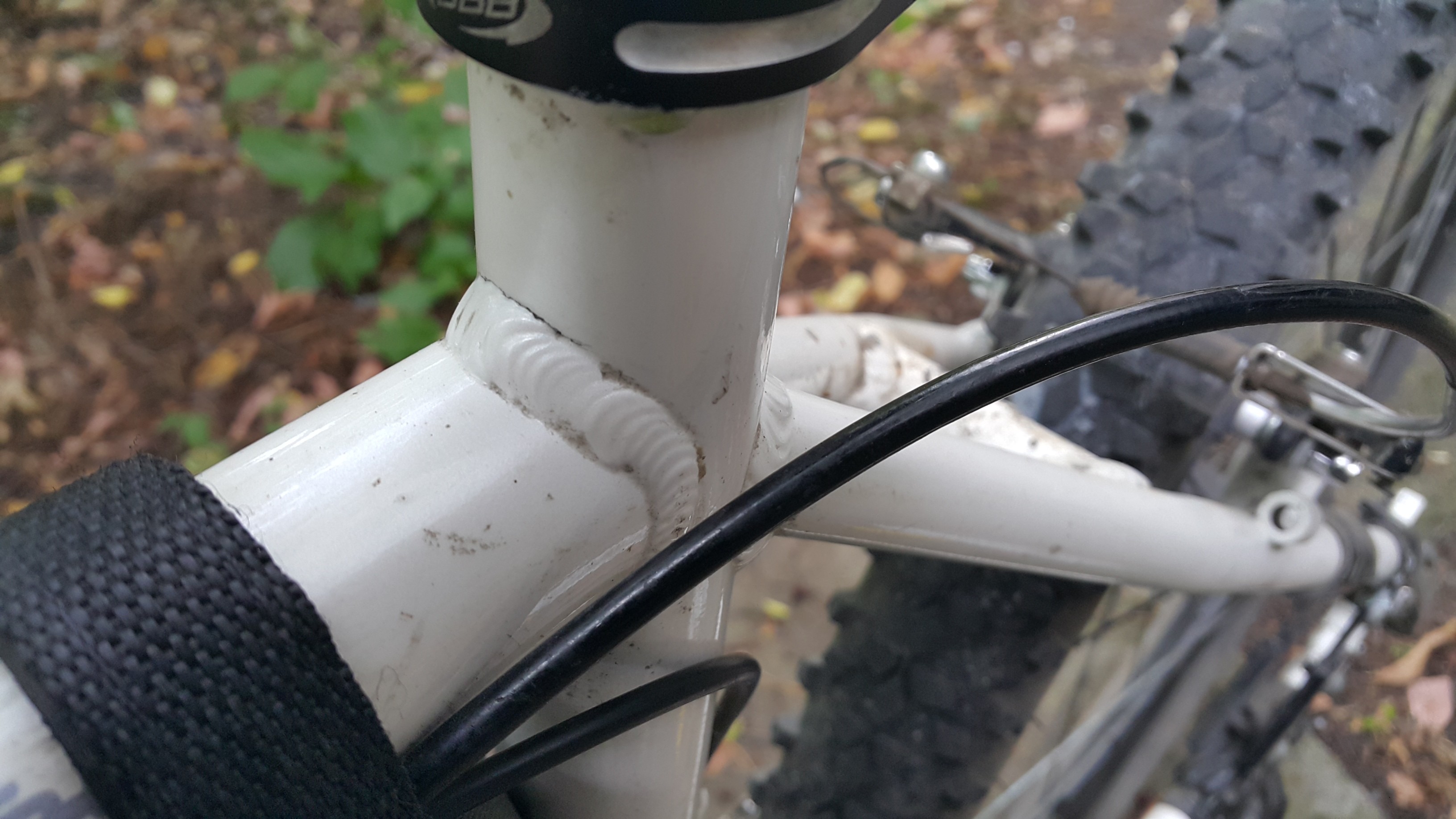

    I would not even pay a zloty for such welding. I am afraid that after a month of use it will crack in a different place (just above the weld).

    It is pissed up, not shit up. If it was a real tig welding specialist, it would be completely different.
    Samuraj wrote:
    I'm afraid that after a month of use it will crack in a different place (just above the weld)
    Don't be so forward. Why should it break just above the weld? The welds themselves are extremely unsightly. I have a suspicion that someone smacked with the electrode.

    He flew in a jiffy. In fact, he was a snot. Well, for 70 zeta ... You would have to sandblast the place, wash it, cut the joint with a dremel and pour it nicely with a tig. I don't know if I would like to for 200. But now it's mustard after dinner, sprinkle some spray and ride it until it crashes.

    Well, for 70 zeta ... it would have to be sandblasted, washed, cut with a dremel for the joint and poured nicely with a tig. I don't know if I would like to for 200.
    Exactly the alu must be clean to weld, with the varnish welding is almost edge-to-edge.
    You had to pull the stitches upwards to make them stronger.

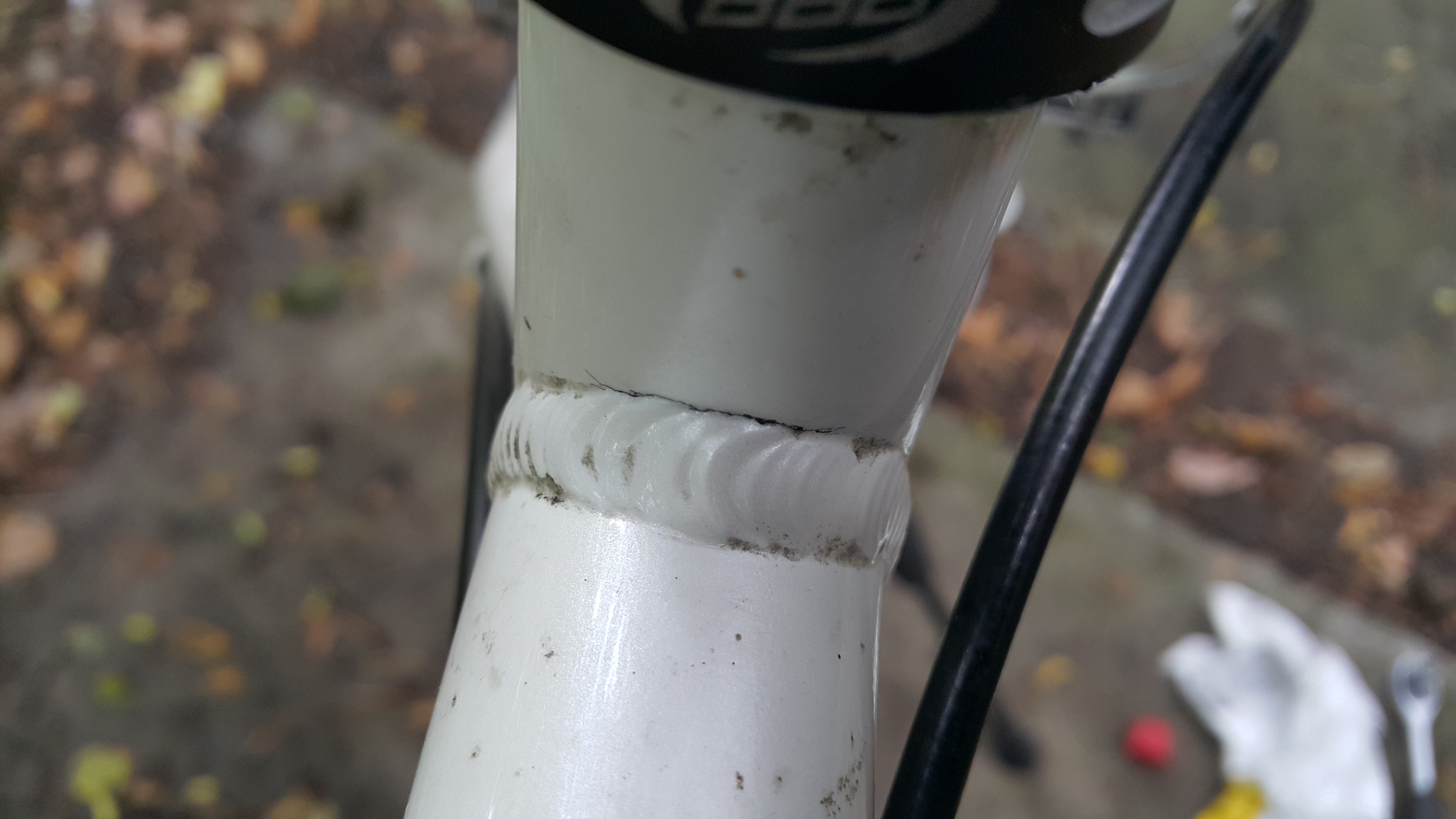

    So you worried me, I commissioned the welding company dobry-spaw.pl, they had 150 positive opinions (and no negative ones), and here is such a flower.
    As for the price, is PLN 200 for something like that? I wonder what hour you have then.
    And how much would it cost you to weld the entire frame from scratch ;)
    I understand that the responsibilities include removing the varnish, degreasing, preparing the place for welding, but I am supposed to do it? This is probably the welder's duty. When I go to the hairdresser, should I also wet my hair myself and come wearing an apron?

    It looks like an apprentice is welding it, not a professional. Slagged glutes poured on, not properly melted into the material.
    phanick wrote:
    As for the price, is PLN 200 for something like that? I wonder what your hourly time is then.
    Welding this tig takes about an hour of work - grinding old welds, chamfering cracks, sandblasting paint and dirt, welding only. It goes very slowly in regret - believe it.

    Honestly? I would not get on such a snotty frame. In the hole you will crack and you will lose your teeth.
    Take this crap to the company that welded and get the work done and the frame broken.
    These are the things that technical school students do in their first class.

    I have never seen a worse form of welding than here. I don't believe someone did it sober.

    For this it is boiled, because the bearing in the bottom bracket has not been removed before welding ...

    My first welds in MIG steel looked better on an uncleaned surface ... I think these opinions were paid, some kind of massacre. I would go there for a refund for lost time and a damaged frame.

    But it wasn't even disassembled for welding! You can see the molten grease from the bearing. Tosz, you need to remove all the equipment, sandblast it from the paint, as colleagues wrote, make a wedge into the old weld so that it floods inside. It doesn't last an hour, but it doesn't cost PLN 100.
    Here, a welder, when he used to weld in aluminum, put details into a pool of water and they protruded 1 cm above the water and welded there for better cooling. I don't know much about welding there, but it gives you an idea of what aspects you should pay attention to.

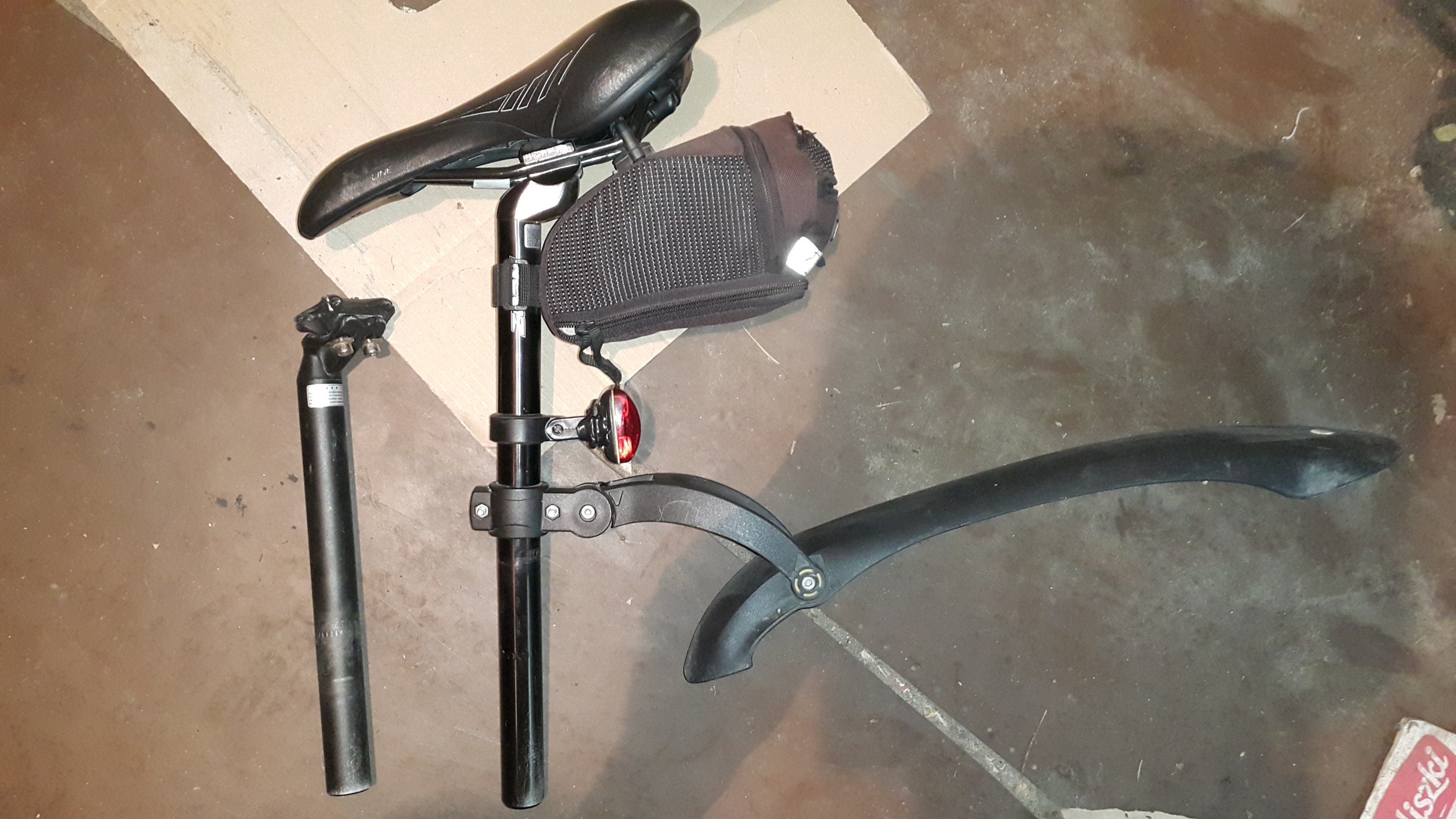

    The entire welding frame was disassembled by me practically to zero (removed support, i.e. bearings and bowls), derailleurs, wheels, saddle. I only left the shock absorber at the front with the handlebars, so access to the welded area was perfect.
    So far, the frame is holding somehow after another quite demanding rides, the crack does not seem to come out, nothing creaks. What I would stick to at the beginning is that in one place (at the back of the seat tube) they should weld 1 centimeter away, because not the whole crack was covered with a weld.

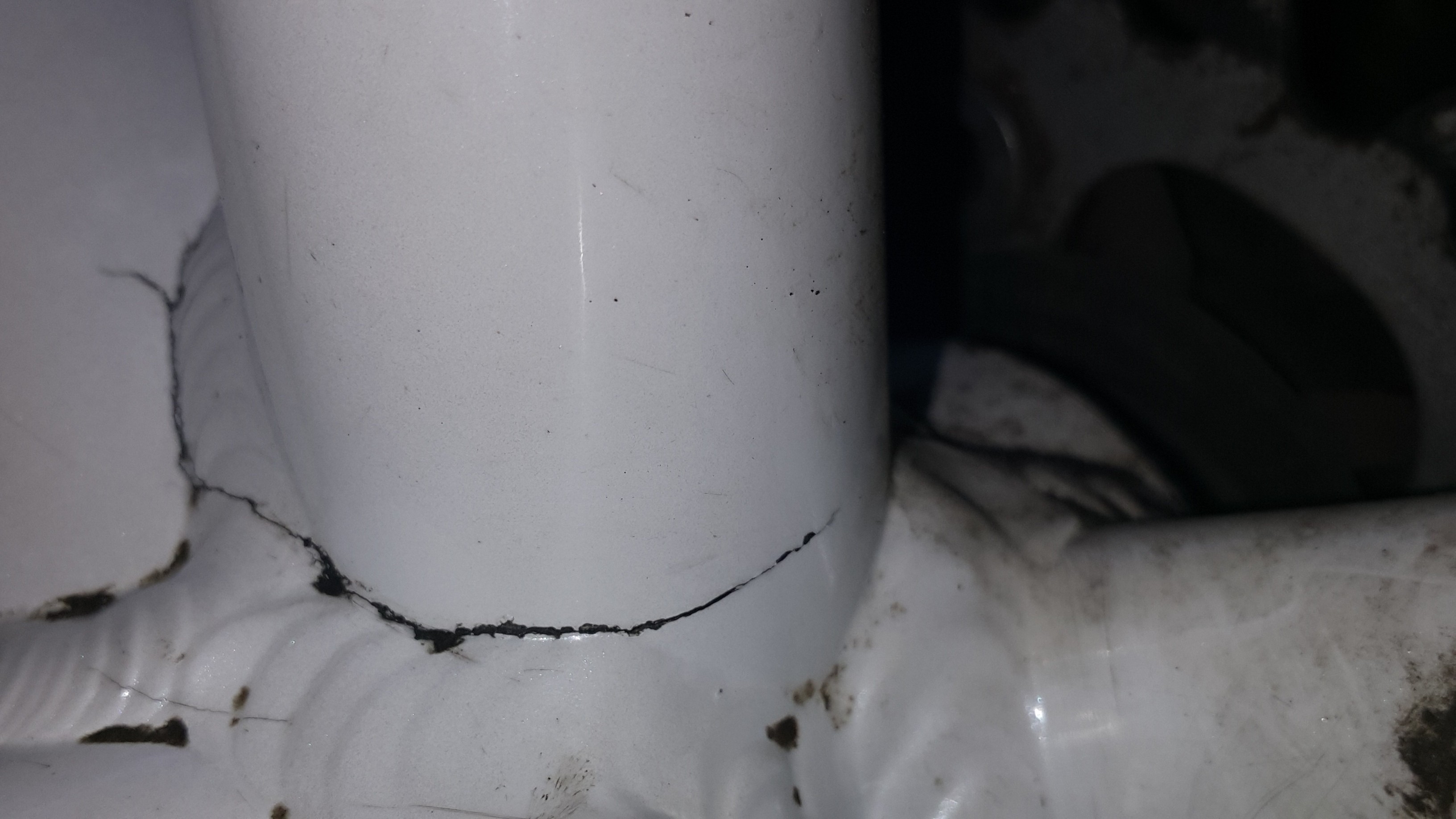

    I must be unlucky because I noticed a second crack in a completely different place. In addition, the bicycle seatpost is also damaged in a strange way (I bought a longer one to make it fit into the frame at the right depth). I wonder how these 100-120 kg cyclists ride like in my case at 65 kg, such miracles happen ;)

    You have a low-quality frame and that's it. Maybe it has a lot of stickers and in papers, space technologies and aluminum alloys, but in fact it is probably not the case.
    Or you torture the bike extraordinarily and the frame is not meant for it. Basically, aluminum is stiff and prone to cracking like this. Do you have a stiff fork or a suspension fork?
    I use a steel frame, now it is about 15-18 years old. I weigh 90 kg.

    This frame has manufacturing defects. Cracks at the weld seam, which means that either the material was wrong or the weld was defective. Ergo frame for scrap metal.
