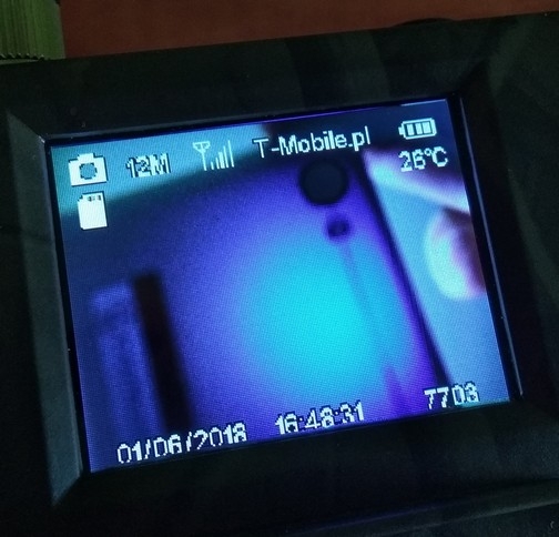

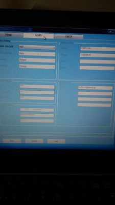

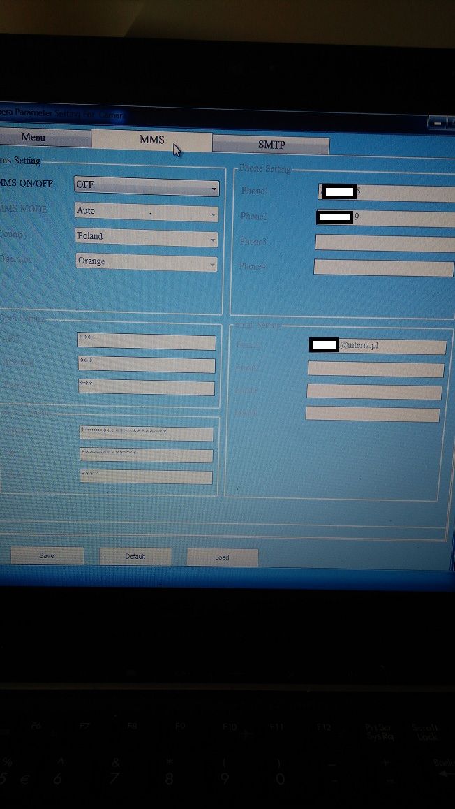

    I bought a photo-trap HC-300M straight from China.
    Unfortunately, I can not configure her to send photos to an email.
    I was browsing the youtube and setting it up
    Setting Up HC-300M Photo-Trap to Email Photos: Configuration Issues and Fixes
    unfortunately, the photos are not sent. I noticed that the T-mobile screen is instead of the Playa logo
    so just in case I change in the program on t-mobile but also without effect.
    I'm running everything in hand because in the program provided there is no one to choose between Poland and the operator.
    Has someone like this webcam or has an idea of what to set up.
    #2 17252694
    piterek-23
    Posts: 3321
    Help: 162
    Rate: 427

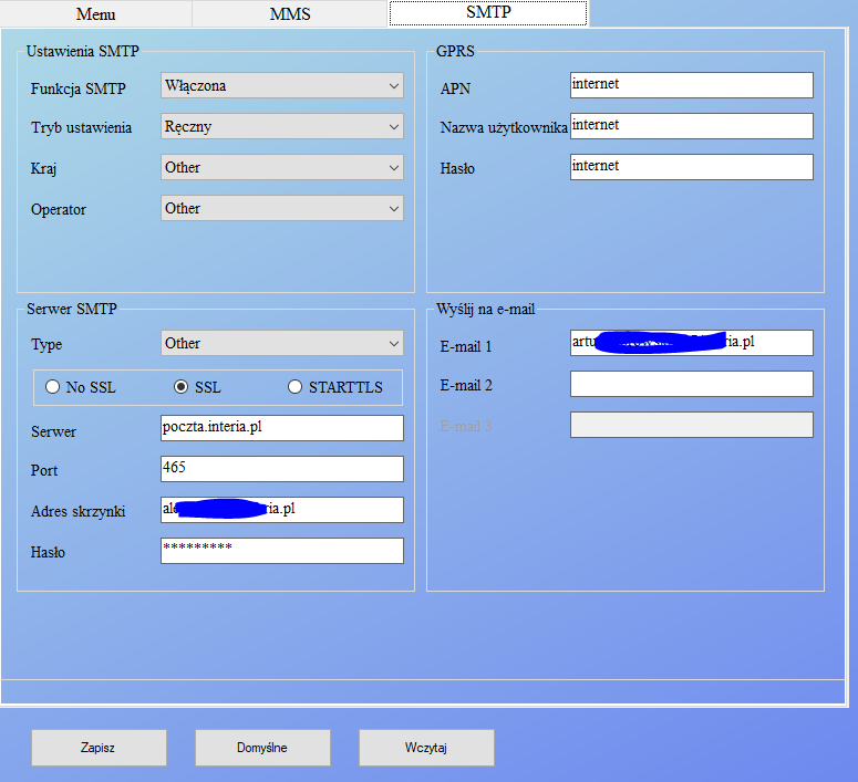

    HERE it is written that APN for Play is "internet", not how you have entered "www.play.pl"
  • #3 17253219
    brumik
    Posts: 87
    Rate: 27
    It was a shot in 10. It came in to enter the internet and it works. Thank you. greetings

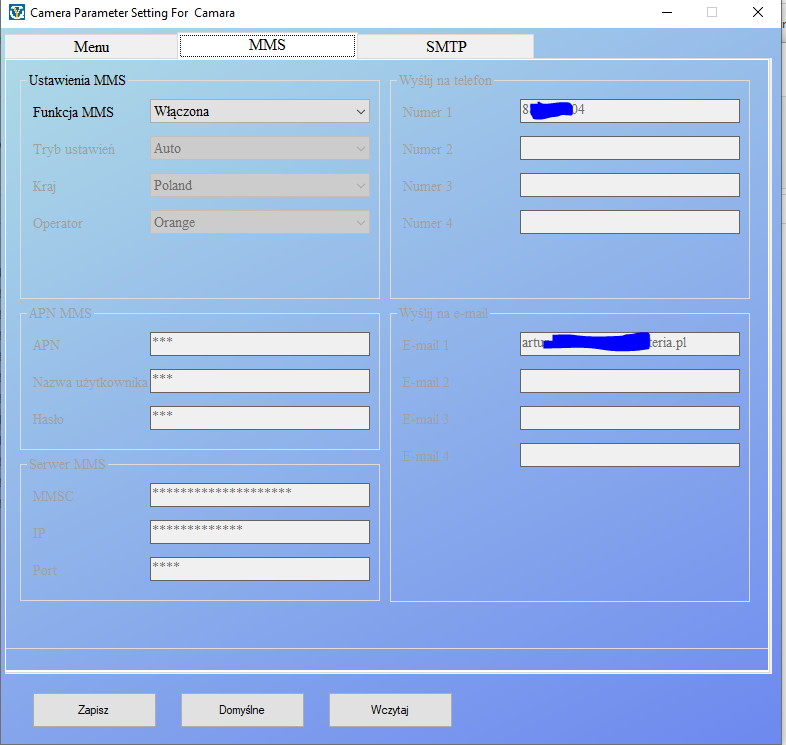

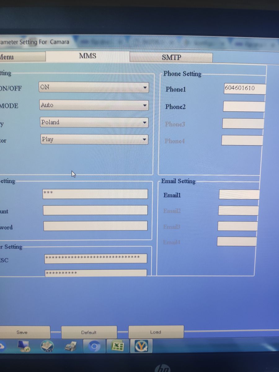

    labisp wrote:
    What mms parameters to enter for sending photos network play.
    Good morning,
    and I read all of you passionately, but I can not cope with it, in the Orange card I entered what it was supposed to be, it does not send photos, but now I have a PLAY starter, it does not send the same and an antenna appears for this, but there is no operator logo . any chance of help
    I will add that it is 300M
    and does not respond to sent commands
    no answer.
    the card has sent mms normally from the phone to the phone,
    is topped up with the amount of PLN 35
    Added after 10 [minutes]:
    I will add with the Orange card, after connecting the trap, mms logs appeared with error 3916 and 3961
    now there's not even a log folder on the PLAY tab.
    the card has a pin that I was able to turn off on the hulk p10lite phone. the phone does not ask for the card pin, I do not know if it is removed from the card, or maybe just the phone does not require ...
  • #12 19136729
    gradek83
    Posts: 9107
    Help: 930
    Rate: 2103
    Add the number without +48
    And such settings. No AUTO, just type it manually.

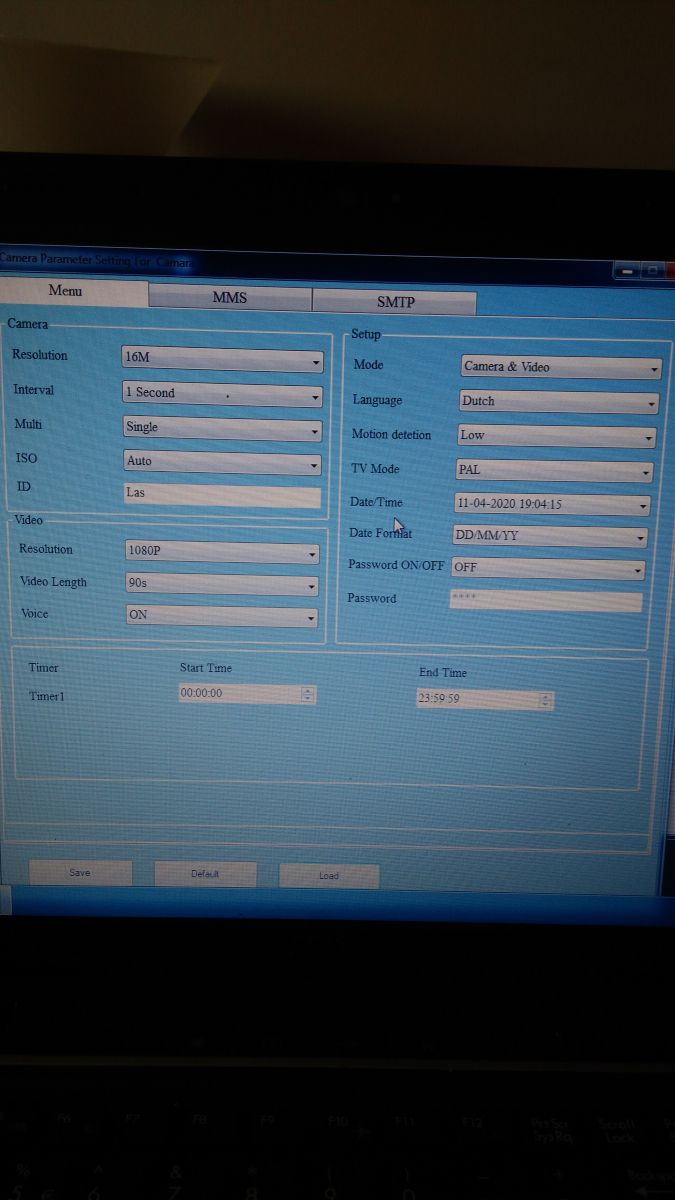

    Hello gentlemen.
    I have a problem with my forest webcam.
    Previously, it worked ok in nju mobile.
    I changed my number to PLAY and the problems started.
    The settings are shown below. The webcam does not send me photos on email and no contact with SMS commands. Would someone help me configure it?
    I changed the sim card in the phone settings to 2G it works, but it does not record videos on a 32GB SD card (because it cannot be larger) what is the reason?

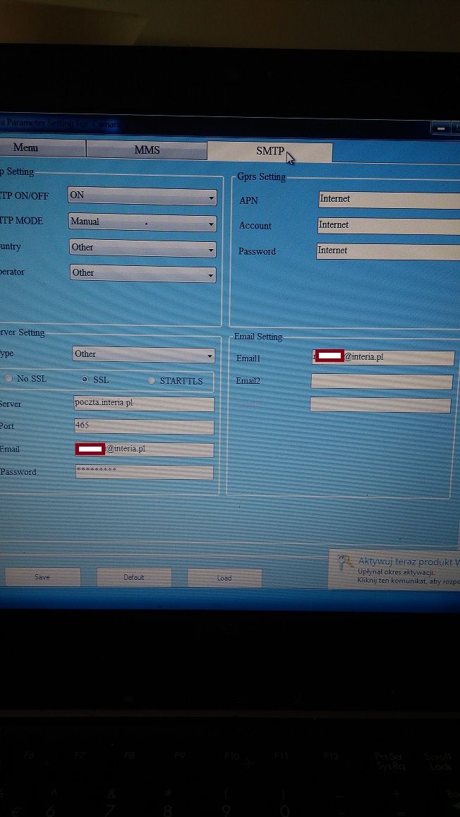

    My point is that the webcam only send me a photo by e-mail, I don't want mms. My software is from 2019. I am looking for the MMSCONFIG program where it is possible to choose a 16MP camera. Suntek hc-300m. Does he enter his password to meil in the Server Settings tab in the passowrd window? Is a special type character! disturb ?
    Added after 3 [minutes]:
    Hello. I want the webcam to send me photos on email. Unfortunately, it does not even respond to SMS commands. Play card. How to approach it? Is a special character in the password field of type! maybe it interferes with sending an email?
    How to set up SMTP? my mail is interia.pl and the sim card is in PLAY
    Enter the email address in the MMS tab. It depends on your e-mail whether it arrives from the MMS Email gateway. I got photos by e-mail on o2.pl. These FPs do not have that many MP, max 3MP, those 16MP are the interpolated resolution, I recommend that you always choose the smallest of the available ones.
    Yes
    no

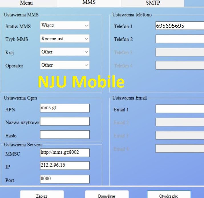

    Does anyone have mmsconfig for the hc-300m webcam with the 16mp camera function? Nothing works for me on the webcam, only sms commands. I think I need an old version of the software that I got for the kit. Unfortunately, I missed the CD with the packaging somewhere. I changed operators and then threads. MMSCONFIG downloaded from websites

    Works for NJU MOBILE
    MMS and network configuration interface for NJU Mobile with settings fields and a phone number.

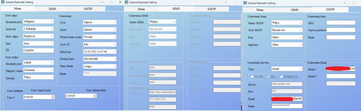

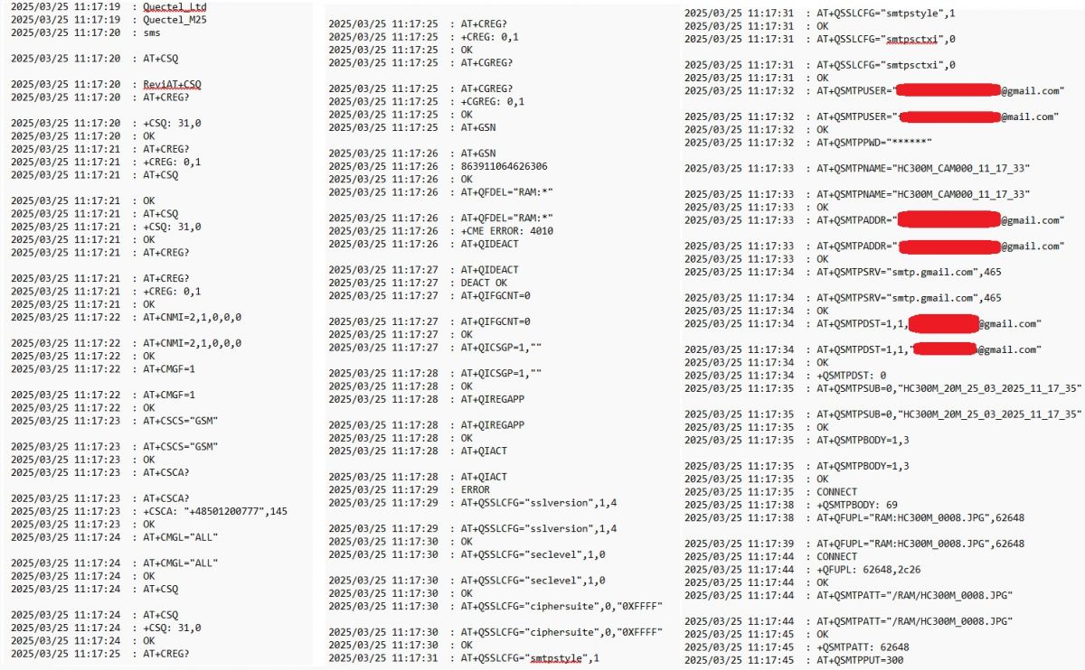

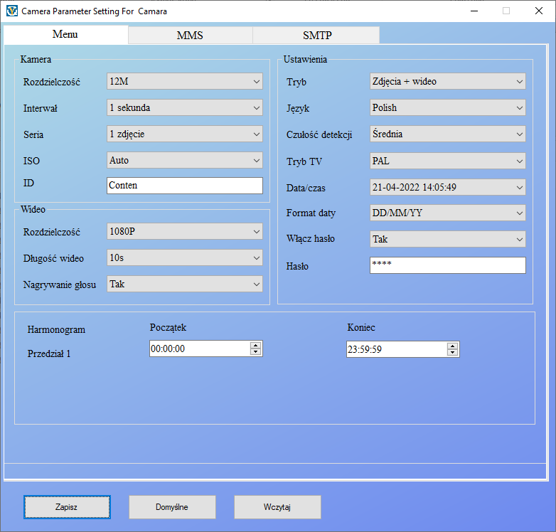

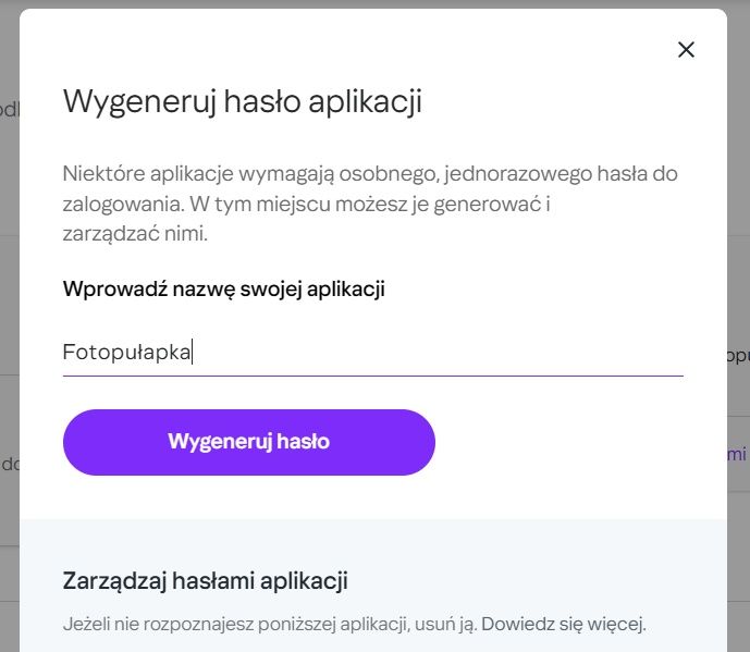

    #27 21494450
    czumi
    Hi.
    I've been struggling with my camcorder for a few days now.
    I am very much asking for a CONFIGURATION to see if such should work.
    OR
    IDEAS WHAT ELSE I CAN CHANGE AND CHECK
    I can see that the pictures are taking. But it has some problem with sending pictures.
    SIM card : NJUMobile (internet only)
    Memory card : 16GB
    Camera software : 20230426-223A
    MMS settings : disabled
    Mail : I set up a new one on gmail and checked it
    Server : smtp.gmail.com
    Port : 465
    SMTP settings : On, Manual.
    GPRS settings : Empty
    SMTP settings : as in the picture below
    Adds images from ERR_LOG.txt file
    I tried :
    1) A different port - 587 - doesn't work
    2) After attaching the camcorder I pressed Default Settings (one of the Youtube videos) advised. - does not work
    Greetings,
    Thomas.
    Screenshot of camera configuration settings in three panels. .
    ERR_LOG.txt file showing configuration data and logs of a camera with email sending issues. .
  • Use APN Internet with Yahoo app passwords

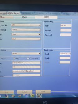

    #28 21494515
    gradek83
    Posts: 9107
    Help: 930
    Rate: 2103
    APN: Internet
    user name: Internet
    password: Internet
    By the way:
    Spoiler:
    Using more secure applications.
    If an application uses a lower security login technology, it may not be possible to use it with your Google account.
    If an app that only uses a username or password tries to access your Google account, you will get an error. Potential errors:
    "Invalid username",
    "Invalid password",
    "Unable to sign in".
    You can sign in to your Google account from any third-party app, as long as there is a "Sign in with Google" option. In some cases, you will need to delete your Google account and add it again on your device.
    Source .
    So it can be a bit difficult or impossible having a regular google account. Which is different if you have a :Google Workspace or Cloud Identity account.
    INFO .
    As an MMS it can at most work.
    If you want, you can try setting up a mailbox on yahoo.com and there you have the option "Other ways to log in" where you have the option "Generate and manage application passwords" And this way MAYBE you can configure it.
    Yahoo environment dialog box for generating application passwords.

Why does Gmail SMTP fail even with the correct server and port?
Google blocks basic authentication. You need an App Password (Workspace) or switch to a provider that permits legacy SMTP. Yahoo with an app password or Interia.pl work reliably [Elektroda, gradek83, post #21494515]
