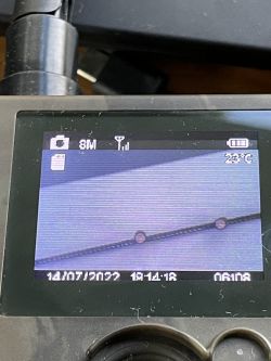

  • Firmware mismatch likely bricked the HC-04G6 camera
    #9 20088078
    kamilski85
    Posts: 9
    Tell me what to do in this situation:
    1. I was struggling with the configuration of the webcam and I came up with the idea that I would upload a new firmware.
    2. The camera does not work after uploading - none of the firmware, and I uploaded a few, does not work - with newer ones, a white screen, with older ones, after uploading, the logo appears for a moment and the image disappears, but the display still works and the computer does not detect the SD card.
    3. Of course, I didn't check the firmware version before I started.
    The camera was bought in media expert of the EL Home HC-04G6 brand, but the software is Suntek.

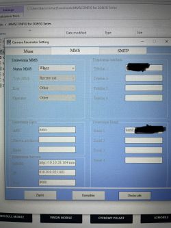

  • MMS setup still unresponsive on HC-300M
    #13 20097978
    kamilski85
    Posts: 9
    Works! Thanks!
    Now back to the main problem - MMS or email setup doesn't work. It just doesn't respond - it detects the card, the range is there, so now the questions:
    1. How to properly configure the file for PLAY - I downloaded it from http://thophunt.pl/wspiera-techniczne-hc300m and entered phone numbers and turned off e-mail configuration, but still nothing - it also does not respond to codes such as *505* .
    2. The camera trap is on batteries, will replacing it with batteries give anything, because I also read about it in the thread.
  • MMS setup and 3V battery checks
    #14 20098008
    gradek83
    Posts: 9107
    Help: 930
    Rate: 2103
    kamilski85 wrote:
    PLAY
    Manually.
    Play
    mms
    http://10.10.28.164/mms/wapenc
    010.010.025.005
    8080
    Enter the phone number without +48
    you can enter the e-mail address from the mms gateway, it should arrive.
    You must have funds on the card and the PIN code removed from the card. If it worked before, from what people wrote, it happened that the operator blocked sending mms and called for unblocking or something. Another problem is damage to the internal 3V battery. Efficient should be 2.8 to 3V. If the batteries run out quickly and the date and time reset after removing them, it may be a sign that there is a problem with the 3V battery.
