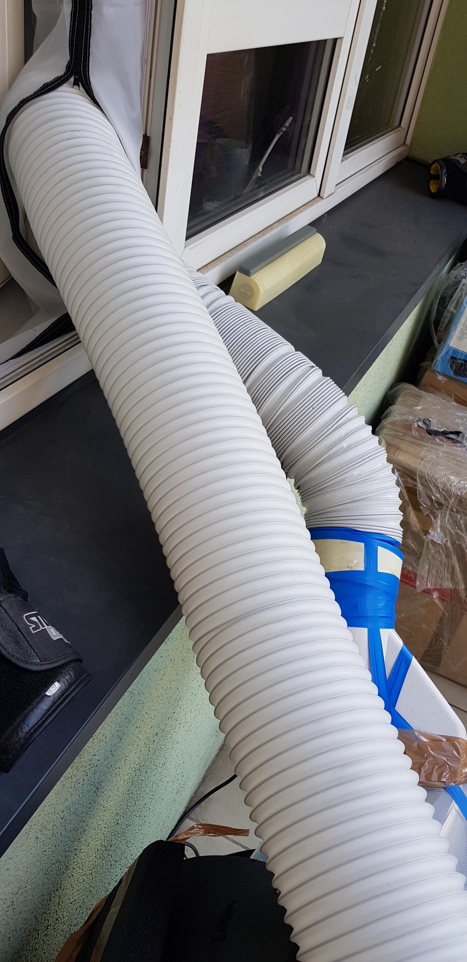

    Gentlemen,
    A few days ago I finished converting a portable air conditioner Zibro P122.
    All the unit I moved to the balcony and to the outlet I connected a pipe, which entered through the window into the center of the cooled room (cool air intake), and the second purchased pipe connected to the evaporator (outlet of hot air from the room to the evaporator).
    This created a closed circuit - the inlet pipe brings the cool air inside, and the outlet pipe discharges into the air conditioner through the evaporator of increasingly cooler air from the cooled room, so that the efficiency of the installation remains constant, regardless of weather conditions on the balcony.
    The whole thing was additionally insulated at the connections with insulation tape, and everything would be fine, if not the noise of the unit at night - about 55 db. Opposite me is a hostel and so far no neighbors complain, so I assume that the noise that reaches them directly is about 35-40db.
    Interestingly, I set the cooling set temperature at 19 degrees, and although according to the weather information outside the temperature reaches 18-19 degrees, the compressor is still able to turn on half the night ;/. (Could it be the fault of the temperature sensor located at the evaporator?)
    In order to reduce the problem I bought 3m 32mm acoustic mat and wrapped it all over the unit, but the noise is still quite significant ;/. To eliminate vibration I put the unit on 1m of the same mat.
    Do any of you have any ideas on how to dampen this type of device? Do you have to disassemble it from the housing and cover the wall, to which the compressor adheres, with acoustic foam directly?

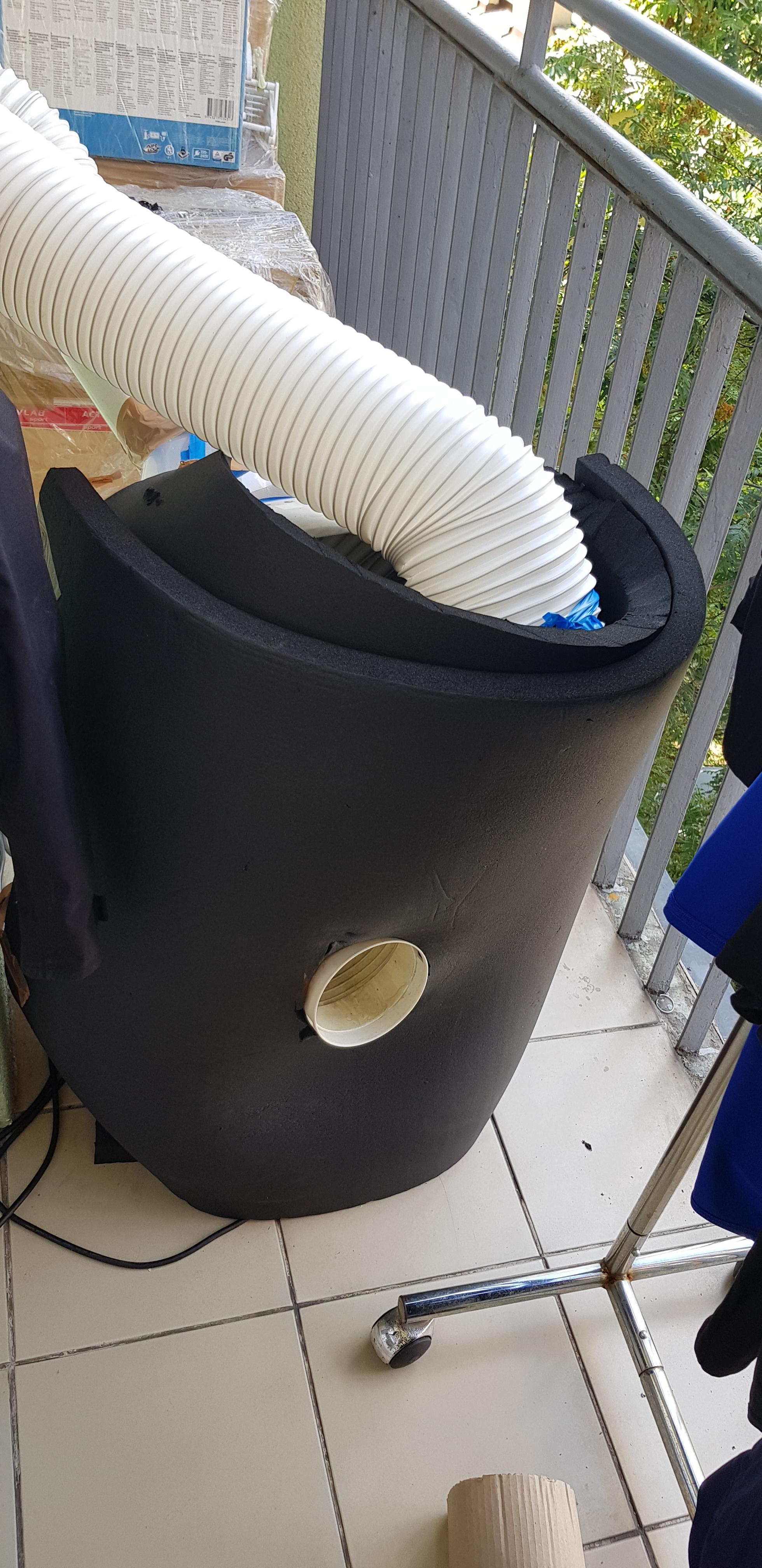

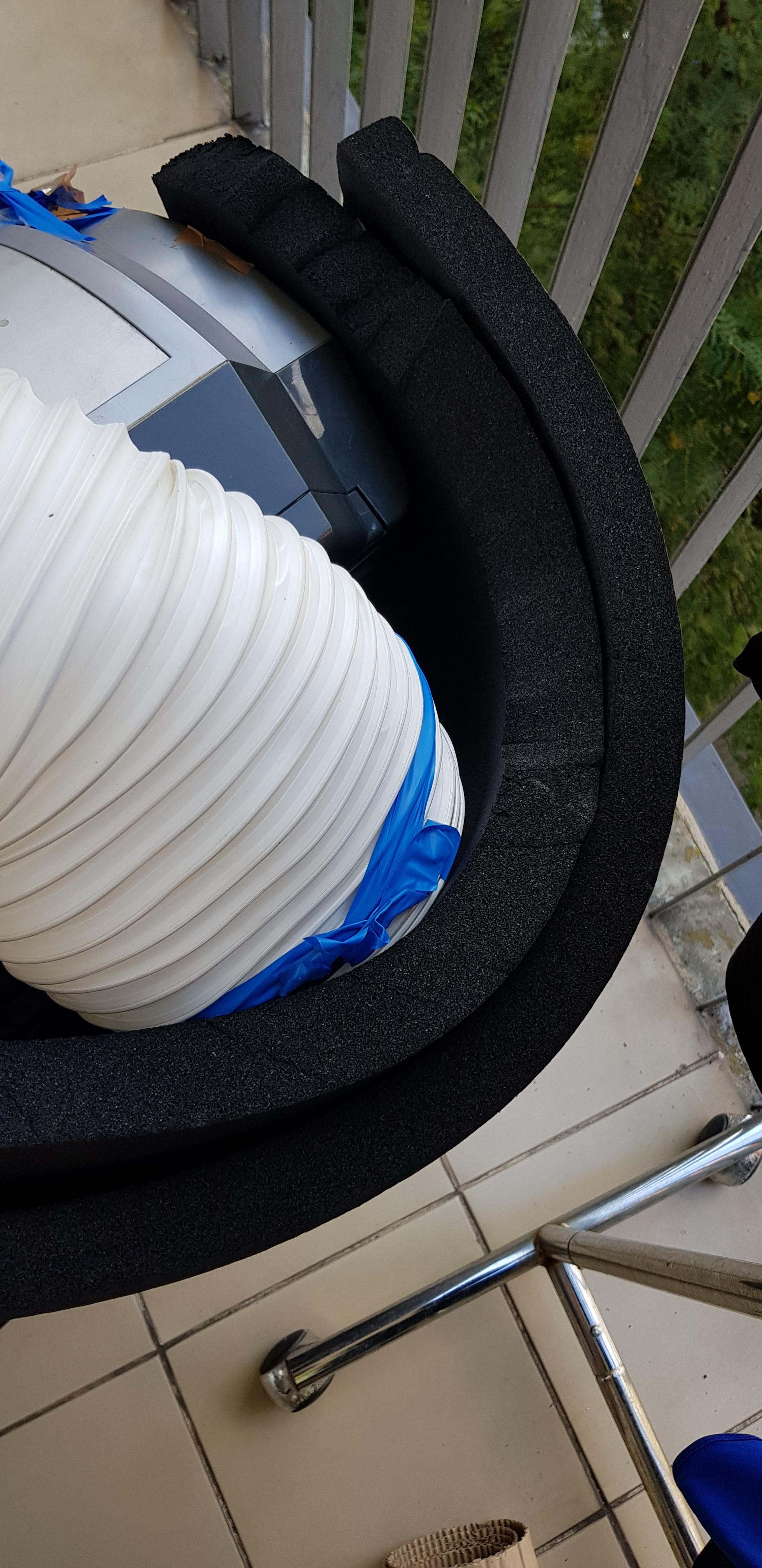

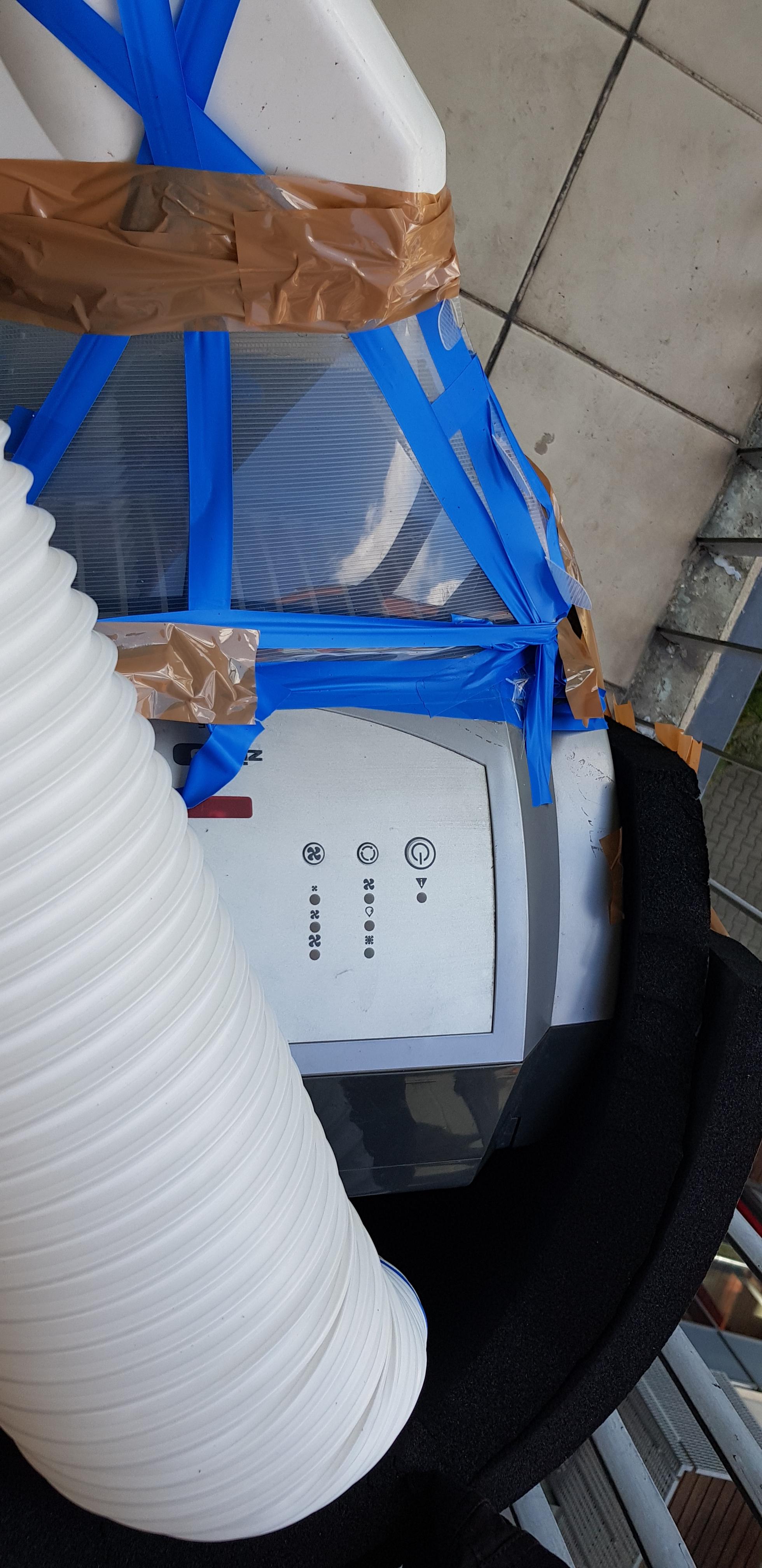

    This is how it looks live.
    The outlet pipe is connected to a basin made of 32mm insulation. Despite the lack of tightness, the draught on the side of the pipe is really strong and there is no drop in performance even in 27-degree heat, to which the entire unit is exposed.
    Checking the interior of the air conditioner I noticed that the only insulation of the compressor is a sponge 10x10 cm, located right next to the compressor. So is there a point in disassembling the housing and "wrap" the inner wall of this 32mm mat?
    The fact that the pipes can resonate I did not think. Probably more the former because of its permanent attachment to the cold air intake rigidly. Or maybe if I attached the pipe to some rubber gasket and only such a structure glued to the outlet resonance would be less?

    Anachronis wrote:
    The fact that the pipes can resonate I had not thought of.
    Not so much the pipes themselves as the air in them. It acts as a "sound tube."
    With these photos you didn't show off.
    What is that black insulating mat. Is it foamed rubber
    Why do you wrap the air conditioner with it? After all, it must have air inlets and outlets, and it is with them and the vibrating housing that the noise comes out.
    It would be better to glue this sponge (pieces) to the housing in the places of the greatest vibration amplitude that can be felt by hand.
    However, I see it in black. It would be necessary to make a zuoenie new rigid enclosure and mute it from the inside.

    This foam is something like this exactly: http://allegro.pl/mata-wygluszajaca-bez-kleju-pianka-kauczukowa-32mm-i5920335038.html
    The plan was to soundproof the chassis from the outside.
    I'm just wondering if building an additional chassis, soundproofing it and putting on the first one would help something. Making such a mini-room damped for the whole unit
