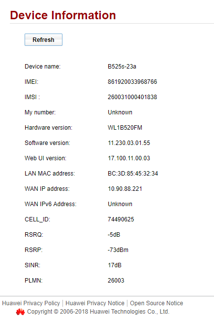

    So I bought, but still B525. After switching on immediately, the speedtest showed 57mbit - which at 19:15 was a brilliant result, but after a while the transfer went down to 12mb (which is also ok, but still ;) ) Evaluating B715 Router for Band Aggregation & External Antenna Performance in Władysławowo
    So it turned out that you should play with aggregations of bands. And here is the problem. My old HTC M7 doesn't want to install apk, it means it can't open the file. The script to ff does not work either (but here the solution is to downgrade the browser, which I would definitely avoid). On the other hand, the E5186 program recommended here, which could work with B525, crashes the message WRONG SESSION TOKEN. Firmware on B525 updated. So does anyone have a working version of the program at the moment?
  • #7 17400234
    makosuu
    Posts: 2984
    Help: 369
    Rate: 370
    Phone app. Do not open only the file manager from the browser. In addition, RSRP -73 is a very good result.

    I am already changing the way I run the app (I have the 1.2 download version of hmanager) - 20-30mbit is not a sensational result - as the previous one was in the form it could pull 60-70 at night. After aggregation of bands we will see how it comes out.

    This is BTS Pawlikowice LTE1800NetWorks, very good signal. The speed depends mainly on the load on this BTS. Check LTE800 and LTE180 + 800 from it.
  • #10 17400327
    motoguru89
    Posts: 8
    LTE 800 -> 16.71 / 14.68 - out of curiosities, the range at this frequency is drastically low (2-3 lines). Where all the rest 5/5.
    LTE 1800 -> 44.47 / 26.87
    LTE 800 + 1800 -> 39.87 / 28.61
    The results suggest that I have an antenna for 1800, it pays to change to some ATK-20 but not tuned to any frequencies?
