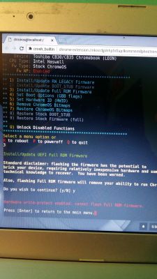

    I have a Toshiba Chromebook and I wanted to install Windows 7 on it today, I found a guide on how to do it,
    link to it: https://www.howtogeek.com/278953/how-to-install-windows-on-a-chromebook/
    I did everything step by step, everything was ok and at the end, unfortunately, something is wrong:
    Toshiba Chromebook Win7 Installation - Resolving Unexpected Error
    Anyone know what this error is caused by?

    You have enabled hardware protection, look under "chromebook hardware protection".
