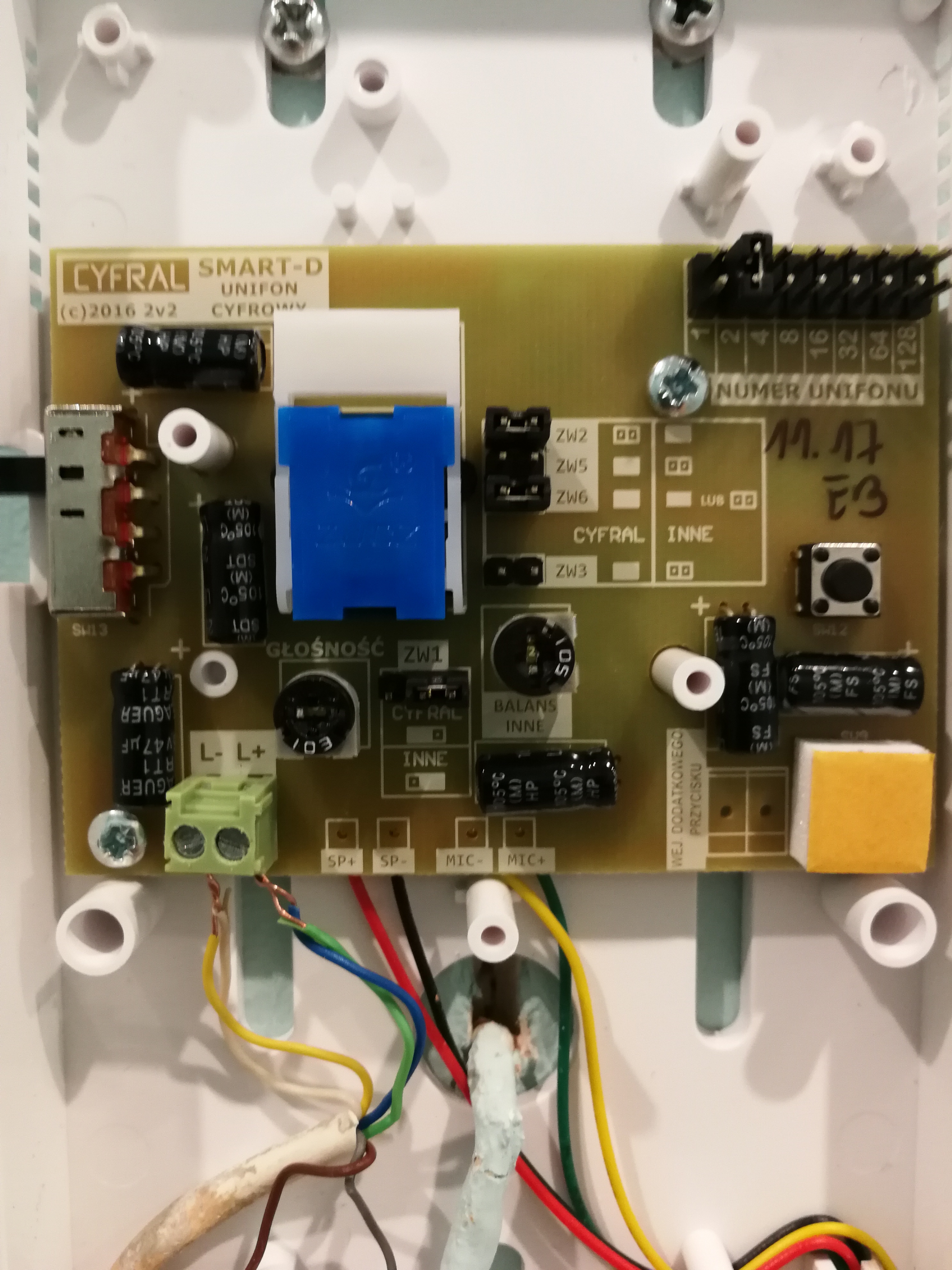

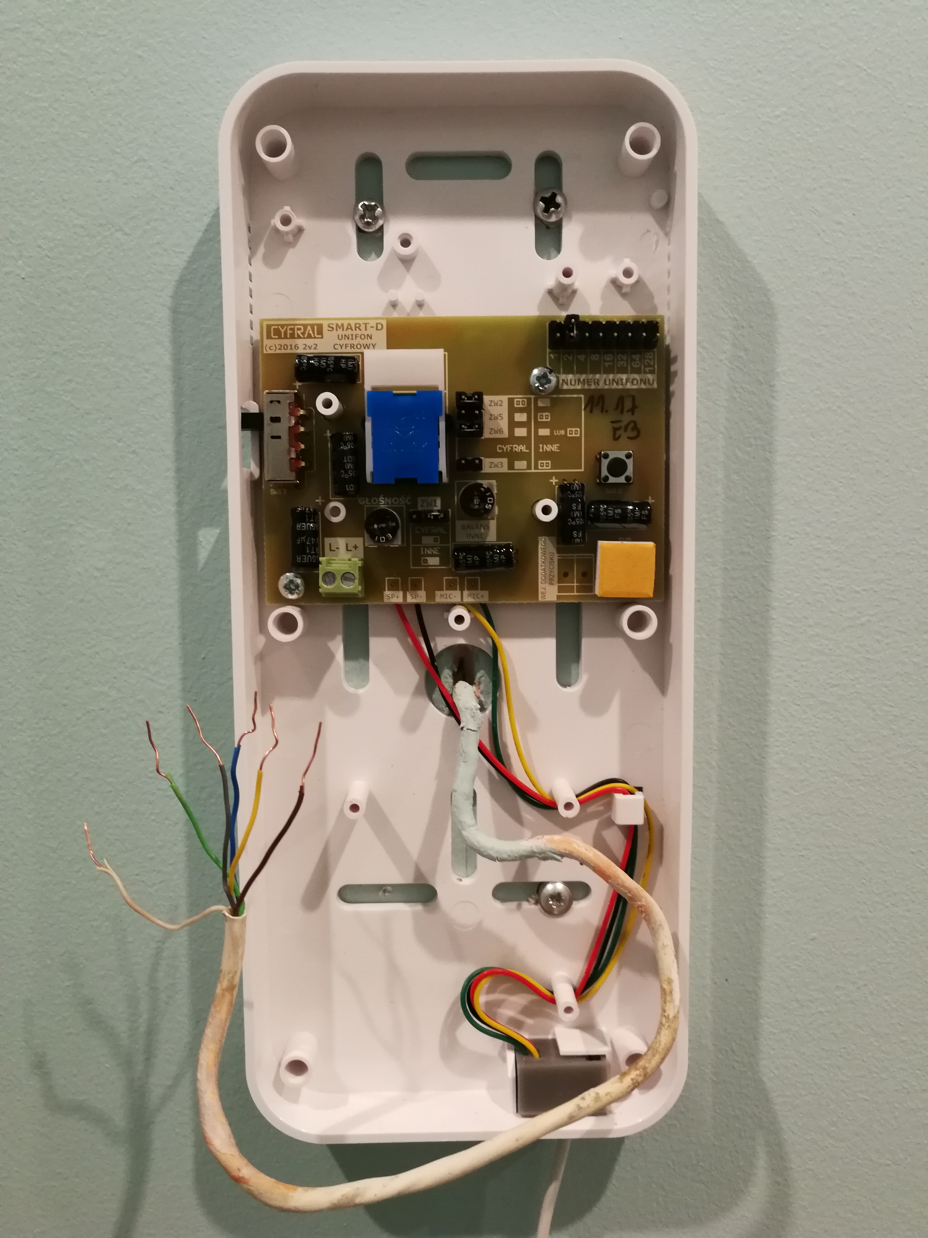

    I bought a new Cyfral smart-d cc 2000 intercom. The control unit ... intercom or what to call it ... next to the block cage is Laskomex cd 2500. My apartment number is 1 if needed.
    Will anyone suggest how to connect a new intercom and set the jumpers accordingly?
    Two cables were connected in the old intercom, brown to L- and green to L +, so I guess it will be the same here. The cables that still come out are gray, yellow and orange.
    Photo of the new intercom
    https://naforum.zapodaj.net/c42cc9583c50.jpg.html

    So the jumper on 1, where is the uniphone number? It doesn't work like that. It rings when there is no jumper but it is impossible to open the door. In addition, there was some error on the cage intercom and it did not respond ... I think it was displaying er-2 as I remember correctly

    The sum of the weight of the jumpers should be the same as the apartment number. In your case, there should be only one jumper on 1. For example, apartment number 15 requires four jumpers, ie 1 + 2 + 4 + 8.
    Except for this one jumper No. 1, you need to set the other jumpers as described on the board.
    You just need to set the jumpers as for "Other", because you do not have the Cyfral control unit.

    So one jumper for 1 uniphone number, one for ZW3 and one to the left for ZW1 yes?

    ZW2, ZW5 and ZW6 are also in the table, where the left side is the Cyfral system and the right side is the other. These must also be set as described.
    Note that the ZW6 says "or" so you have to try both options.

    In this photo you can see pins 2 through 128 and there is no jumper on any of them. Probably there was only one on the "1" and this one is not visible.
    In the new one I also noticed (apart from the configuration jumpers) the "Balans - other" potentiometer. Probably sometimes you still need to select the sensitivity of the microphone so that there is no feedback. This is how the manufacturer wants the uniphone to also fit other systems.

    Everything works.

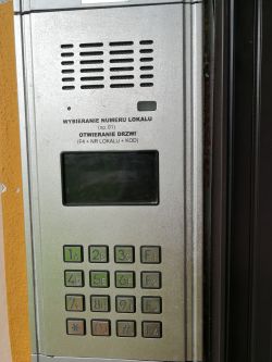

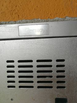

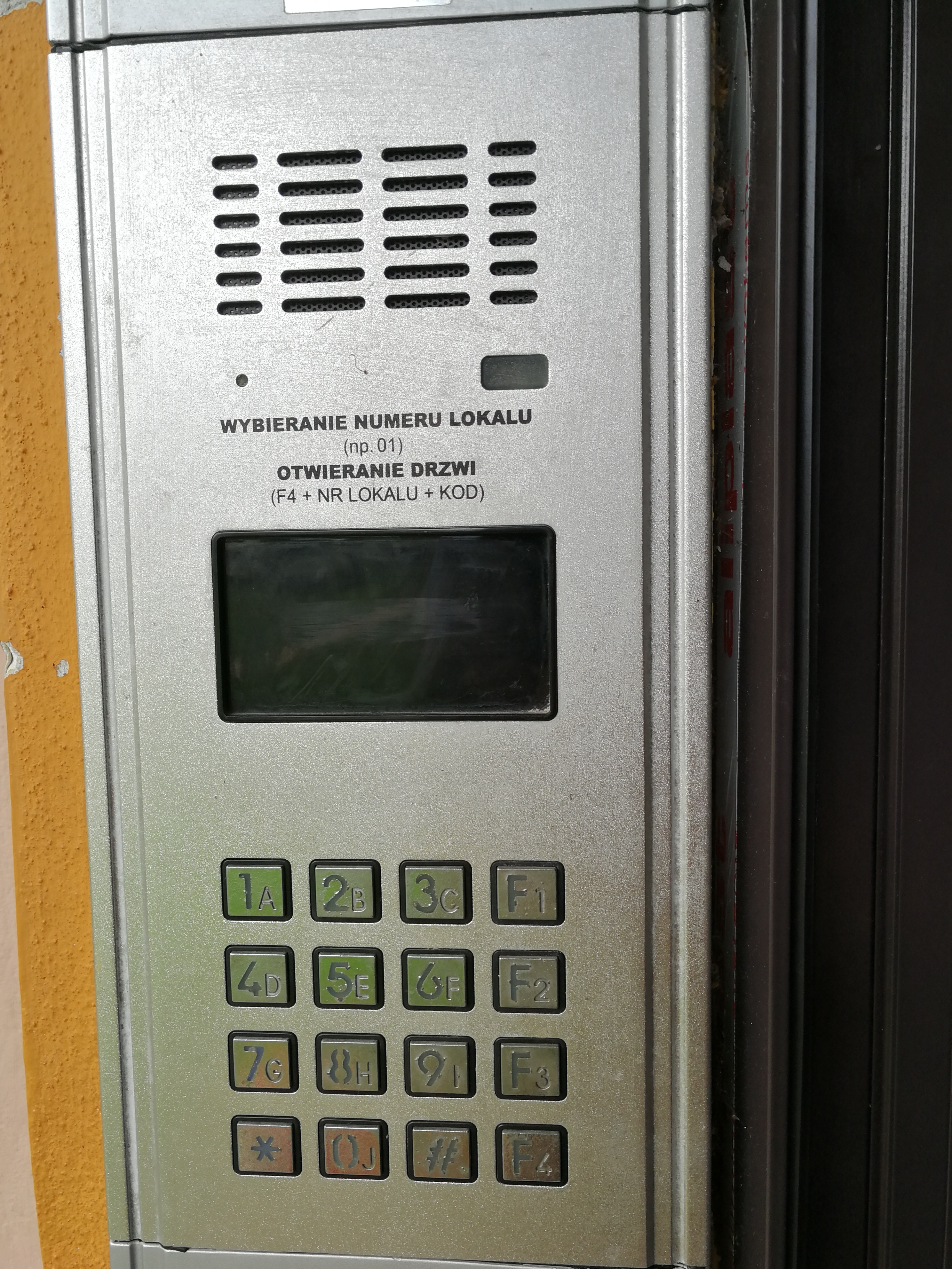

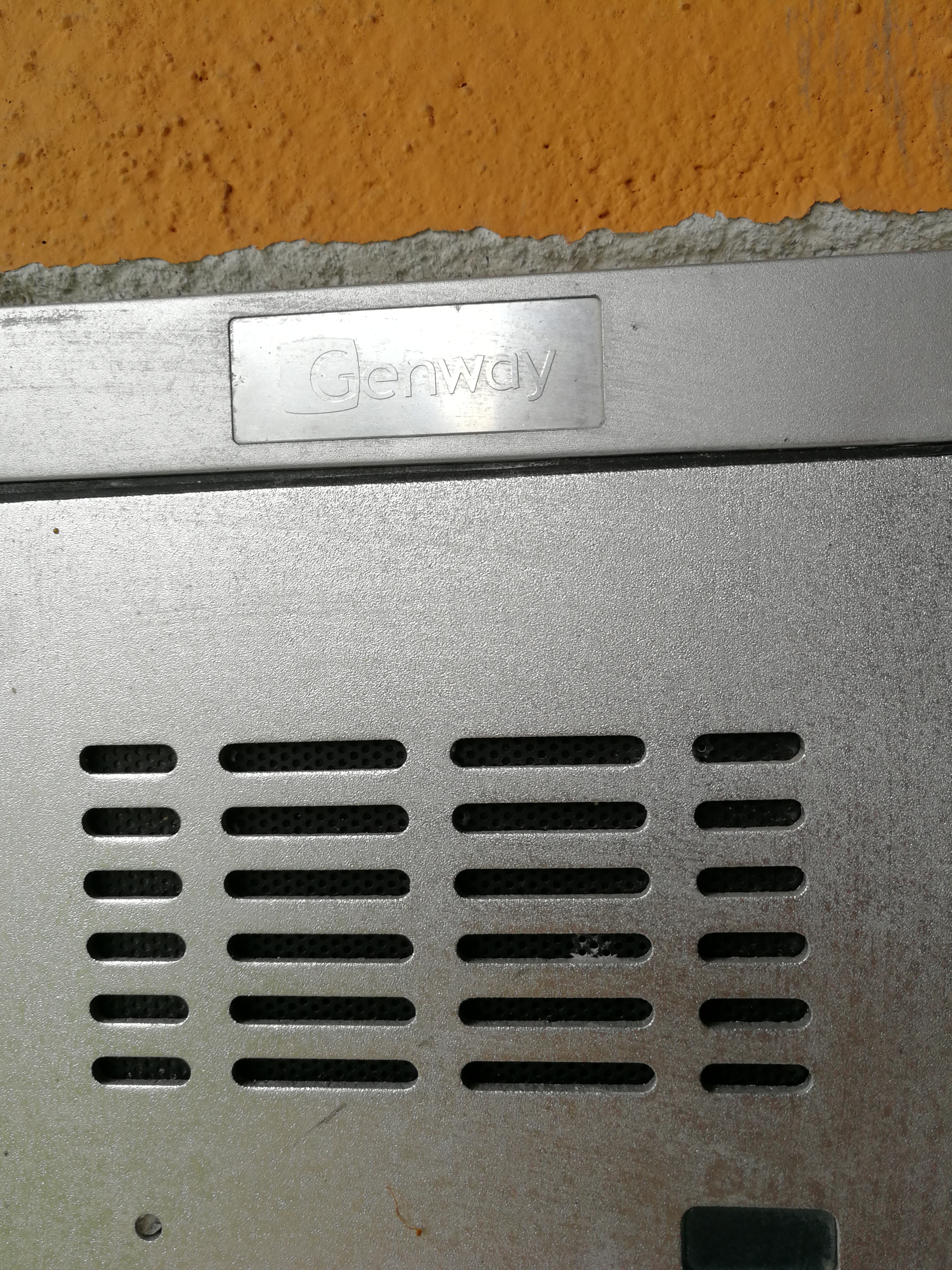

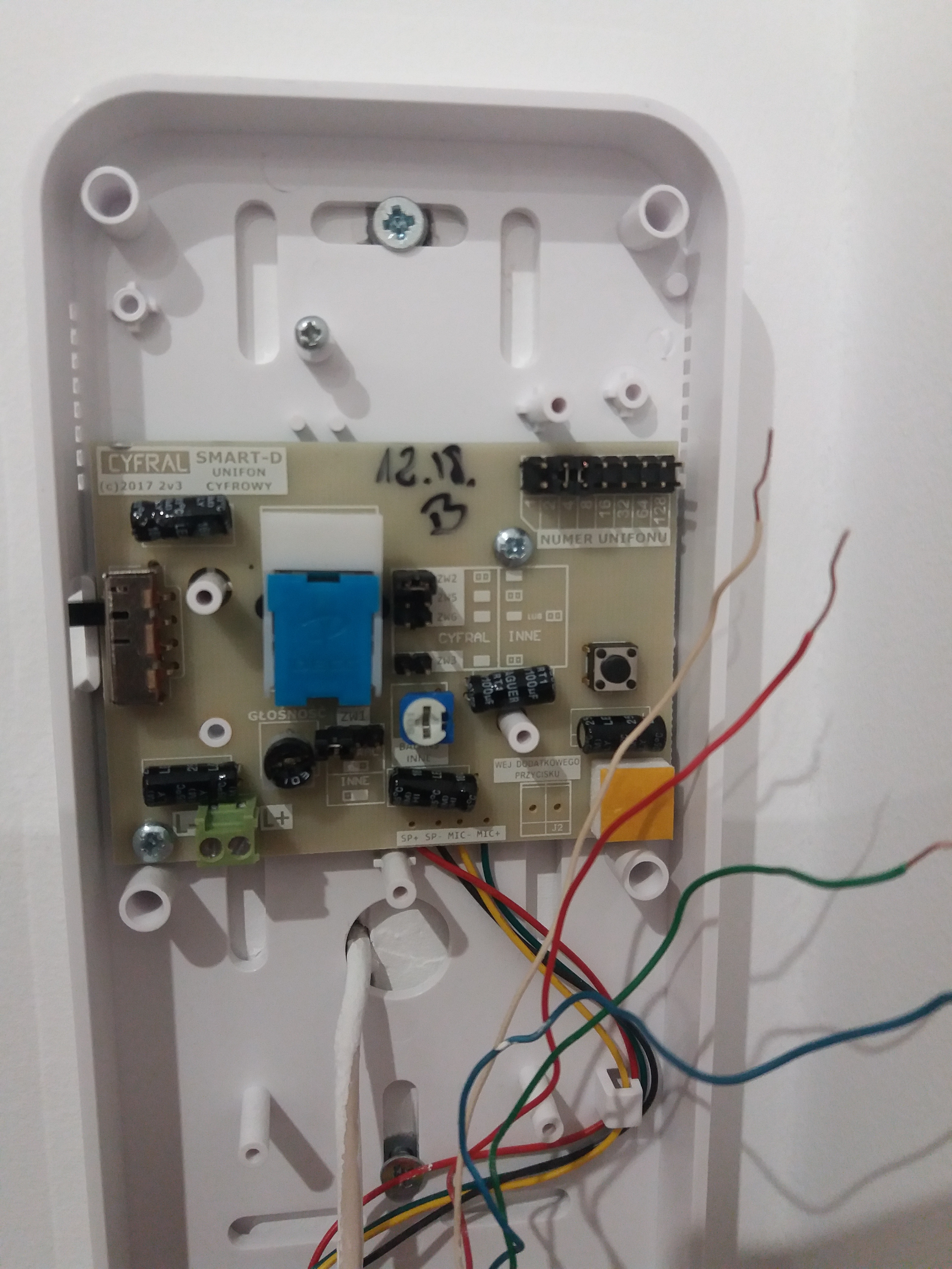

    Hello, I will stick to the topic if it's not a problem. So I bought the Cyfral smart-d CC-2000 intercom, it is connected to the Genway cage intercom. The connection and setting of the jumpers are shown in the pictures. The problem is that the cage intercom generates a signal, but you cannot hear anything inside the apartment in the Cyfral intercom. Silence, deaf, nothing, no response, whether the handset is on-hook or off-hook, nothing is happening. I connected the Cyfral by eye because the old intercom was damaged during the renovation. Can anyone help me? Connecting Cyfral Smart-D CC 2000 Intercom with Laskomex CD 2500 Control Unit: Setup & Wiring Connecting Cyfral Smart-D CC 2000 Intercom with Laskomex CD 2500 Control Unit: Setup & Wiring Connecting Cyfral Smart-D CC 2000 Intercom with Laskomex CD 2500 Control Unit: Setup & Wiring Connecting Cyfral Smart-D CC 2000 Intercom with Laskomex CD 2500 Control Unit: Setup & Wiring

    Check the polarity of the connection. Perhaps you have swapped cables. When looking at their colors, it should be the opposite (logically). Besides, you also have a ZW6 jumper which has the "or" option. But first check this polarity. The ideal would be to measure with a voltmeter where is plus and minus.

    I do not think that this uniphone could be connected to Genway.
    A completely different philosophy of the system.
    The fact that the control panel has a numeric keypad does not mean that the installation is "digital".
  • #14 17338904
    Ircys
    Intercoms specialist
    Posts: 6969
    Help: 1342
    Rate: 2085
    I confirm, Cyfral does not fit here.
    This is where the Genway WL-02NLFD uniphone fits.
    greetings

    Unfortunately, the change of polarity did not help. Playing with jumpers (various solutions) also did not help. I took a Uniphone from a neighbor (no company) but I guess that when the administration set up an intercom, the residents installed Uniphones from Genway, and it worked the first time. Also, thank you for trying to help and I'm going to get a new uniphone.

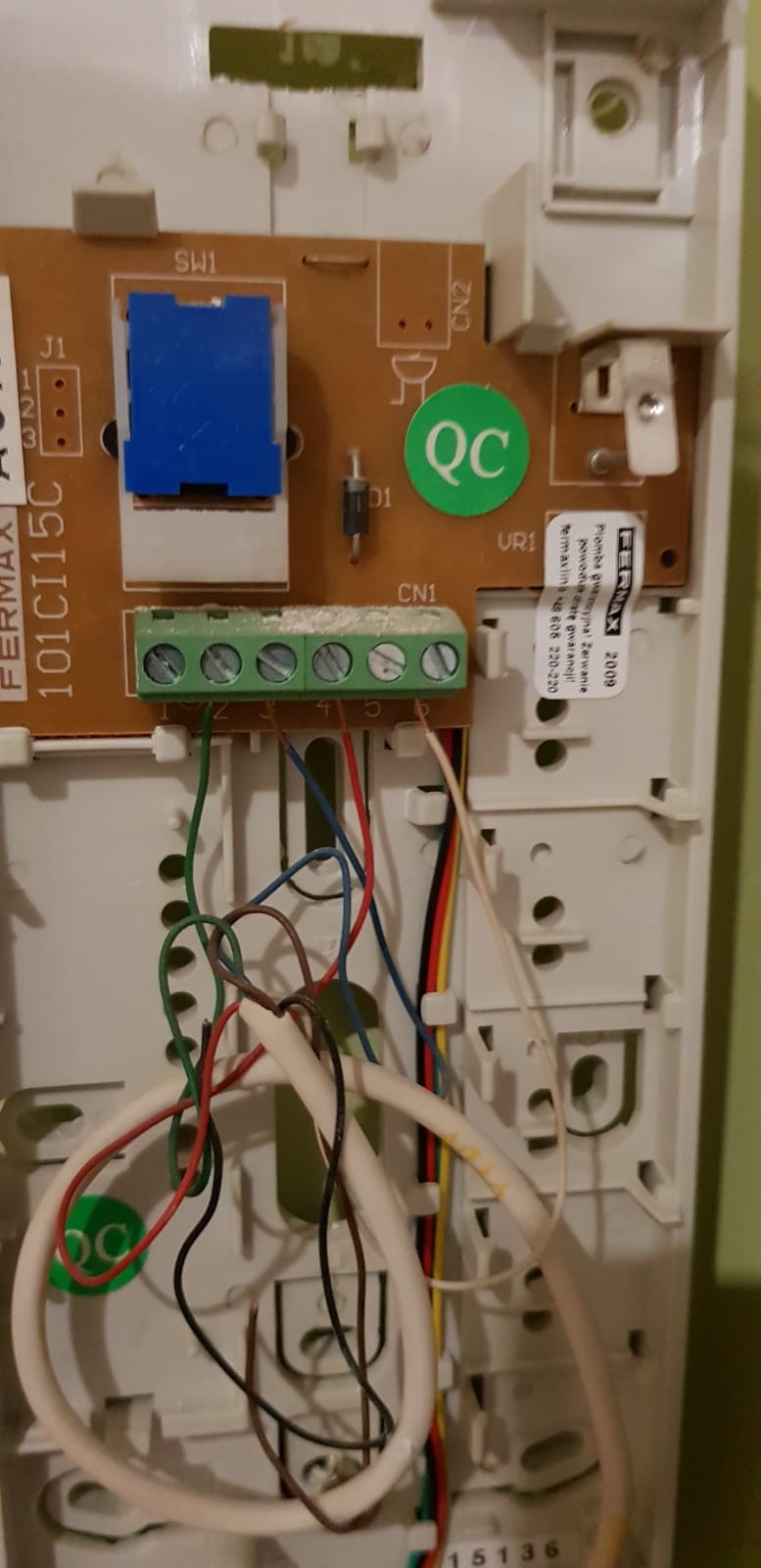

    Hello. I am asking for help in connecting a new Cyfral uniphone, model smart-d cc2000.
    In the photo I enclose the connection of the old Fermax 101CI15C uniphone and the new uniphone without connection.
    Apartment No. 6 Connecting Cyfral Smart-D CC 2000 Intercom with Laskomex CD 2500 Control Unit: Setup & Wiring Connecting Cyfral Smart-D CC 2000 Intercom with Laskomex CD 2500 Control Unit: Setup & Wiring

    The old uniphone is for analog multi-core systems, and the new one is for digital systems. They cannot be used interchangeably.

    You can not do it. You bought a handset for a digital system and the installation is analog. You have to exchange what you bought for an analog one.
