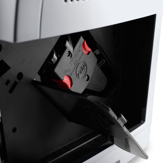

    Hello, I’m having a problem with my DeLonghi ECAM 22.360 coffee machine.
    The machine is 1.5 years old. It’s been in for servicing twice, both times with the same symptoms. It took a long time to make coffee, it was barely dripping, and the temperature was too high.
    The last time was 7 months ago. Now I’m having the same problem again. It’s made 7,000 coffees. What should I do? What needs replacing?

    I suggest cleaning the brew group first. Especially the valve under the metal strainer.
    The brewing block is

    Hmm .. Increase the grinding fineness and apply a cleaning tablet to the brew group, either via the cleaning functions or via the ground coffee functions.
    It seems to me a problem with water breakthrough in the brewing block.

    I cleaned the brewing unit, including the strainer and the valve underneath it. The coffee is still barely dripping. A double espresso takes 2 minutes.
    I suspect it's an infusion valve problem again. (https://www.ebay.co.uk/itm/Delonghi-valve-infuser-piston-Superautomatic-ECAM-Iintensa-Magnifica/183198707056?epid=652019693&hash=item2aa77e6d70:g:q0gAAOSwTM5Y28tD). Someone can confirm it before order?

    Express repaired.
    I cleaned the brewing valve, changed the seals and replaced the valve (https://www.ebay.co.uk/itm/132313067289).
    This valve was causing the problem.
    Everything is back to normal.
