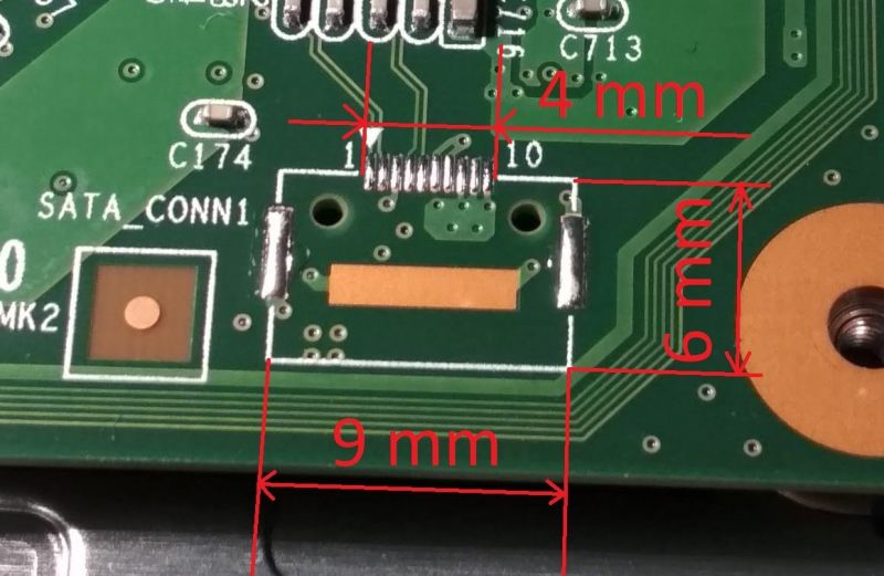

    I have a laptop like the topic, Lenovo Yoga 300 with mounted (soldered) eMMC 32 GB. I wanted to add a WD 500 GB HDD to it.
    I turned on and I saw what was in the picture:
    Lenovo Yoga 300-11IBR: Adding WD 500GB HDD, SATA_CONN1 Connector & Metal Frame Concerns
    There is something like the connector signed SATA_CONN1. I've gone through the documentation and found two things I need: a disk frame and a SATA connector. I was about to order, but on the ifixit.com website I found a photo:
    In this photo the connector has a metal frame, thanks to which the connector is immobilized (it has an additional adhesive tape).
    Have any of you already tried to add a disc to such a disc? The connector is very small and I'm afraid that without this metal frame the connector will move.
    The cost of the connector is about PLN 90 and for such a weak laptop I do not want to risk so much money.] Link [/url]

    There is no connector on your disc. There is only a soldering field to which you can solder the socket. This "metal frame" is the nest. Inside there are plastics and contact plates.
    You will not connect the drive without a socket.

    There is a big problem with buying this jack.
    Once I did it with the consent of the owner of the equipment, I undressed the plug and soldered the wires directly to the pins on the board protecting the cable from pulling out.

    It took me about 30 minutes to connect the disk. The connector pinout in the board is analogous to the SATA connector pinout, I used the old SATA connector with HP DV6 to connect the disc. T +, T-, R +, R-, GND, + 5V

    You do not need help, just the simplest multimeter to check where the mass is, and where + 5V. The 2.5 "disc does not require any other power supply voltages, please also pay attention to the signal wires, they should be twisted as far as possible and covered with the screen. The final effect of my work looks different than what I showed in the picture.

    Measuring continuity between the connector and the SATA plug:
    SATA_CONN1
    | 1  |  2  |  3  |  4  |  5  | 6 | 7 | 8 | 9 | 10 |
    | T  |  T- | GND |  R- |  R  |  GND  |    5V      |
    This seems to match with the circuit photographed, with the 4 signal wires going to caps, and the GND and 5V groupings.

    I connect to the topic, because in such a laptop, on such a plate, without a socket, I soldered on a flexible cable, SATA connectors and everything seems to be fine. 6 wires: plus, minus, 4 signals.
    The 2.5 "1 TB WD Black drive runs without problems, I have Win 10 installed and I'm playing.
    Another one with plates works too.
    BUT ...... the SSD Sandisk 240GB or Crucial BX500 240GB connected in this place is in the BIOS [not detected].
    And GoodRam SSD 120GB is in the BIOS only GOODRAM, without a symbol or capacity.
    Bios updated to the latest one available on the Lenovo website.
    Someone can explain it to me and / or give me a solution?
  • Need three grounds and three 5V lines on SATA side

    My guess is that you didn't connect enough wires on the SATA side. You need 3 grounds and 3 5V connections on the SATA side. It's possible that a part of the disk interface isn't connected to one or both of those.
