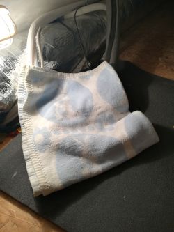

    Today I took more time to locate the problem and it worked. The problem, however, is not the unit, as it initially seemed to me, but the condensate pump. It is installed in the attic directly above the air conditioner. The distance from the air conditioner is a maximum of 50 cm in my eyes. Only the wall to the attic is between them. The pump hums approximately every 25 seconds. I don't know if you can provide links here, but I made a short video. https://youtu.be/db88dMRlAFc

    I wonder if the pump is damaged, is something incorrectly connected, the humming is really spreading through the rooms :( and as I wrote, it occurs about every 25 seconds.

    Drain pumps are like that. Isolate it from the ground with something soundproofing.

    Except that at this point, the jiz is not sticking to the ground. She is suspended in the air, and the hum is still amazing. Wrapping her in some rock wool can help? Could such Java noise pump be damaged? I can hear her hum even outside the house.

    The pipes can be so stiff that the noise is transferred to the building structure. The pump can be "cheaper". Maybe something was damaged or clogged up.

    You need to get to the float and clean its container.
    It's probably under the cover of the air conditioner. Follow the pump suction tube. If it does not help, the pump will be replaced.
    Pumps make noise when running dry. The rest then overheat.
