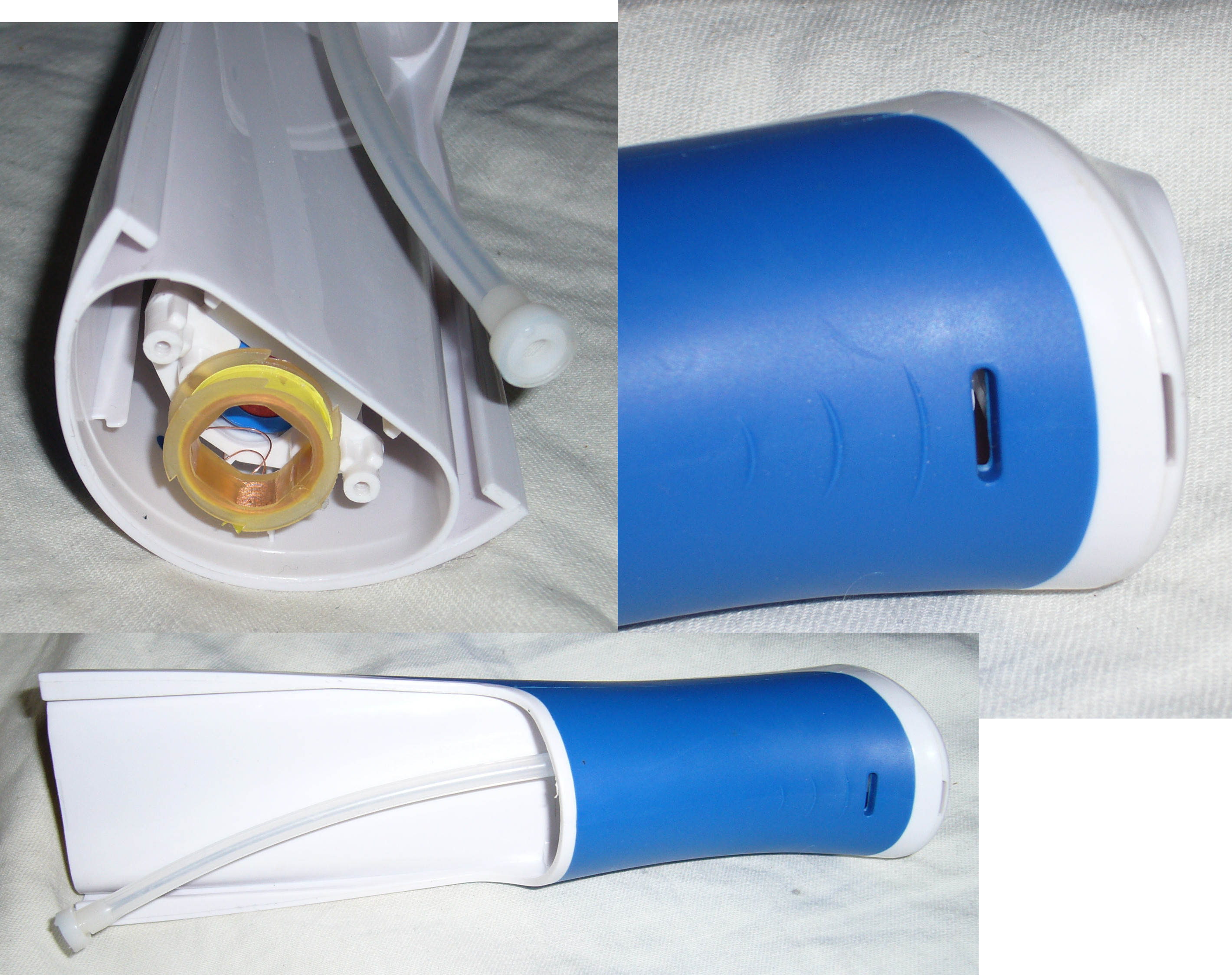

    Irrigator, from the bottom side, after removing the cover visible in the attached photo. Unfortunately, I don't know where the next fixings are. In the upper part visible a white cap with a slot and a hole in the blue, rubberized part of the handle.
    Does anyone age like to disassemble this device?
    I will be grateful for repair information.
    r.
    PS. irrigator is very similar to Panasonic DentaCare Handy EW 1211
    • Nevadent Lidl Tooth Irrigator Disassembly Guide: Comparing with Panasonic DentaCare EW 1211 fl1.jpg (1.23 MB) You must be logged in to download this attachment.
  • #2 17360881
    kamk88
    From the top in the housing there is another screw that holds everything. Just unscrew it and slide out the electronics from below.

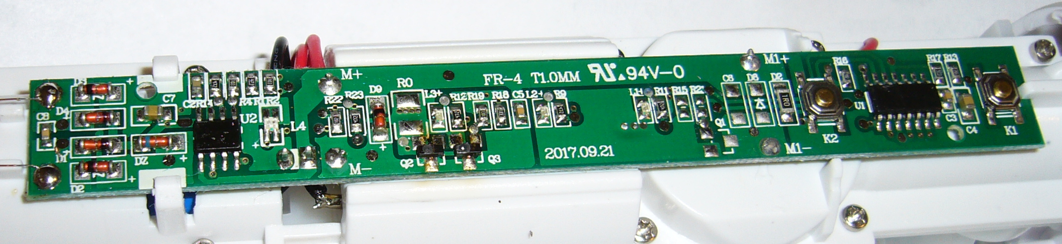

    I have a request because this irrigator also failed me and I need the markings of the capacitors - unfortunately mine burned and I have no way to read the markings. If you could check your markings, I would be very grateful.
    I attach a photo with their location.
    For me, a small, rectangular element above the screw, probably mounted on silicone, completely blocks access to it. Did you remove it before removing the screw? How?
    r.
  • #4 17373678
    kamk88
    I did not peel off anything, I slightly tilted this rectangular element and I could easily unscrew the screw.

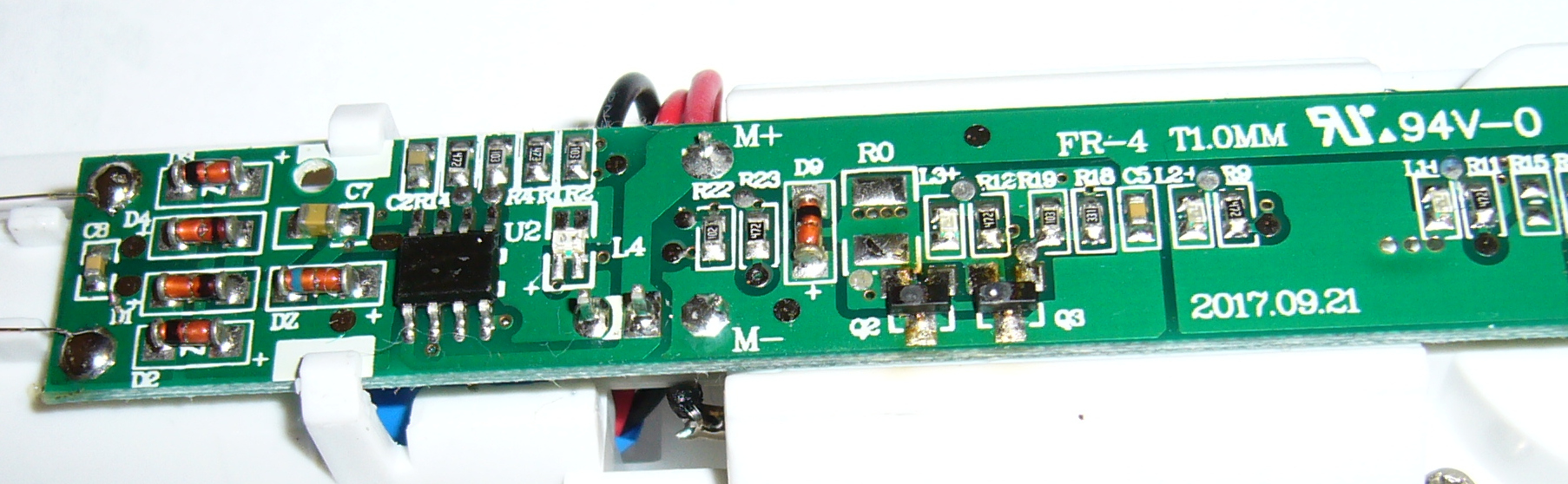

    Here are my photos - unfortunately it is already dark and they are not the best.
    There are no markings, but the elements you indicated have 3 feet and a symbol Q - they are transistors.

    Unfortunately, for now I have to capitulate. I checked that the battery was almost empty. Transistors are probably actually damaged. Unfortunately, you will probably need to recreate a fragment of the diagram from the print to determine how it should work, and I don't have time for it yet. It is a pity that the Panasonic service does not contain the diagram - the entire electronics module is treated as a part for replacement.

    After unscrewing the efficient irrigator, I was able to check that the transistors have the designation A29T
    That is: A29T = AO3402_SOT-23_ (Transistor: N-MOSFET; 30V / 3.2A / 0.9W
