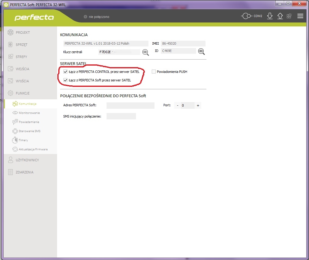

  • #7 17467220
    lukavip
    Posts: 222
    Rate: 29
    I agree with Pollux.
    Run Perfecta Soft in the communication settings.
    This is how it looks from the program side:
    Satel Perfecta 16: How to Find Missing ID Number (FFFFFFFFFFFFFFFFF) for Remote Connection
