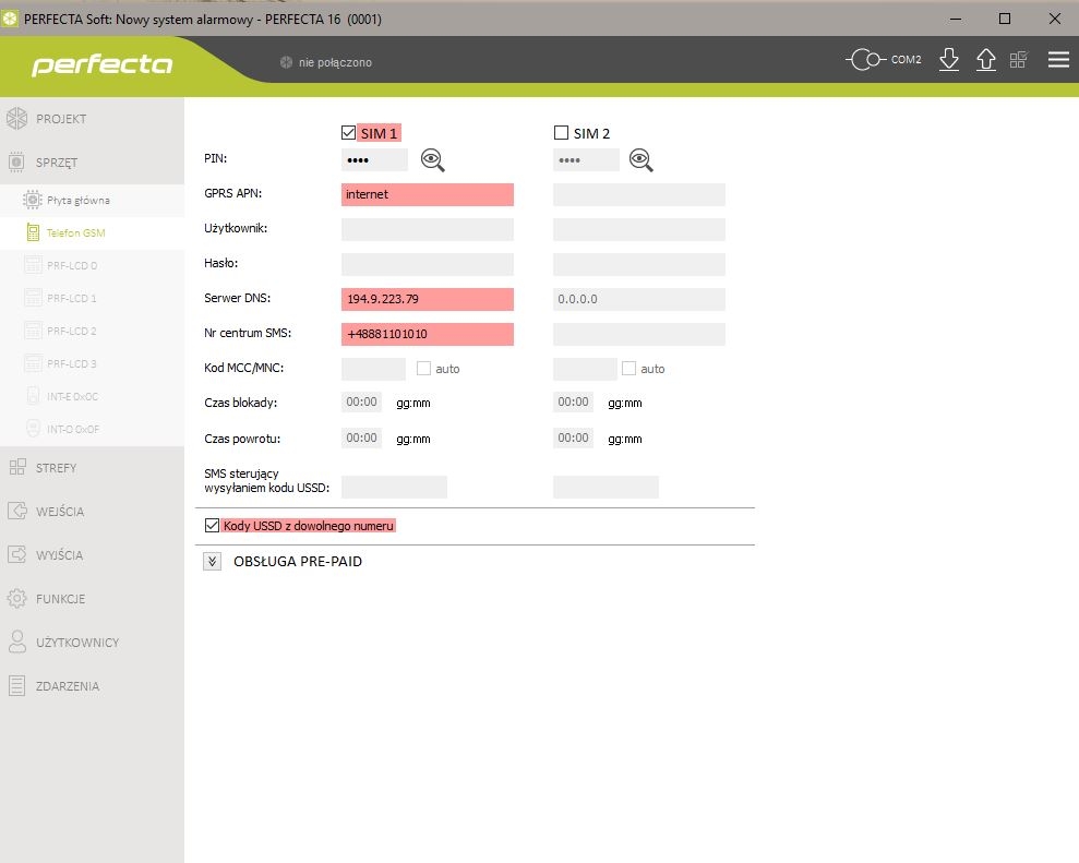

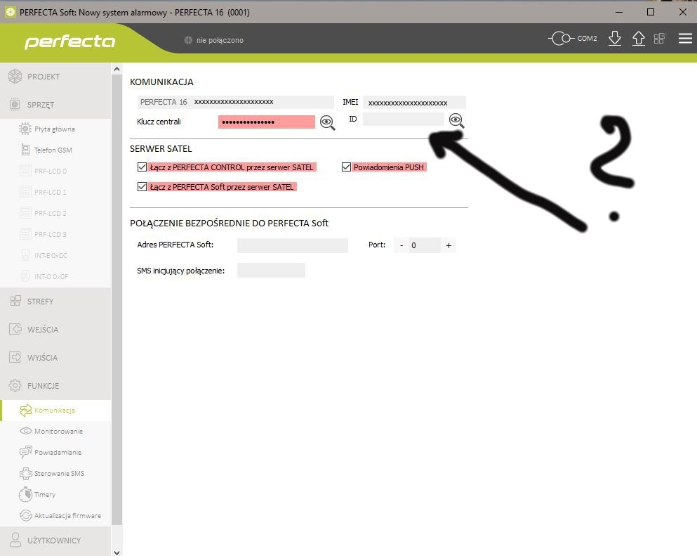

    After configuring Satel Perfecta 16, I have the following problem in the Communication option does not show me the ID number. I've tried all the settings etc. I am asking for information on how to obtain an ID number

    I filled in all the fields correctly, card details and the like. The manual says that after filling these boxes, the ID should appear automatically in the box.

    I don't know what operator this is (some strange SMS center). A colleague cannot use a certain DNS server address (8.8.8.8)?
  • #7 17414066
    chibroxin
    Posts: 100
    Rate: 27
    This is a2mobile, the sms center is.
    Added after 34 [seconds]:
    My network operator sent me DNS
    #8 17414120
    setup
    Posts: 111
    Help: 23
    Rate: 20
    And whether the APN in this network is not a2mobile.pl.
  • #9 17414317
    chibroxin
    Posts: 100
    Rate: 27
    Thanks a lot, APN a2mobile.pl helped
