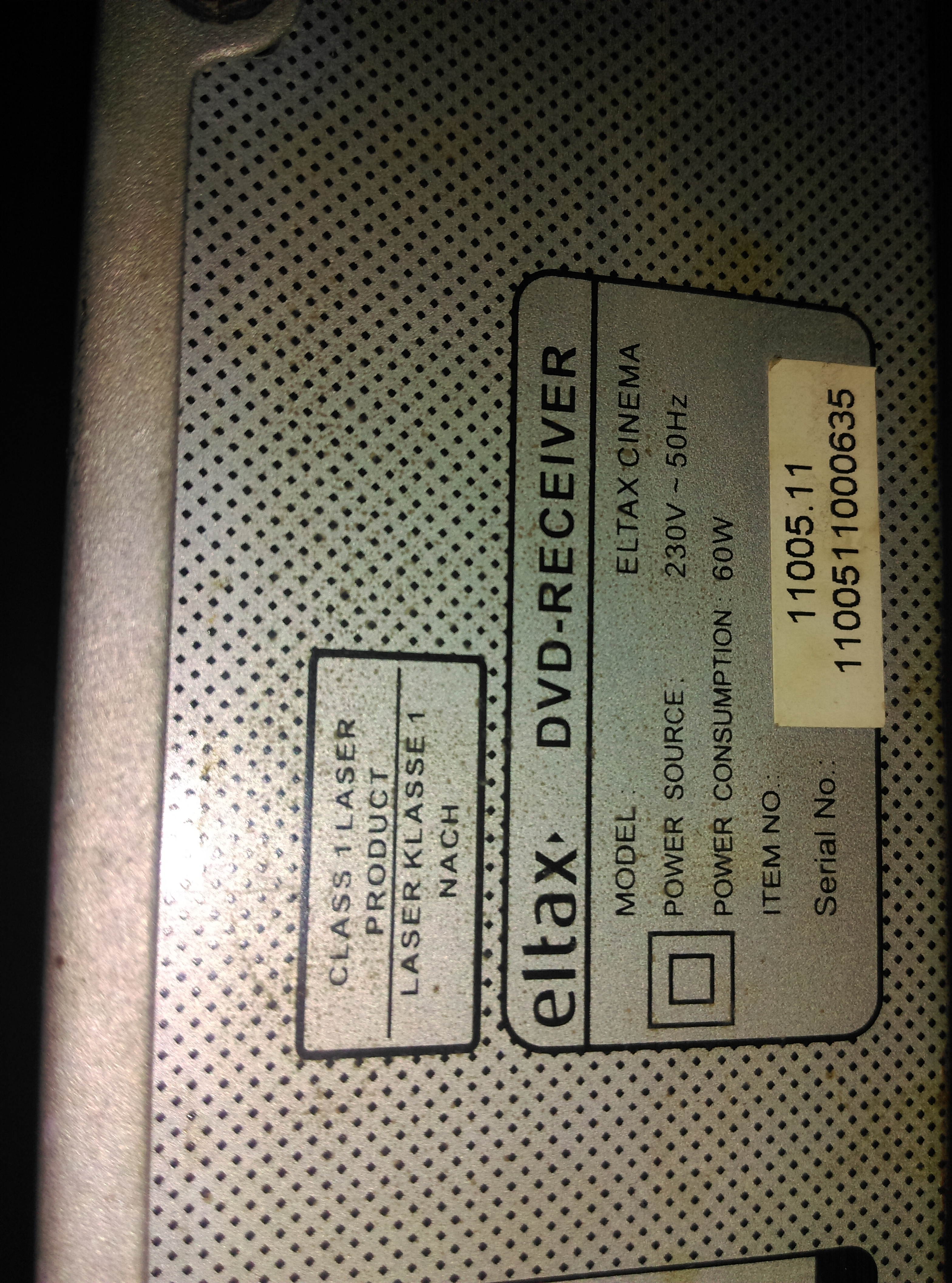

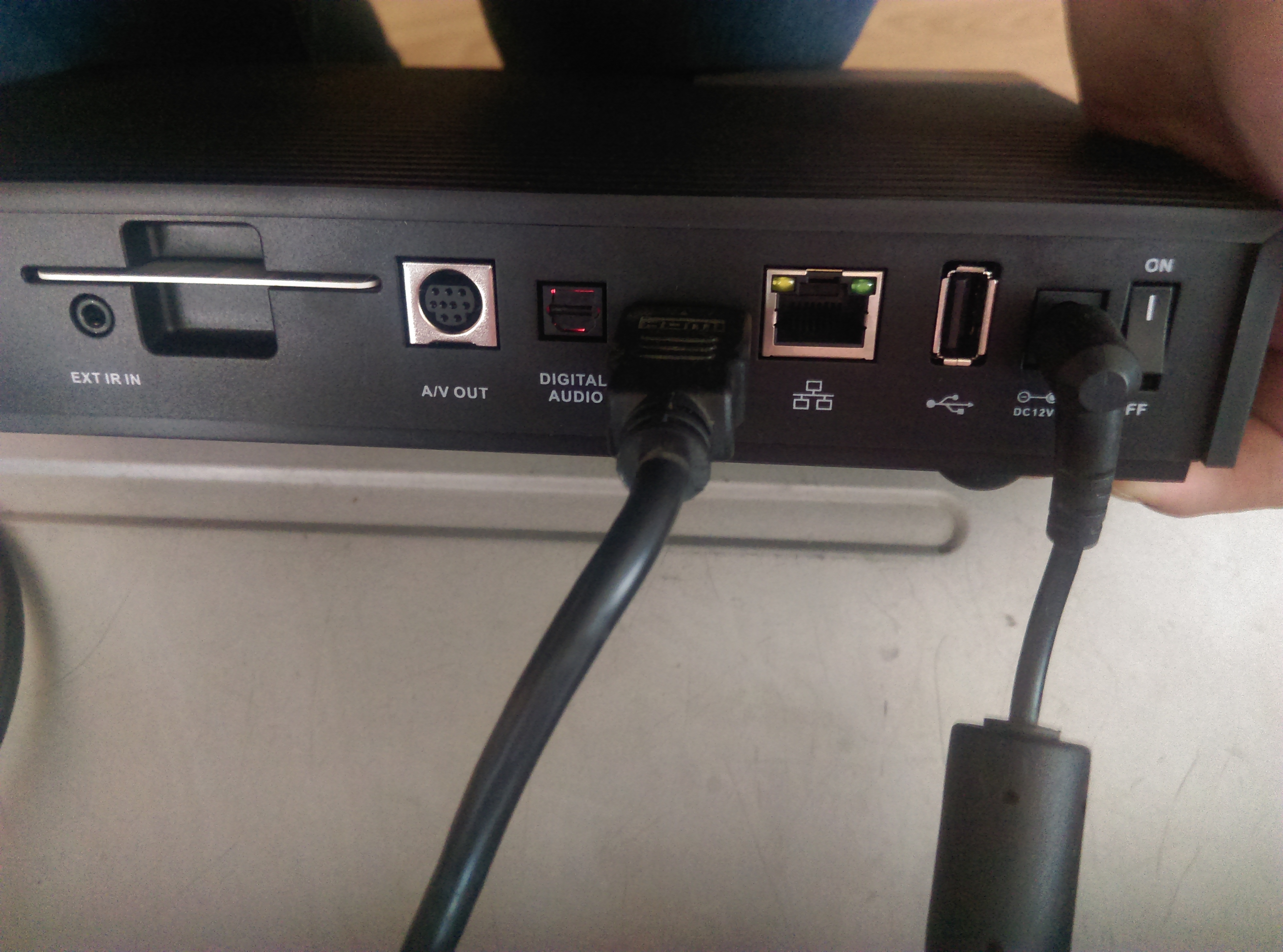

    Do you have an adapter from this multi-pin socket in the decoder to RCA (chinch)?
    Enter the cinema model.

    I don't, the cinema model is Eltax Vectra HMC 4120 decoder, - How to connect vectra HMC4120 decoder with old cinema

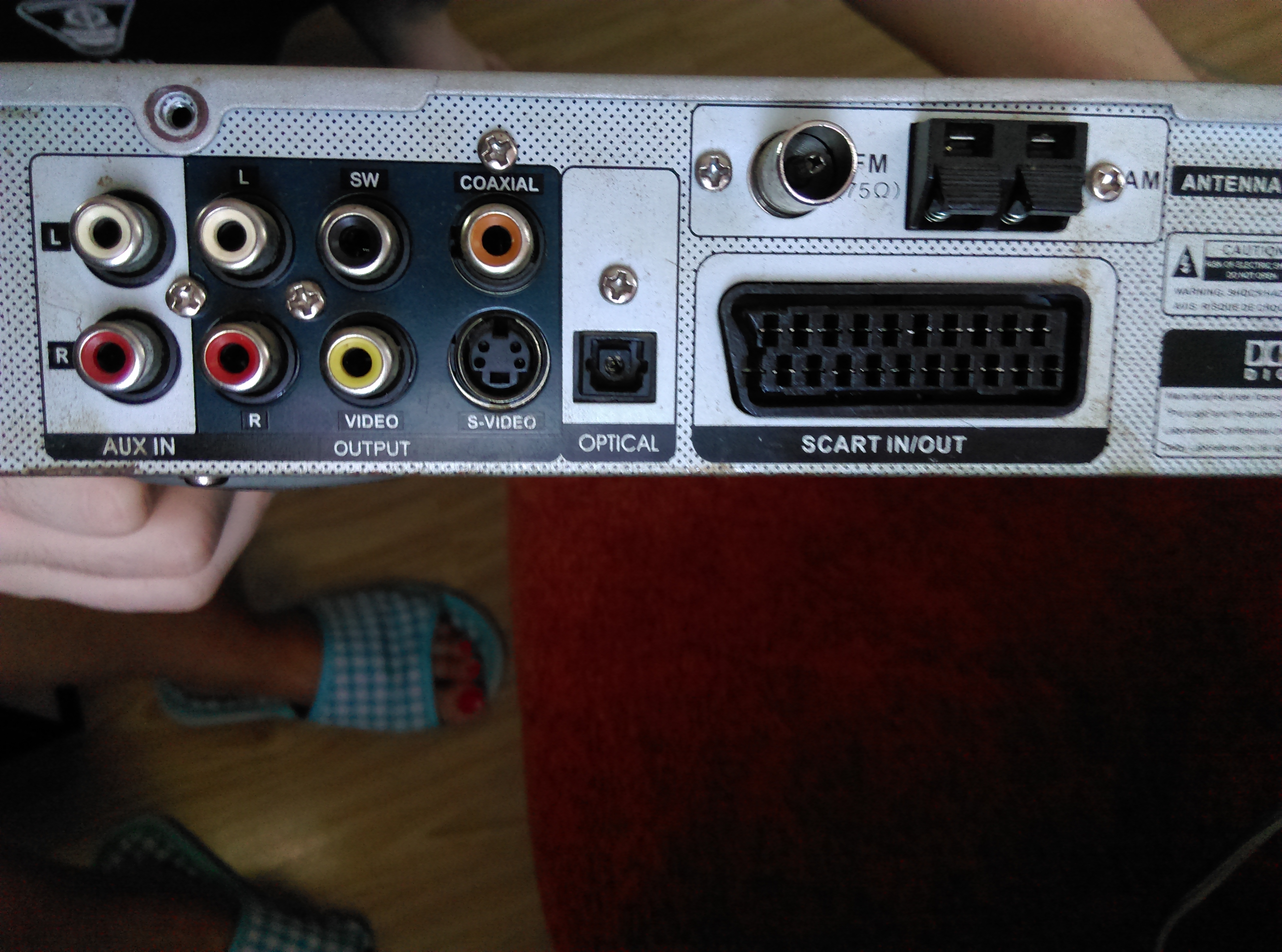

  • #5 17426634
    regina1258
    it was an attempt to connect to the cinema but the cinema does not support optical fiber is too old
    regina1258 wrote:
    I do not have,
    If this adapter is not available, all that remains is to use a digital-to-analog converter:
    . Output decoder optical -> input DAC converter optical -> end of DAC CINCH output -> cinema AUX IN input.
    Please search this forum for "DAC converter".
    There were many topics about this problem.
    The idea is always the same.
    And in case of any doubts, please ask.
    Not that it is too old, and probably the output, not the signal input.
