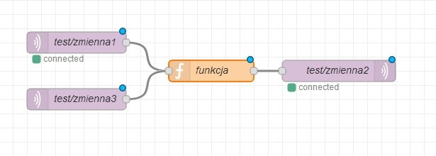

    I have a local MQTT mosquitto broker and a Node-RED server.
    Simplified diagram below:
    topics:
    test/variable1
    test/variable2
    test/variable3
    payloads:
    1 or 0
    I would like to achieve the following effect in Node-RED:
    IF payload for test/variable1 = 1
    THEN
    set the payload for test/variable2 with the read value of payload test/variable3
    How to create an IF condition in Node-RED for MQTT: test/variable1, 2, 3
    My guess is to use a function and as INPUT to use 2 MQTT IN components - one for each topic.
    Please help me with the construction of the IF conditional statement inside the function for the above example.
