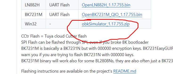

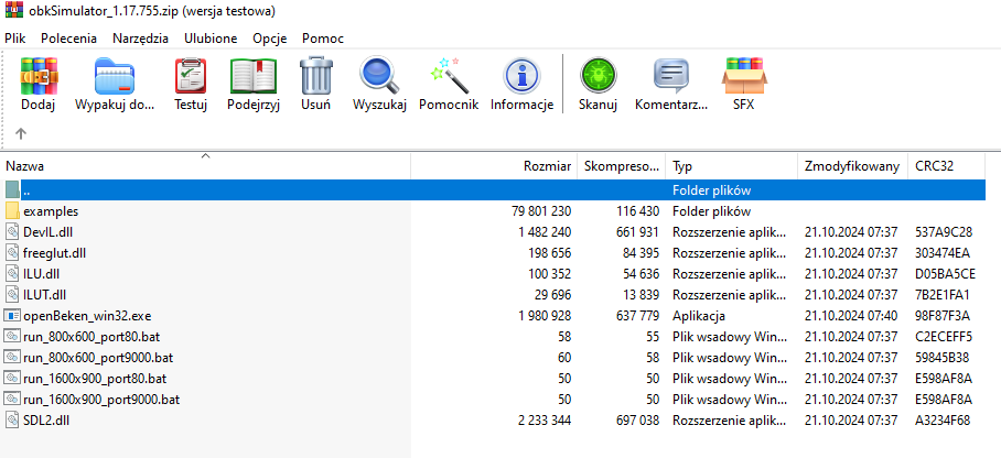

    #8 21274793
    Posts: 14756
    Rate: 12883
    OpenBeken simulator is now included in builds, at least the version for Windows is:
    https://www.elektroda.com/rtvforum/topic4046056.html
    https://github.com/openshwprojects/OpenBK7231T_App/releases/tag/1.17.755
    So you can test most of the cases on your PC, well, maybe except the WiFiState, as it's not simulated on Windows yet.
