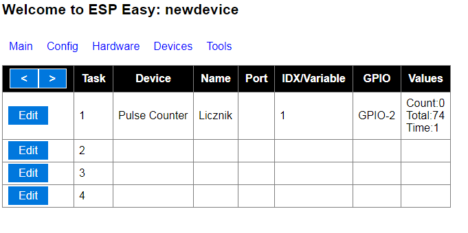

    I try my hand at IOT according to, it would seem, ready-made:
    http://flytomcio.pl/raspberry-pi/pomiar-zuzyc...ektrycznej-z-wykorzystaniem-diody-w-liczniku/
    Everything went smoothly until you had to communicate ESP and Domoticz with you. The author writes "Then we choose the GPIO port, and other settings, including the IDX device in Domoticz" well, my problem probably concerns these other ...
    To sum up: what and where do you need to specify in ESP and Domoticz, where what IPs, ports, logins, passwords and others to make it work?

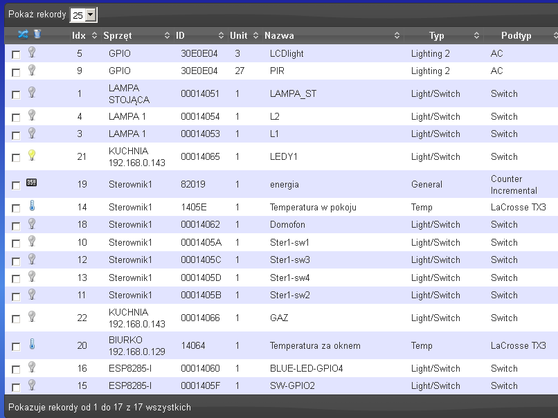

    I have seen the above article and if:
    - IP Controller is the IP of the computer from Domoticz
    - IDX is the value from the first column of the device list
    that's how I got it. The question is what is Unit No.?
    And how should Domoticz be configured? There are also several windows to fill in the configuration tab.
    Could it be a matter of setting up my home network?
    I have ESP-01 or should I upload soft for 1024?

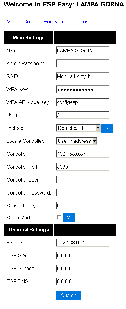

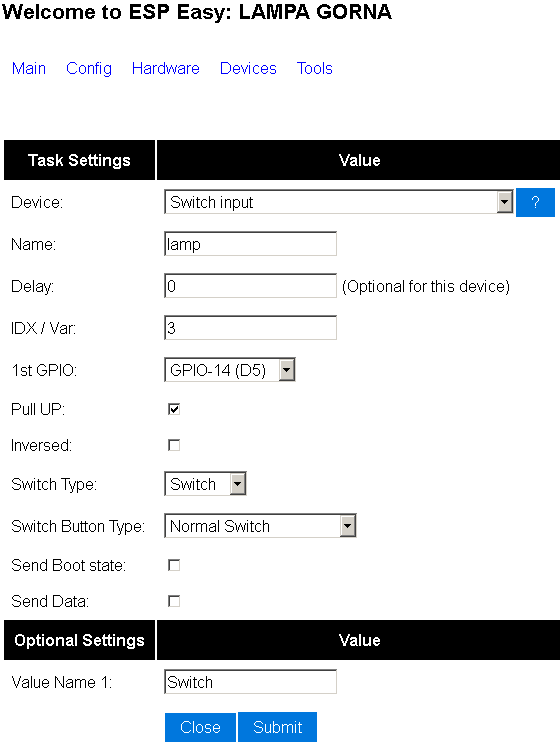

    I have a ceiling lamp made on ESP01.
    Here you have screenshots of my settings:
    Configuring DOMOTICZ, ESP8266, ESPEASY: Setup, IPs, Ports, Logins, and IDX in IoT ProjectPrzechwyty..ie1.PNG (17.24 kB)You must be logged in to download this attachment.
    Configuring DOMOTICZ, ESP8266, ESPEASY: Setup, IPs, Ports, Logins, and IDX in IoT ProjectPrzechwyty..ie2.PNG (18.68 kB)You must be logged in to download this attachment.
    Configuring DOMOTICZ, ESP8266, ESPEASY: Setup, IPs, Ports, Logins, and IDX in IoT ProjectPrzechwyty..ie3.PNG (13.02 kB)You must be logged in to download this attachment.
    Configuring DOMOTICZ, ESP8266, ESPEASY: Setup, IPs, Ports, Logins, and IDX in IoT ProjectPrzechwyty..ie4.PNG (15.61 kB)You must be logged in to download this attachment.
    Configuring DOMOTICZ, ESP8266, ESPEASY: Setup, IPs, Ports, Logins, and IDX in IoT ProjectPrzechwyty..ie5.PNG (15.53 kB)You must be logged in to download this attachment.
    The IP controller is an IP domoticza.

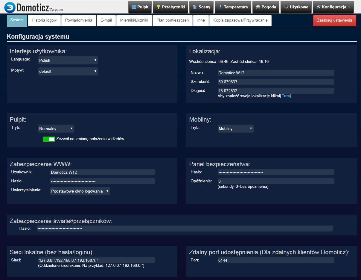

    I don't want to abuse the courtesy, but I meant the settings / configuration tab. Where there are passwords, logins, IPs, ports, lots of sliders at the bottom, etc.

    I think that at the beginning leave everything there as it is set by default.
    Maybe the Local Area Networks parameter (no password / login):
    127.0.0. *; 192.168.0. *
    If your local network is of type 192.168.1.xxx then:
    127.0.0. *; 192.168.1. *
    I have a lcd screen in raspberry, so 127.0.0 locally. * I have access without logging in.

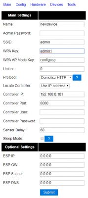

    Added after 7 [hours] 48 [minutes]:
    not bangla, this is how it looks on the screens
    Configuring DOMOTICZ, ESP8266, ESPEASY: Setup, IPs, Ports, Logins, and IDX in IoT Project Configuring DOMOTICZ, ESP8266, ESPEASY: Setup, IPs, Ports, Logins, and IDX in IoT Project Configuring DOMOTICZ, ESP8266, ESPEASY: Setup, IPs, Ports, Logins, and IDX in IoT Project Configuring DOMOTICZ, ESP8266, ESPEASY: Setup, IPs, Ports, Logins, and IDX in IoT Project Configuring DOMOTICZ, ESP8266, ESPEASY: Setup, IPs, Ports, Logins, and IDX in IoT Project Configuring DOMOTICZ, ESP8266, ESPEASY: Setup, IPs, Ports, Logins, and IDX in IoT Project Configuring DOMOTICZ, ESP8266, ESPEASY: Setup, IPs, Ports, Logins, and IDX in IoT Project

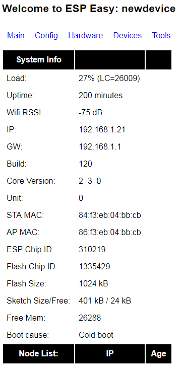

    ESP-01 soft v0.9.5.2 -> ESPEasy R120 512
    IP computer with Domoticz 192.168.0.101
    do you have an idea what I'm doing wrong?
    And one more thing. How to reinstall domoticza so that it does not remember the entered data, passwords, devices? Cleaning Program Files and Chroma has no effect

    #10 17541558
    Slawek K.
    Level 35  
    Posts: 3020
    Help: 259
    Rate: 1303
    Buddy, you have IP addresses from different subnets, ESP has 192.168.1.21 and Domoticz 192.168.0.101 - it won't work without a router. Change the ESP IP address to e.g. 192.168.0.105 and check. The second issue is Controller User and Controller Password on ESP, you have empty, while on DOmoticz it has authentication set.
    Start with the standard Domoticz configuration (default) without security etc. and set the correct IP addresses to ESP, it must work.
    pozdr
