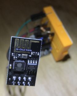

    First of all, the WiFi module, i.e. the board with ESP8266, here ESP8266-01 . Some photos from the auction:

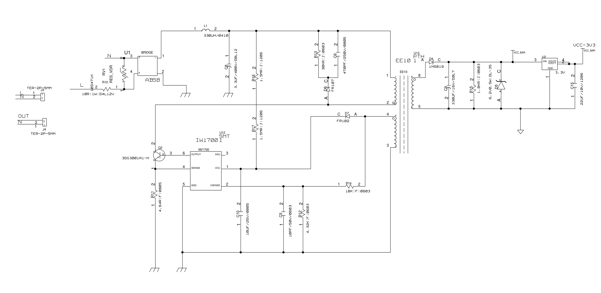

    The power supply above is of course a flyback switching power supply, based on the AP8012 chip, on the secondary side there is also a TL431 (i.e. a precise reference voltage source), under the large capacitor connecting the secondary side with the primary side there is an optocoupler. At the output, this power supply has two electrolytic capacitors and a choke, which together form a filter, but there is no fuse at the input, so one should also be supplied loose. I chose the fuse from an old 5V power supply of similar power.

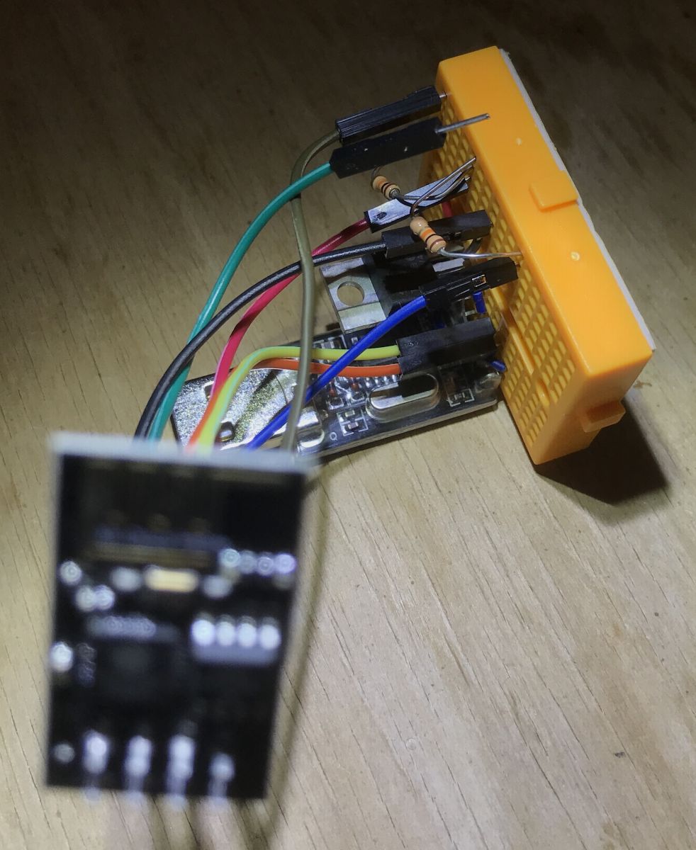

    I made these connections on the breadboard:
    ESP8266 and Tasmota - controlling the WiFi relay step by step ESP8266 and Tasmota - controlling the WiFi relay step by step

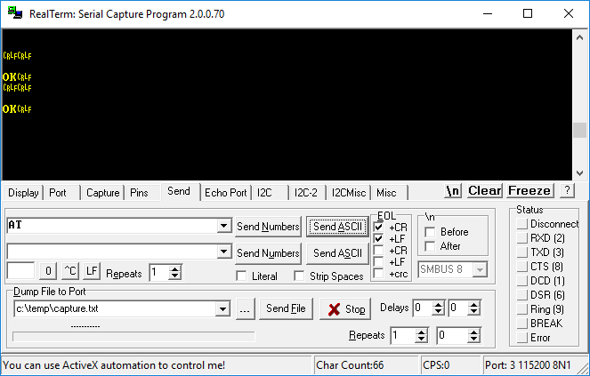

    First, I checked the operation of AT commands. Firmware from AT is loaded by default on this module with ESP, but of course it will not work if we overwrite it. No need to short IO0 to test AT.
    After sending the "AT" command, the module replied "OK", so the communication is working.

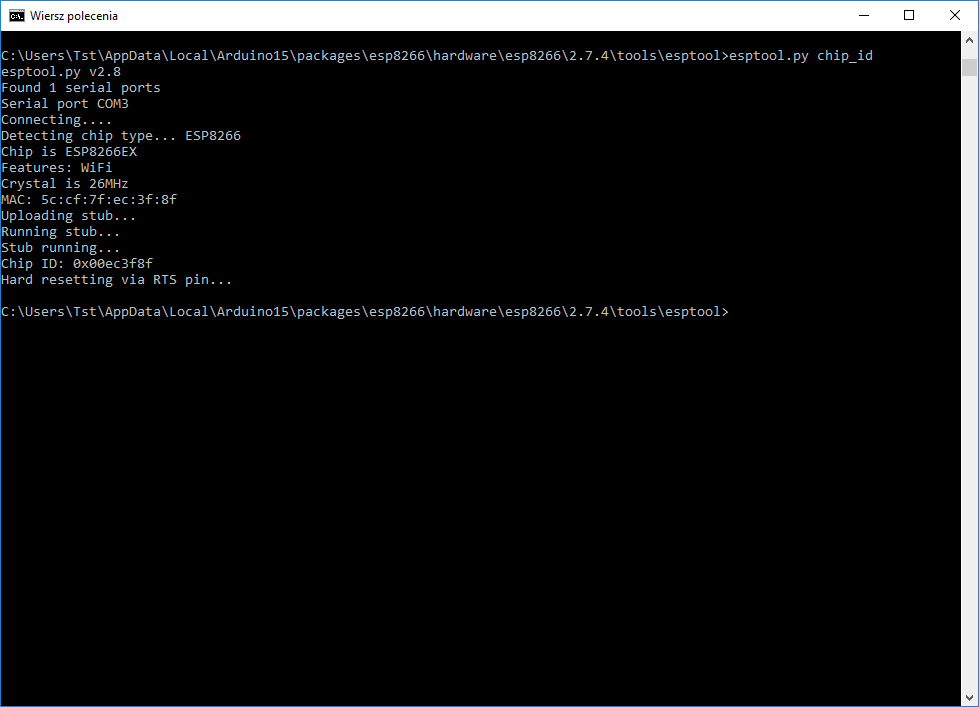

    - start esptool
    Of course, instead of cutting off the power supply, you can simply use the RESET pin, but I prefer to describe the method without using the RESET pin because some ready-made smart modules/devices, e.g. from Tuya, do not have the RESET pin led out, so this method is more universal.
    At the beginning, the communication check itself - the command esptool.py chip_id . It should correctly detect the COM port itself and then the ESP module, its MAC, etc.
    If everything is ok, you can now program. Command esptool.py write_flash 0x0 tasmota.bin (I put the .bin file in the same folder as esptool).

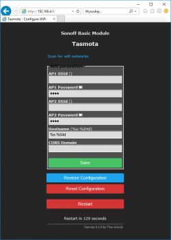

    After restarting the module (remember to disconnect GPIO0 from the ground), the Tasmota WiFi network should appear:
    After connecting to this network, you can start configuring Tasmota, i.e. give the device the location of our WiFi. The device is always available on IP 192.168.4.1 (of course only temporarily, then it will get its IP via DHCP from our router):
    Here we also set the hostname of our device (hostname) which we can use to recognize it instead of the IP address.
    We save the changes:

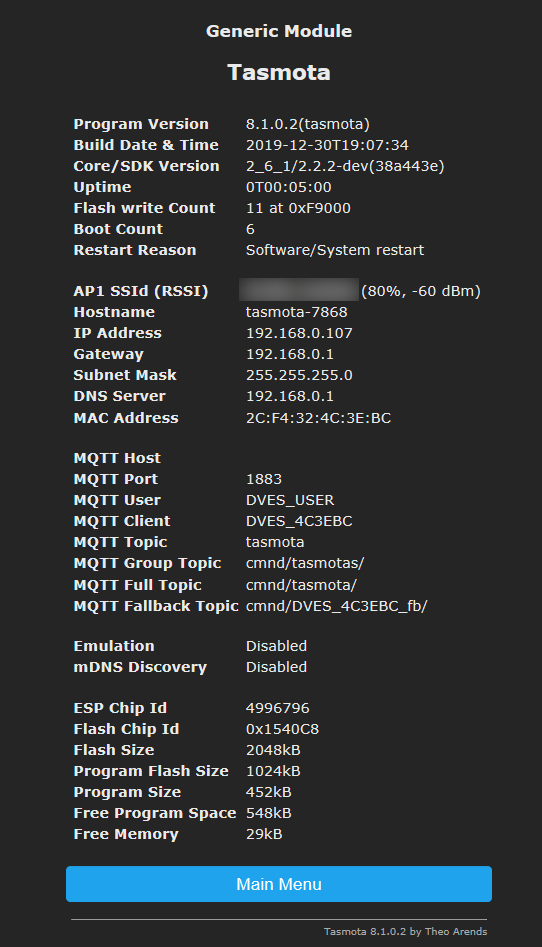

    At this point, the WiFi network from Tasmota should disappear. However, our router should detect a new device.
    192.168.0.107 is the IP assigned to ESP via DHCP by our router. This IP is variable, it may change in the future. The message "lease host name not found" means that my router does not support setting the client's hostname, it is not necessary, although it could be useful if, for example, we were using an IP scanner to determine what devices we have connected.

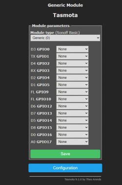

    Step 3 - configuring Tasmota - configuration of output pins
    From now on, the device is available in our WiFi network at the address 192.168.0.107. There you can specify what is connected to which ESP pin and how it is controlled:
    We open Configuration:
    Then Configure Module:
    We can do two things here. You can set a specific type of board we have (this limits the number of available pins):
    We can also set the role of specific pins (and there are many roles, everything is ready to use):
    We can set a different number of relays (you just choose their index) and Tasmota will create buttons for them on the website itself, physical buttons from the system will also connect to them (by index).
    The system made in this way works - the state of the LED can be changed both with the button and through the website. After changing the status of the LED with the button, the page refreshes itself after a while:

    Assigning IP to MAC can be easily set up on the router as you say:
    MAC is seen by both router and Tasmota settings:
    And besides, it can be changed to ESP with a function esp_wifi_set_mac .
