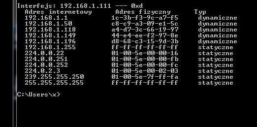

    I have started up an ESP8266 with a temperature sensor on Domoticz for a test.
    Everything works fine. I have an external IP and would like to be able to view the parameters from outside.
    There is a problem with port forwarding.
    Domoticz is on a laptop with a fixed ip address 192.168.1.111, ESP8266 logs in via this address on Domoticz.
    Domoticz after opening in the browser has the address 127.0.0.1:8081
    External address has from the pool 213.108.15....
    Redirects the prot on the router external 80 to the address 192.168.1.111 and internal port 8081
    Now entering the external IP with port 80 I should log in to Domoticz ?

    127.0.0.1 is the address of your computer. What address does domoticz have on the local network?

    Press start, type CMD, press enter.
    When the console starts, type: arp -a
    Send what is written there

    ESP8266 with temperature sensor, Domoticz, port forwarding and external access ESP8266 with temperature sensor, Domoticz, port forwarding and external access
    Such a thing I have computer 192.168.1.111 and Esp 192.168.1.50 have a fixed ip assigned on the router.
