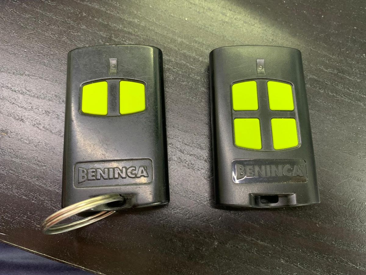

    Is it possible to clone the following 2 remote control models?
    We need to copy left to right.
    Our gate fitter currently has a crown ... Beninca to.go-va Remote Control: How to Copy Settings without Hidden Button (Gate Drive)
  • #41 19386636
    kotbury
    Gantry automation specialist
    Posts: 9555
    Help: 2096
    Rate: 3617
    It is possible, but meeytorically it is not copying. You add a new remote to the control panel remotely, but within the control panel's range, using the old one.
    The method of such adding may be different depending on the type of the control unit. A glance at the instructions (usually the paragraph about adding remotes remotely is right after the table with settings).
    But first, you need to check which coding system the old remote is running on and set the new one in the same way. Instructions in the attachment.
    • pilot ToGo VA.pdf (169.16 KB) You must be logged in to download this attachment.

    POWERRubber.com
    Posts: 12
    thank you for your guidance.
    As I have already read, we have to disassemble the control unit and add the remote control, as it is in the post above.
  • #43 19391403
    kotbury
    Posts: 9555
    Help: 2096
    Rate: 3617
    Not necessarily. First, check which bangel coding system is the old one on (attached instructions), then check which system the new one from the store works on, switch to the old one, if necessary, at the end add a new one using the old one.
    If you open the box and add an untested new remote control, then - if the new one has a different coding - the control panel will switch to it and you will lose all the old ones.
  • #44 19393456
    POWERRubber.com
    Posts: 12
    Thank you for information, as soon as we have time to do it, we will let you know. greetings
