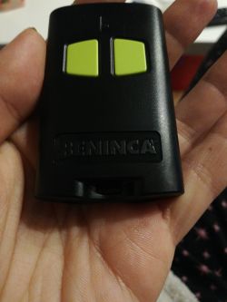

    Hello, I have bought a remote control for the Beninca gate drive to.go-va and I would like to copy the settings from the old, identical remote control. The problem is that this model does not have a so-called hidden button. Is it possible to copy these settings in another way?

    Please paste photos of both remotes.
    Do "identical" looking remotes also have the same button colors and the LED above them?

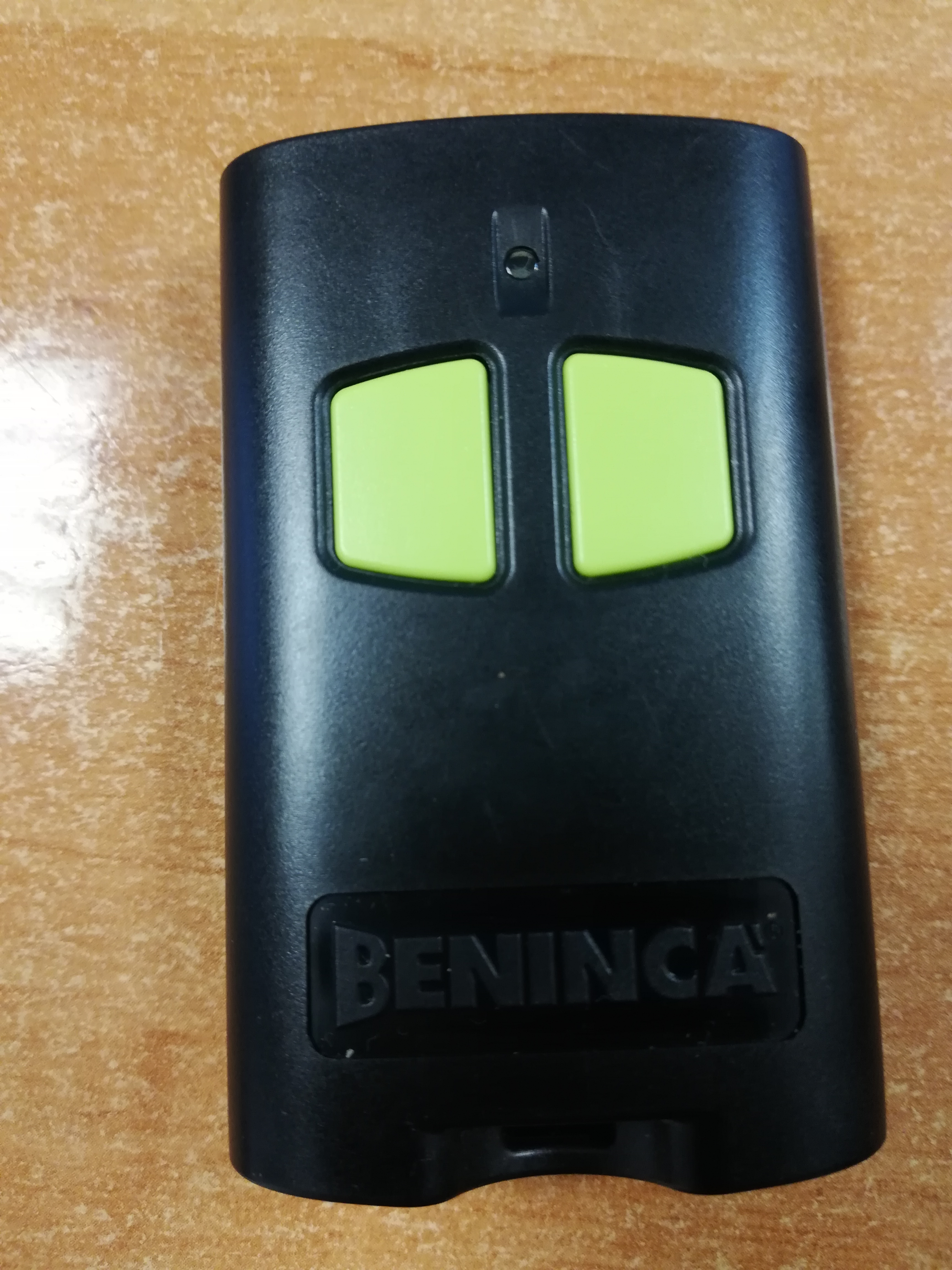

    so the remotes are identical to the picture Beninca to.go-va Remote Control: How to Copy Settings without Hidden Button (Gate Drive)

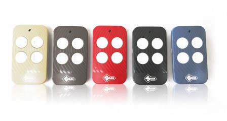

    Please: Air4VPlus
    European product with approvals with a very nice design, and the NFC technology used for programming. It can also combine 4 different remotes from different manufacturers and at different frequencies in the 300MHz - 868MHz range
    Thanks to the technology used, ALS is automatically added to the drive (if the function in the machine is active). with Beninca he advises without a problem but only on HCS codes. I haven't tried copying ARC yet, for those interested, I can check it tomorrow.
    http://www.silca.biz/en/products/key-replacem...ential-remotes/916270/air4-remotes-range.html
    I do not write about Chinese products, although there are many of them and the WHY Evo v.6.3 counterfeit works, although it has less possibilities than Silca pilots.

    I checked and I promised.
    This company's remote controls can "make" any Beninka, but I do not know because the ALS procedure is not activated on the remote when I program it (from another remote) for ARC. Or maybe it starts after pressing the button on the remote control three times, but I do not see it on my equipment.
