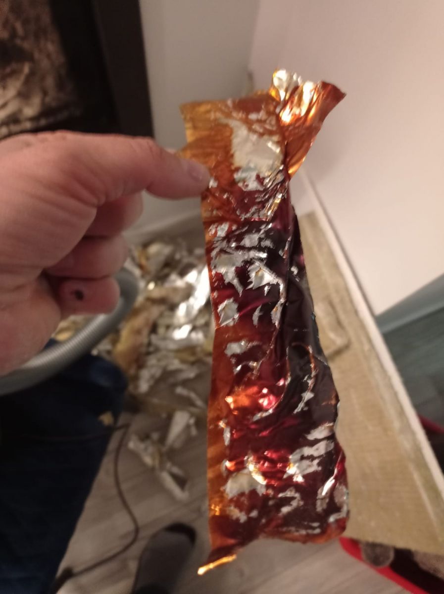

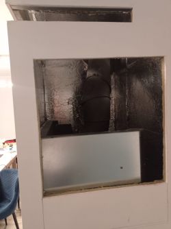

    #47 20839002
    Lisciasty
    Level 21  
    I came across this thread after a long and fruitless search and wanted to report my success.
    Thanks to the suggestion of my friend @mateo-salvadore, I removed the sticky foil as much as I could, and at the same time I vacuumed up all the mess that was within the reach of the vacuum cleaner. After lighting the fireplace, there is no smell! And I fought with this plastic-like smell for good 7 years.
    In my case, the foil right next to the exhaust pipe looked like this:
    A person holds a piece of removed aluminum foil with a brown and silver coating. Interior of a fireplace enclosure with a visible flue pipe surrounded by metallic foil.
    Thanks again, I'm going to the bricklayer to promote this thread because people there are also struggling with the smell.
  • #48 20839037
    mateo-salvadore
    Thanks.
    I can generally confirm - the foil and wool used for insulation is a source of stench.
    The best way to get rid of the problem is to cut a hole in the plasterboard enclosure and get rid of the wool insulation along with the foil. This can be replaced with rigid insulation boards.

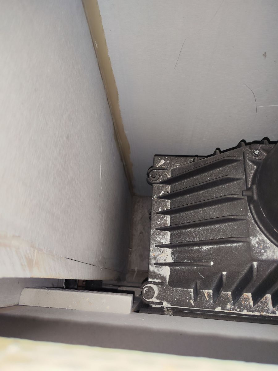

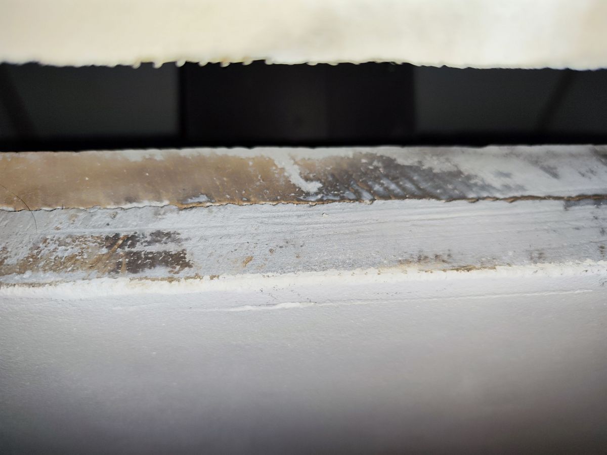

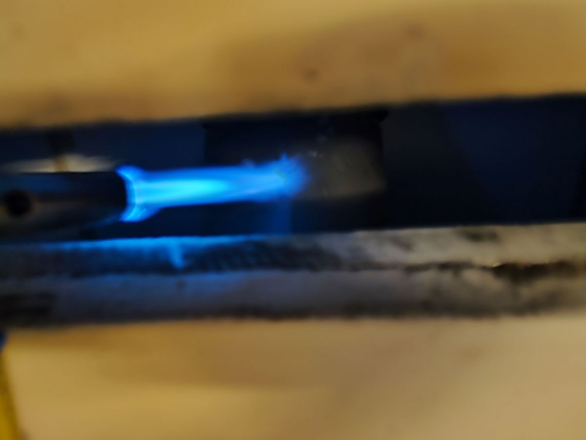

  • #51 20943821
    mateo-salvadore
    Well, there`s not a single piece of foil anywhere.
    The fireplace is made of the following boards:
    Close-up of the edge of a fireplace panel covered with mesh.
    Inside it looks like this (it got dirty when I was taking photos - I already vacuumed the chamber and it didn`t help):
    Fireplace component with a black pipe attached to the ceiling. View of a fireplace interior with a black pipe and sealing. Interior view of a fireplace with panel cladding.

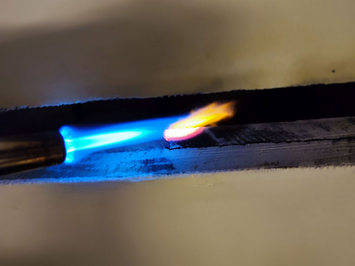

    I tried to locate the source of the stench in a drastic way by heating the elements with a lamp:
    Torch flame directed at a fireplace panel. Blowtorch heating a metal plate, causing it to glow.
    And the effect is that heating the pipe does not generate any stench, but heating the building boards causes the mesh they are covered with to burn and the smell of burning plastic burns. It`s a different smell than smoking, but that`s the only thing that stinks. Maybe that`s it?
    For now, I plan to cut another hole in the building to improve the removal of warm air. If it doesn`t help, I`ll take it all apart and rebuild it... but whether it will help - I don`t know.

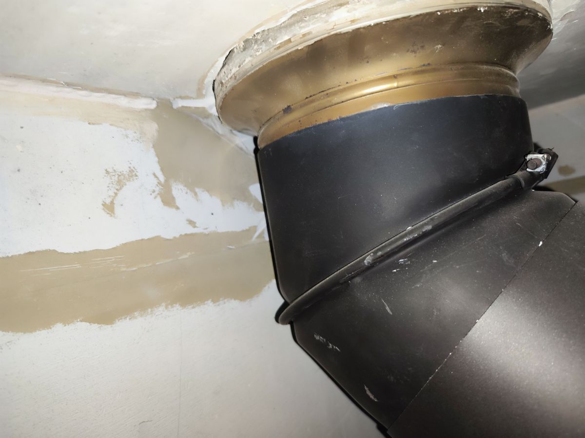

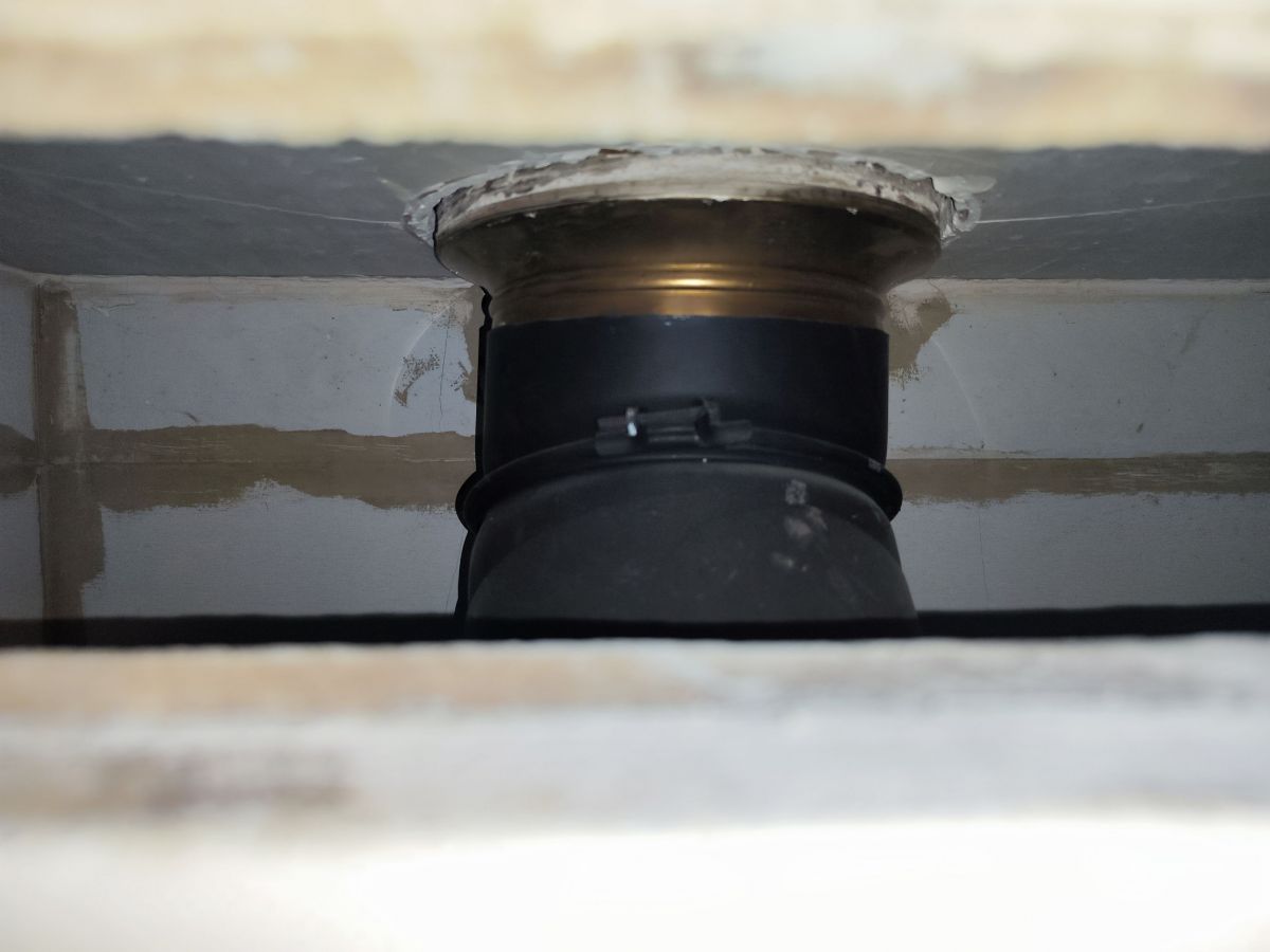

    Hello colleague. I've recently moved into a house with a fireplace + DGP, so I don't know the history and construction of the build too much, but I'm having a similar problem with a strange smell from the upstairs air vents. There is no smell downstairs. Usually the stench occurs when there is heavy smoking (if you can call it that - it's more a case of "long smoking", i.e. for 8 h for example). As a first step, I knocked out the alu tape in the fireplace surround, as much as I could reach with my hand + cut the wool around the flue pipe in the surround. Unfortunately no change. I have a question, when burning did you try to pull the exhaust pipe off the turbine and see if the smell is already there? Because it wants to narrow down the search field.... Greetings.
  • #60 21280605
    bratHanki
    Connection of smoke pipes with a visible golden element and possible soot deposits. .
    Take a look at the photograph. Should the flue pipe go into the elbow or the elbow into the pipe, "against the hair" of the flue gas? There are two such connections. The latter is even sort of burnt - you can see it on this beautiful gold piece. Under the influence of a slight temperature difference between the two elements, the dimensions change and a gap appears, maybe a fraction of a millimetre, but this is enough for the stench of combustion to escape from the chimney. Secondly, adjustable elbows are never 100% airtight. You can see this in photo 2 under the screw.
    In photo no. 5, the yellow flame may indicate fumes escaping at this point if the fireplace was lit. This used to be the way to look for leaks in a car's exhaust system. Nowadays, the components are replaced rather than welded.
    If the fireplace was not lit, the burner flame may have burned off the soot that had accumulated in this area.
