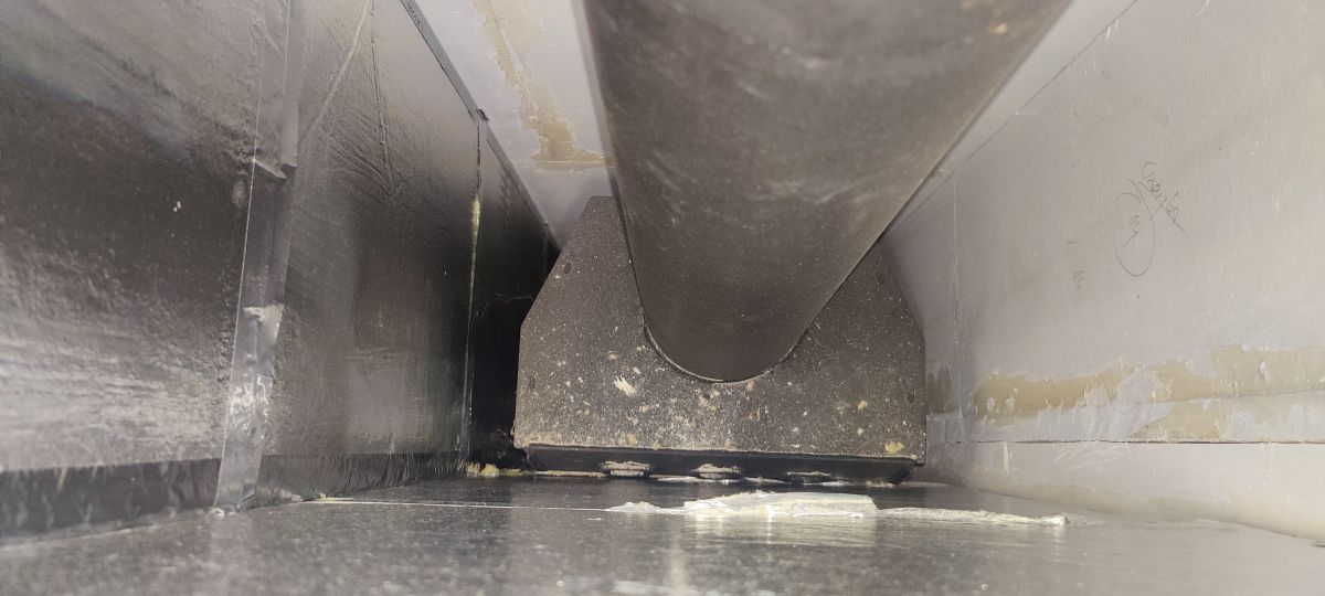

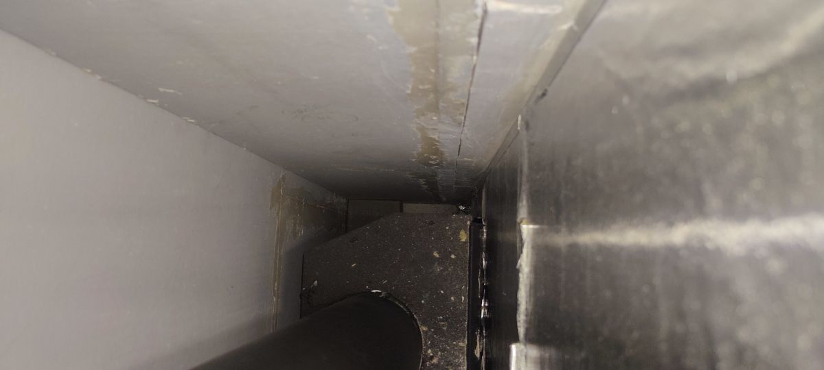

    It is not a smoke smell from the firebox and there is no leakage either, this has been checked many times.
    The chemical smell is coming from the cartridge or the build-up. And this is not in dispute.

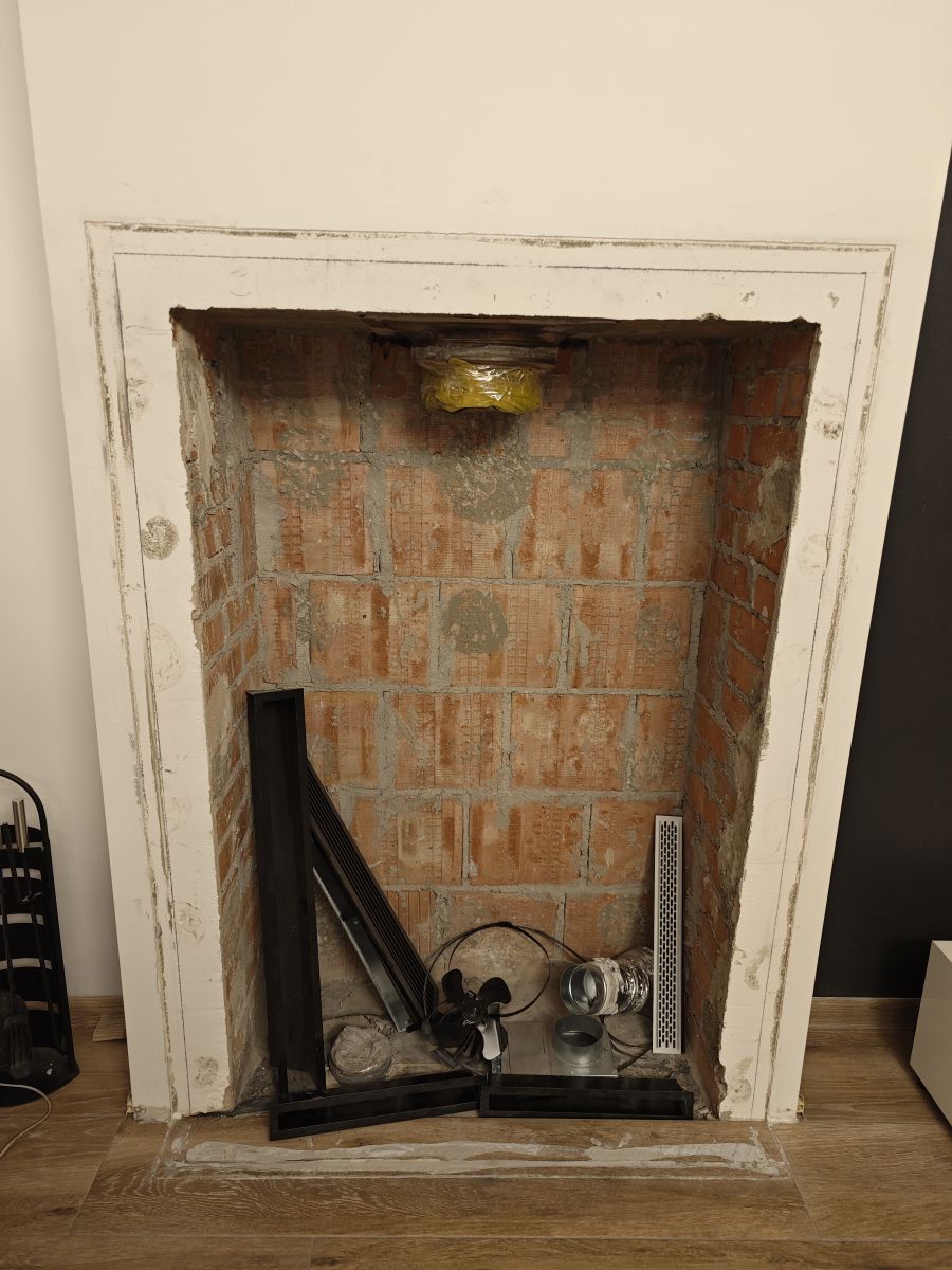

    My fireplace, on the other hand, currently looks like this:
    Interior of a dismantled fireplace with visible ventilation elements and wires. .
    The insert has been dismantled and sent back to the manufacturer for shotblasting. It has to be said that Kratki (the manufacturer) were very helpful in organising this whole process. The shotblasting and transport is PLN800. I am waiting for now.
    After sending it back, I intend to build up the fireplace with Varmsen/Skamol panels, maintaining the required active areas of the built-in ventilation grilles. A similar building, once overheated, will always smell.
    I will let you know.

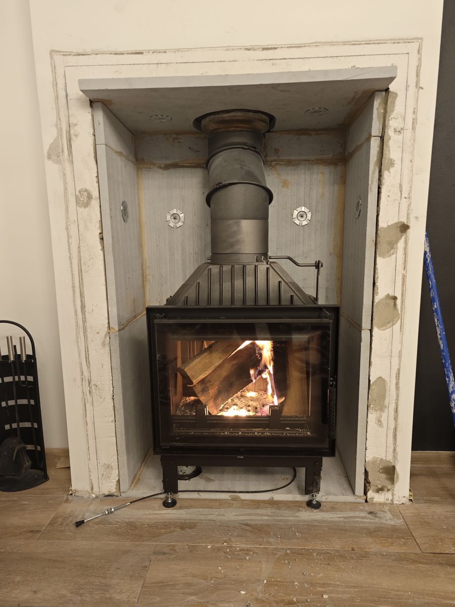

    Ladies and Gentlemen,
    A small step towards success for now.
    I started today to build up the insert after blasting with the Varmsen/Skamol system, but before closing it I lit the fireplace for a test fire:
    Fireplace under renovation with burning wood, surrounded by Varmsen/Skamol panels. .
    Currently the fireplace is spicing up and.... without the biting stench.... Somewhere in the background, there seems to be that sweetish smell wafting through gently, although I'm not sure myself if I smell it or if I have it in my head after 5 years of fighting the problem. But it is finally possible to smoke comfortably :) .
    I used a sealant up to 1200 deg C to seal the flue pipe.
    I'll hold off on declaring success just yet, as I'll declare this one when I've closed the fireplace surround completely, with the intention of doing so with significantly more grilles than I had before.
    The highest recorded temperature in this build-up is on the flue pipe and this is 250st C.
    I'd also like to add that the previous build-up caused a stinging sensation on the skin when stripping - like working with wool. The Varmsen/Skamol boards don't have this effect, so it seems to be a different type of material than I had previously.
    I would also like to add that Kratki, in addition to the shotblasting done, replaced all the seals in the fireplace in the price, I got a new door with new glass, the company also took care of all the logistics of the shipment and overall I feel that I received a virtually new product. I must admit that I am impressed with the level of service.
    I will probably let you know what happens next soon.

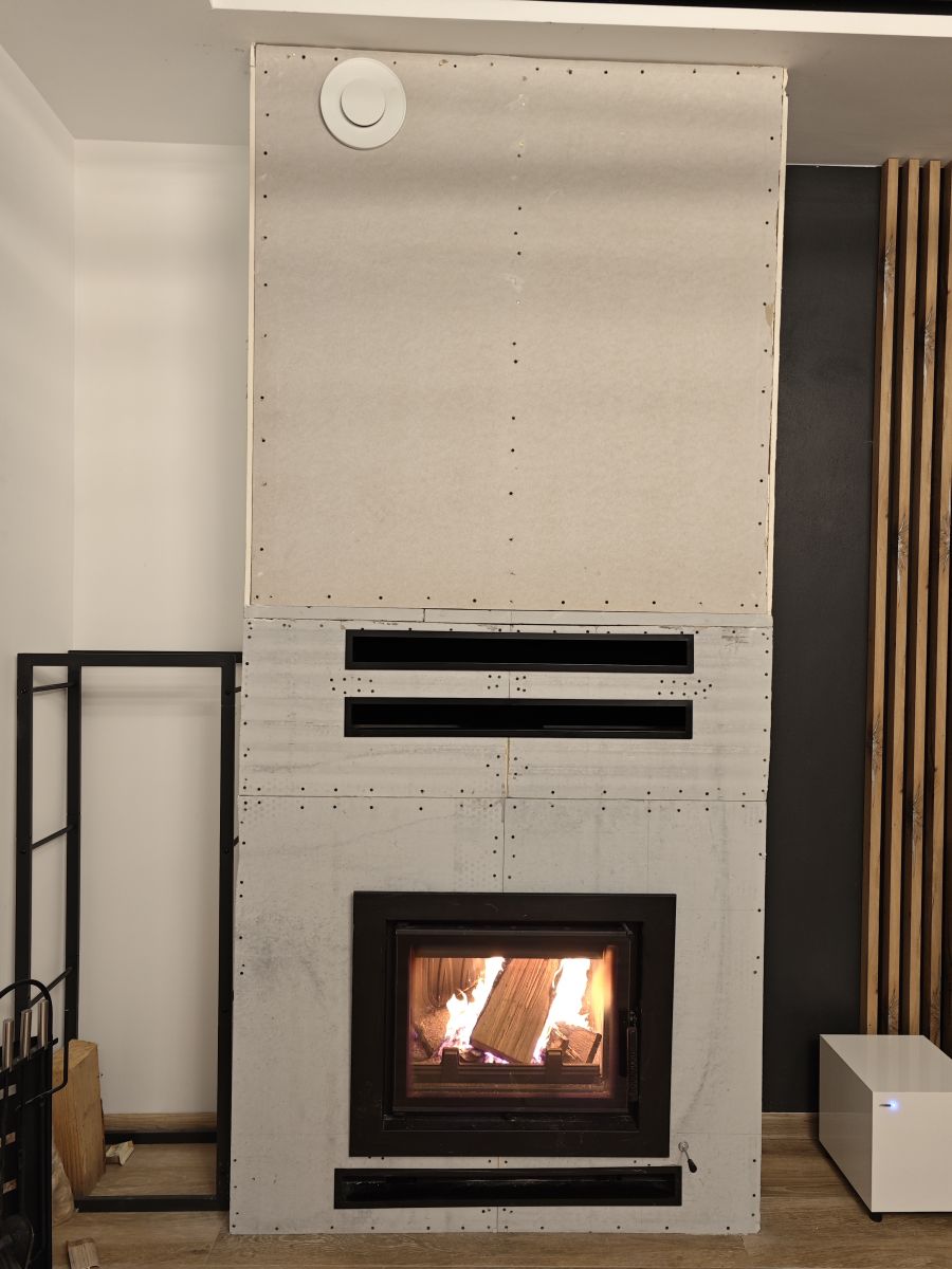

    Ladies and Gentlemen.
    Pre-built fireplace. New grilles inserted, and more of them - although they still do not meet the requirements for the insert in terms of the required active area (700/900 cm2) - but the values are close to the requirements (the grilles are also on the side - not visible in the photo):
    Fireplace with Skamol/Varmsen paneling, featuring new ventilation grilles. .
    For the first time in years I can enjoy the fireplace. :) I'll admit that I personally have the impression that somewhere in the background I gently like to smell the same, although I'm not sure myself, but my wife says she doesn't smell anything, so maybe it's me after 5 years of sniffing that it must smell. Certainly on the second day after smoking there is nothing to smell in the house and no need to ventilate - so goal achieved.
    I am unable to say conclusively whether the source of the smell was the cartridge itself, the pipe or the build-up. At first I was sure it was the cladding, as my "research" in the previous house confirmed, but now I'm closer to believing it was the paint.... Although I don't really know. Someone wrote earlier that the cause in his case was the pipe connecting the insert to the chimney. It's possible - in my case it was hardwired.
    To sum up, I ended up having the insert repaired and blasted by the manufacturer (Kratki) and changing the whole construction to a self-made one using Skamol/Varmsen panels.
    I am not closing the topic yet. I'll keep a check on the fireplace and let you know after the fireplace is finished if anything has changed.
