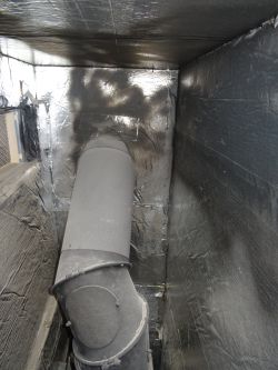

    I have such a problem - when using the fireplace in my house you can smell burning puffs - something more like burned plastic than wood smoke, although it is difficult for me to describe it and clearly state that it is not smoke from the hearth.
    I bought the house second-hand with a ready-made fireplace, so I don't know the technical details.
    At the top of the chimney, I put an insulated meter extension and a fireman to correct the cug and prevent smoke from entering the vents.
    The smell is most likely coming from the hot air vents and sometimes it can be felt intensely on the first floor of the house - it is also clearly warm there from the fireplace, and much less downstairs.
    I opened the grilles today to check if there is any leakage in the flue gas pipe and it is difficult for me to clearly say if there is a leak. There are no 'stains' anywhere, there are black raids which are rather paint applied at the assembly stage.
    I took a series of photos and I have a request for help with the analysis and a few questions at the bottom.
    The appearance of the chimney connection to the fireplace insert - these black raids are something like spray paint - it is not rather a smoke raid, it does not come off when touched with a finger, but can be scraped off with a screwdriver:

    Chimney connection to the insert:

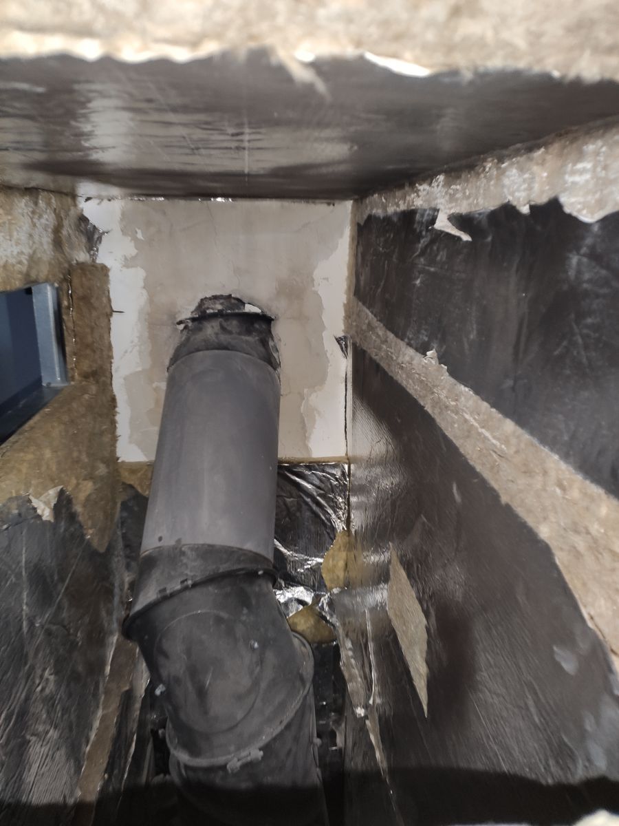

    Fragment of a sooty looking pipe with an inspection window:

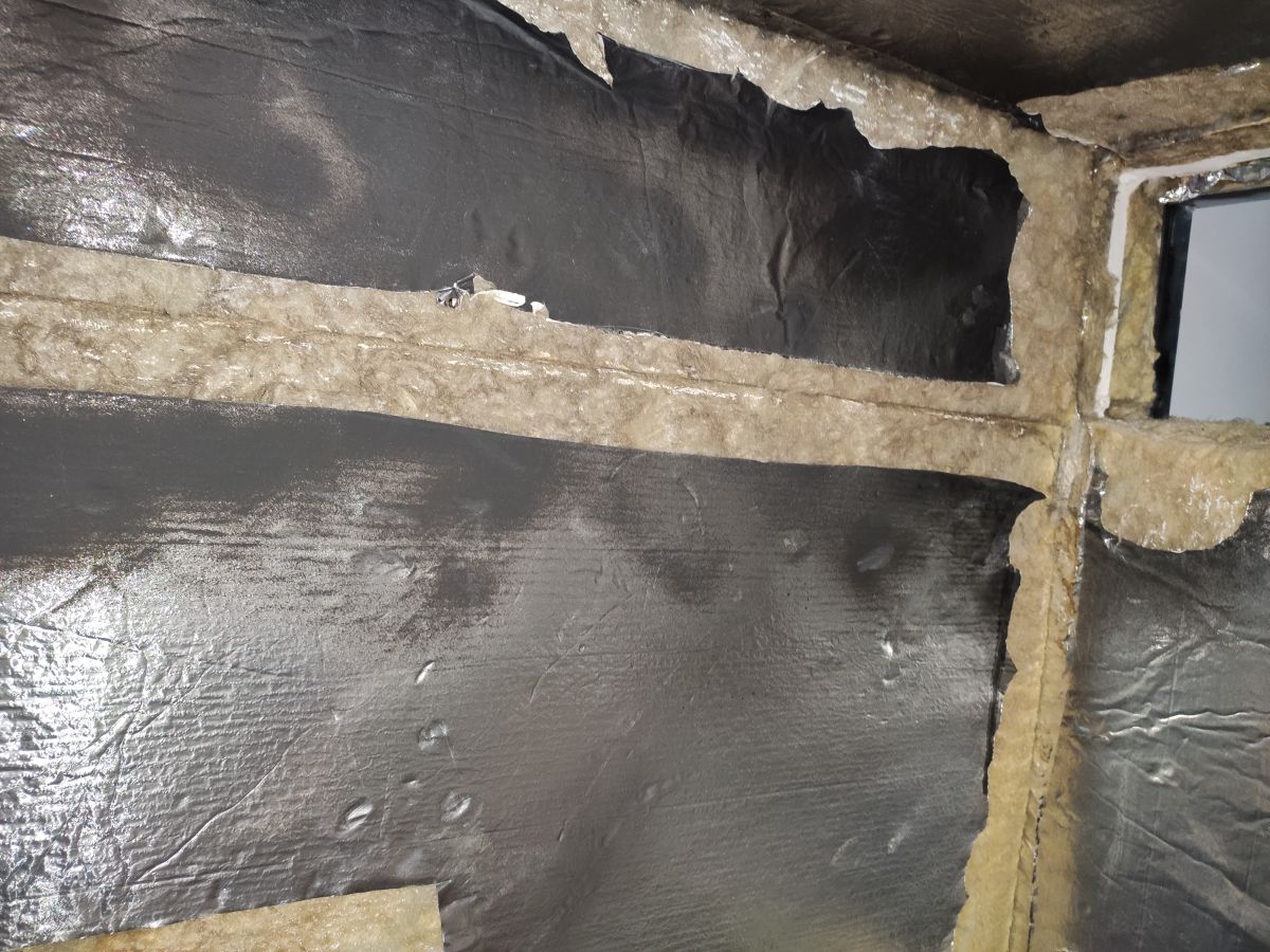

    Once again, the raid on the wall - as I mentioned above - it looks like spray paint, it does not come off when touched, it does not get dirty:

    A fragment of the exposed thermal insulation - you can see that it is 'burnt':

    Sealing or raids on the pipe:
    There is a strange burning smell in the house when using the fireplace
    The last photo, least clearly, from a borescope camera, showing the seal / tarnish on the chimney, at the connection to the cartridge. This white coating is like dust - it comes off when touched:

    I have read a lot of similar topics, but would like to advise someone with experience.
    And the questions are:
    1. Can you find a leak based on the photos?
    2. If it is a leak, is it possible that it is an effect of structural burn-out and will pass over time? The fireplace was hardly used, we smoke sporadically, but so far I have not noticed a downward trend ...
    3. If it is firing the structure, is it possible to do something without dismantling the building and try to remedy the problem?
    4. If it is impossible to do without undressing, then in general - what can be done?
    5. Or maybe do nothing and it will just burn out?
    6. How can I be sure that the chimney is tight? I came up with the idea to put a "disco" smoke machine in the fireplace (the hearth is tightly closed) and watch if smoke is escaping somewhere - does it make sense? The test would, of course, be performed 'cold'.

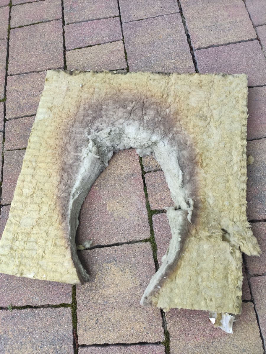

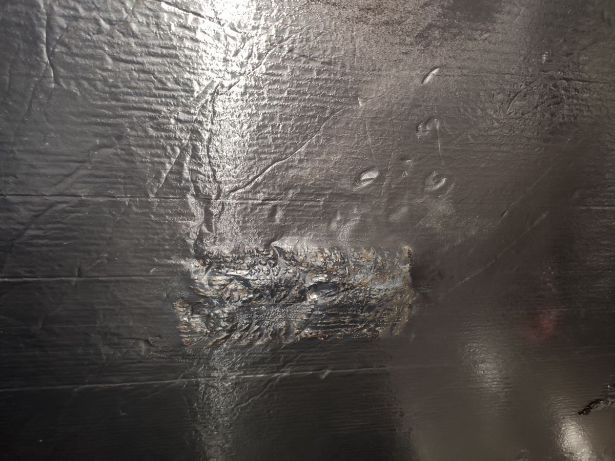

    mateo-salvadore
    Ladies and gentlemen,

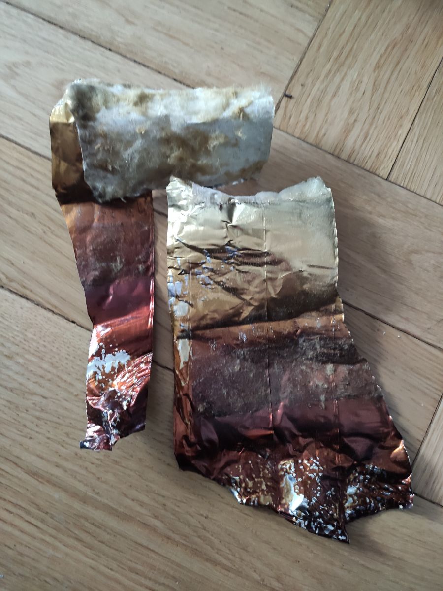

    In view of the vague explanations of all kinds of specialists, I decided to take radical steps myself. So I took the gas burner, took "samples" of the insulation from the fireplace casing and started firing them, checking which material stinks so much.

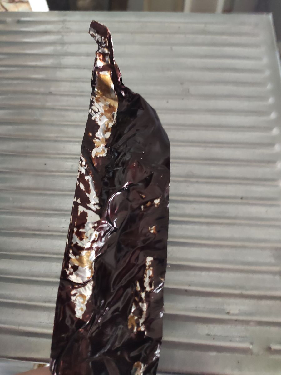

    In general, it turned out that it was ... an aluminum tape, which, at the right temperature, dealt with an intense, difficult to extinguish flame (or rather its glue).
    So I removed from the chamber all the alu tape that I had reached (unfortunately not all) - although earlier I added fresh on the joints, which - as it turned out, had the opposite effect from the intended one.
    I also removed a piece of wool adjacent to the exhaust pipe, the temperature of which reaches 400C during use.
    Visual Effects Below:
    There is a strange burning smell in the house when using the fireplace There is a strange burning smell in the house when using the fireplace
    I know you shouldn't leave "bare" wool, but there is no other solution ...
    It was clearly visible that the glue on the tape was fried, so I cut out all the places where it was left:
    The place where two strips of alu tape were stuck:

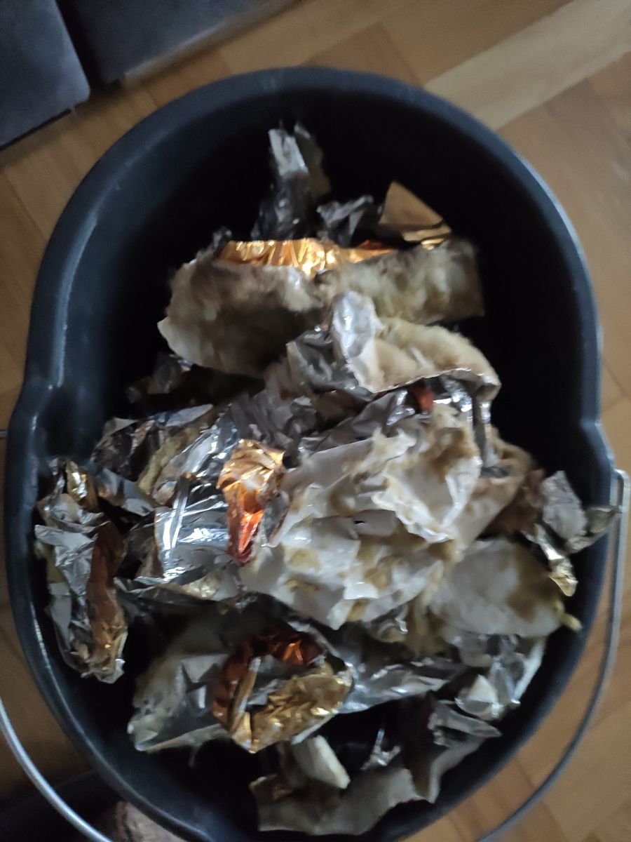

    What's more - the stench of the burned tape stripped from the insulation was the same as what you felt while smoking.
    I dumped a whole bucket of it:
    Also, don't let anyone tell you that the wool does not dust ... a piece of wool removed from the exhaust pipe (some genius stuck it to the pipes with the said tape):
    While the yellow wool is durable and stiff, the white, 'tanned' wool is very 'volatile' and it is dusty with every movement as light as possible.
    Overall effect?
    It is not perfect, because I did not manage to reach the entire tape through the ventilation holes, but at the top, i.e. in the area of the highest temperature, I released all of it, as a result - the stench has decreased significantly.
    This leads to a simple conclusion - how someone wants to enjoy the fireplace - No wool for insulation - only hard, durable boards.
    I am fed up with dealing with this fireplace in general - I plan to throw all the wool from inside first - if I succeed, and repeat the test. Ultimately, however, the fireplace casing will be dismantled and rebuilt with a new, "rigid" insulation.
    I will inform you about possible successes.

  • #27 20295493
    Tommy2022
    mateo-salvadore wrote:
    Gentlemen and Ladies - substantive statements are requested, because you are starting to clutter the thread...
    I will let you know how I finally solve the problem to dispel the doubts of those who have a similar one - breaking through posts describing the same, incorrect or already discussed assumptions will not help anyone find a solution. But if the thread is inundated with the advice I gave myself above - for the sake of order, I will close the topic without providing a solution...
    So far it has been established and not subject to further discussion:
    -Ventilation is not a problem.
    -Reverse draft of the chimney or no draft either.
    - The smell comes from the casing of the fireplace insert - probably from the thermal insulation
    -The plan is that the problematic insulation will be removed and we'll see what happens next.
    Good morning,
    I found your post from two years ago, I would like to ask what conclusions did you come to? Were you finally able to diagnose the "chemical smell" problem? I will be grateful for your response.
    I have the same problem for 6 years, smoked not very often but several times a season, many times quite strongly, the inside of the fireplace before the season is always thoroughly vacuumed and to this day I have not found the reason, maybe because I gave up and just started to smoke less, so as not to warm up too much tight cartridge. But it annoys me that I have to smoke gently and be careful because if not, the whole house smells like chemicals. The neighbor in the house next door smokes to the max, putting in a whole pack of briquettes and nothing, no smell.
    The only advice for a professional who installed the insert and made the building is not to fire up too much and install an additional grille so as to lower the temperature inside the building.
    I have an Arysto contribution, GK construction from the inside of the wool plate on the joints with aluminum tape. It looks just like yours in the photos.
    Based on the analysis of what other people write and my own observations, the only thing that seems most likely to be the source of the chemical smell is:
    - exhaust pipe and all revisions, elbows between the fireplace and the entrance to the chimney, or rather a bad coating that emits this smell under the influence of high temperature or,
    - tapes connecting wool boards,
    - possibly a coating covering the Arysto fireplace insert.
    In this thread Mr. "Roman sz." he just referred to the exhaust pipe and after replacing it the problem stopped, while Mr. (mateo-salvadore) indicates, at least two years ago, that it is most likely the fault of the Alu tape.
    So, I am asking people who managed to solve the problem to share how they eliminated the cause of the chemical smell.
    If the cause was the pipe and individual elements of the flue gas discharge, which company should be replaced to get rid of the problem once and for all.
    Thank you and best regards!
  • #28 20295522
    mateo-salvadore
    In general, I managed to find the cause, but I did not undertake to fix it.
    The reason confirmed by other users, such as us, as well as by a construction auditor, and by ONE specialist in fireplaces (slowly more people are discovering the "advantages" of insulation used by them for years) is the wool used to insulate the chamber above the fireplace insert. Not just tape, but all wool with aluminum foil. The only solution is to dismantle the fireplace, throw away all the wool, clean the inside of the chamber of glue, and build it up again using silicate boards, or leaving only the GK board, which, however, will be considered inconsistent with the art.
    However, because wool is considered to be in line with the art and it does not work - I would not attach myself to the opinion of all these specialists, but at high temperatures the walls will turn yellow and the paint on the wall may start to smell, so it is better to use some insulation.
    I was exhausted by this fireplace, so I just left it as an ornament and I don't use it. If they don't ban smoking in it, maybe I'll come back to the subject someday. However, if you care about use - one solution is, unfortunately, the reconstruction of the fireplace. Not replacing tubes, cartridges or anything else - this very rarely causes problems.
  • #29 20295552

  • #30 20295621
    mateo-salvadore
    I had such a plan to first cut a hole in the current buildings, remove all the wool thoroughly and vacuum the interior, put back a provisionally cut piece of plasterboard and light the fireplace to confirm the diagnosis. If it still smelled - I would replace the entire insert with pipes, and if not - I would cover the whole thing with silicate plates.
