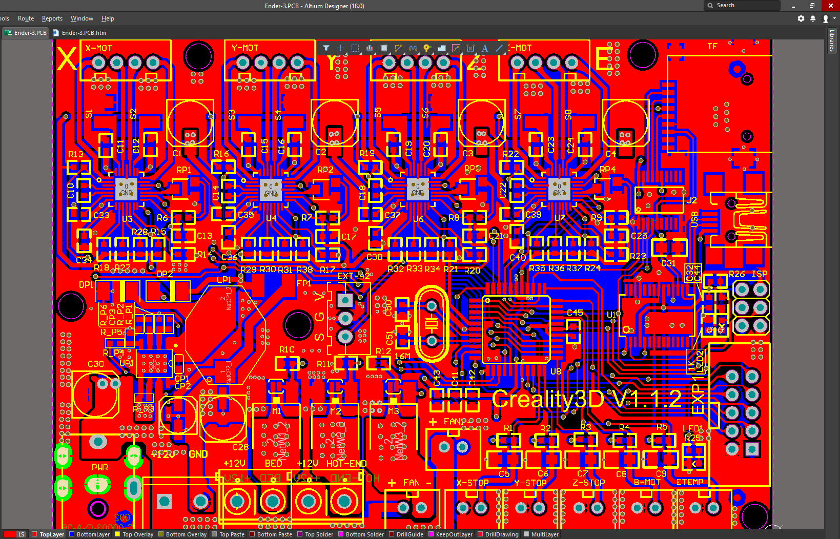

    Hello all,
    I have a problem with the new Creality Ender 3 version 1.1.3 printer. After many struggles with leveling the curved table and reassembling the crooked frame at the factory, I managed to bring it to service.
    Unfortunately, yesterday, during a quick print in PLA, the hotend started to smoke, after opening it, I saw a burnt cotton wool (?) With a kapton, a heating block flooded with PLA with a melted thermistor. It was not a problem because it can be quickly cleaned and replaced, but the fault was the fault of the controller and not the thermistor.
    When turned off and on, it shows a temperature of 162 * even though the block is cold and the thermistor off, in this case it should indicate MINTEMP or MAXTEMP error. The motherboard voltage to the Hotend thermistor is 700mV, and to the table thermistor is 4.7V.
    What could be causing the fault? Defective voltage regulator or Atmega 1284P?
    In the photo I marked the hotend thermistor input Ender 3 v1.1.3 Atmega1284P: Hotend Smoking & Thermistor Issue - Voltage Regulator Problem? Ender 3 v1.1.3 Atmega1284P: Hotend Smoking & Thermistor Issue - Voltage Regulator Problem?

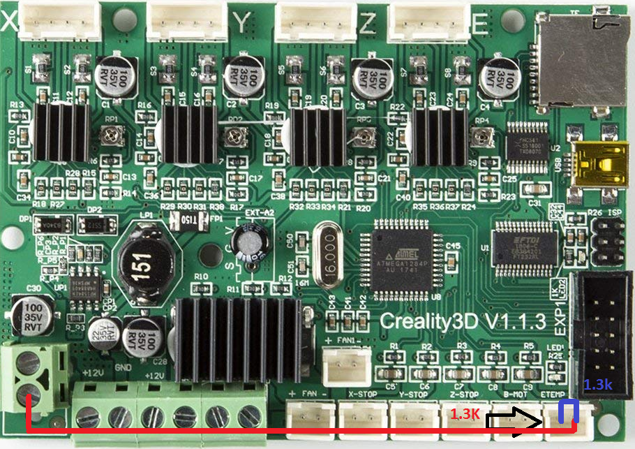

    Before you desolder, check the resistance between the ground and the ADC pin from the thermistor on the turned off electronics.
  • #13 17566583
    Marqee
    Posts: 9
    With 1.30K resistor and capacitor, with 1.18K desoldered. I measured in two ways as in the picture, correct?

    If there is no damage to the PCB, the atmega must be replaced.
  • #15 17635528
    Marqee
    Posts: 9
    Burnt ATMEGA.
