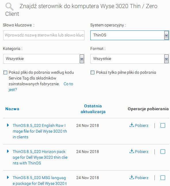

    Borygo123 wrote:
    There is nothing to download on the product page.
    Well, how is it:
    Wyse TXOD Terminal: ISO Image Booting Failure and Default Login Credentials
  • #32 17583111

    I see. I can see why he didn't show me anything (Operating System tab).

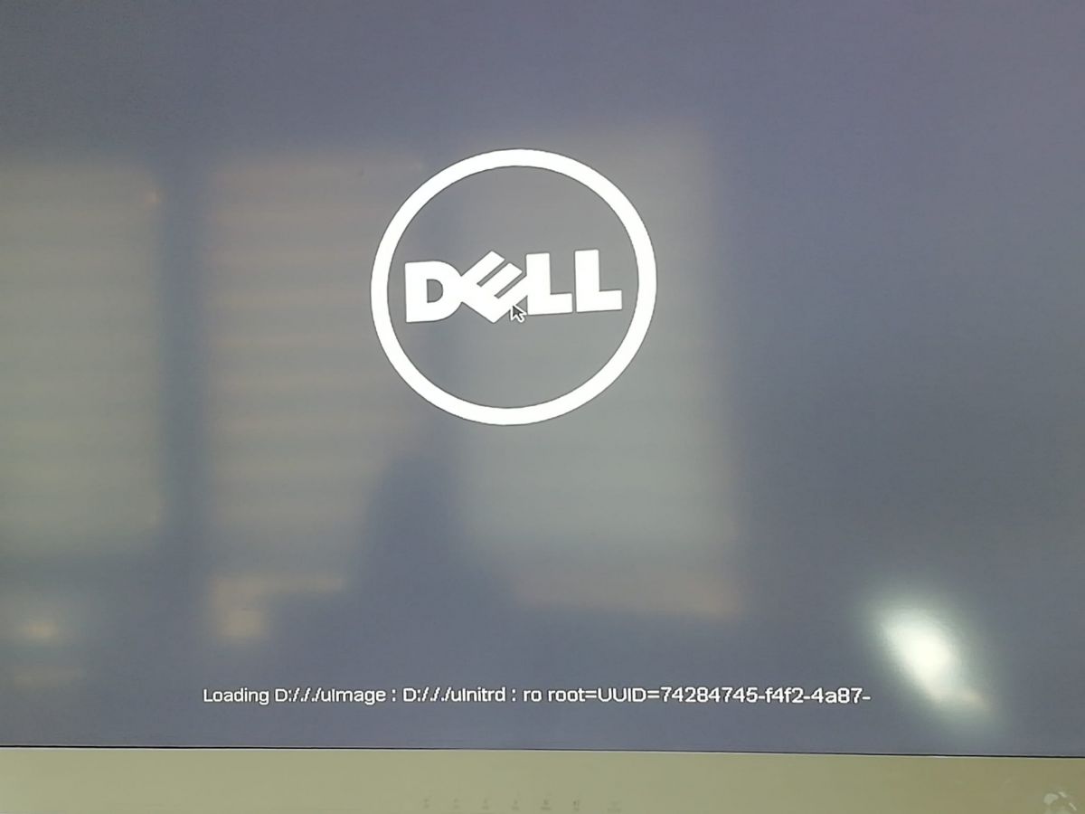

  • #35 20082669
    aylolaylo
    Hi there,
    I just have the same device. Dell Wyse 3020.
    I am trying to follow the instructions from that site, but the system does not boot from the usb. It tries, but then claims something is missing:
    d:/./T10D_wnos
    so it seems that it is looking for the ThinOS to be updated from USB, and does not want to boot the linux :(
    Anyone has any idea on this?

    #36 20123823
    aylolaylo
    Hello again,
    I managed to create the USB for the use of Fedora Linux from the OLPC laptop, following the instructions of https://linux-mmp.docs.kernel.org/dell-wyse-3020.html as suggested before.
    Even though there are some minor errors on that page (p.e. the location of a file) I managed to get the wyse 3020 to recognize the USB and "load" the uImage...but then it hangs with a blank screen. I still have to figure out what the problem is now.
    I put it here, just in case someone else finds this in the future :) Wyse TXOD Terminal: ISO Image Booting Failure and Default Login Credentials
