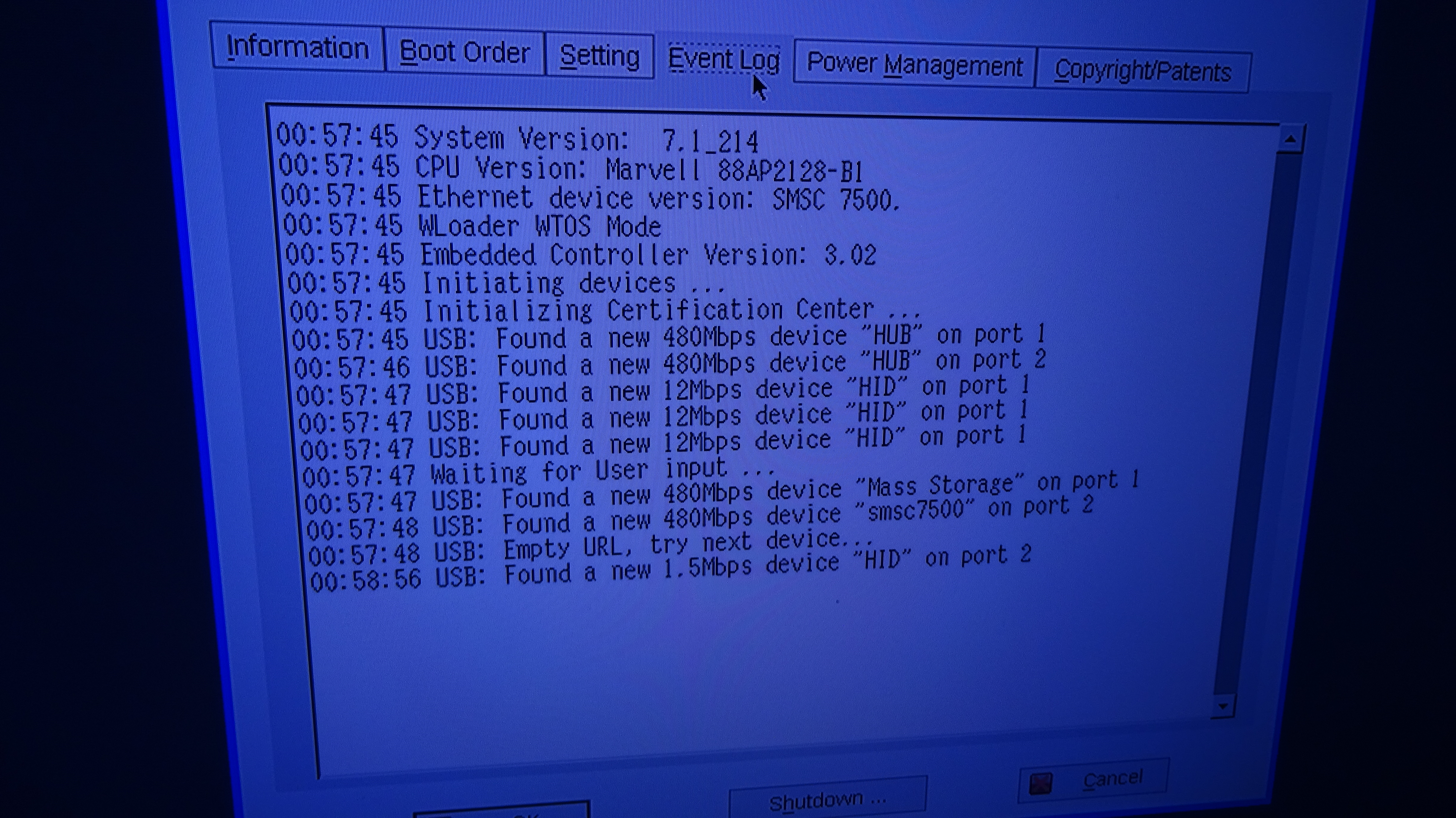

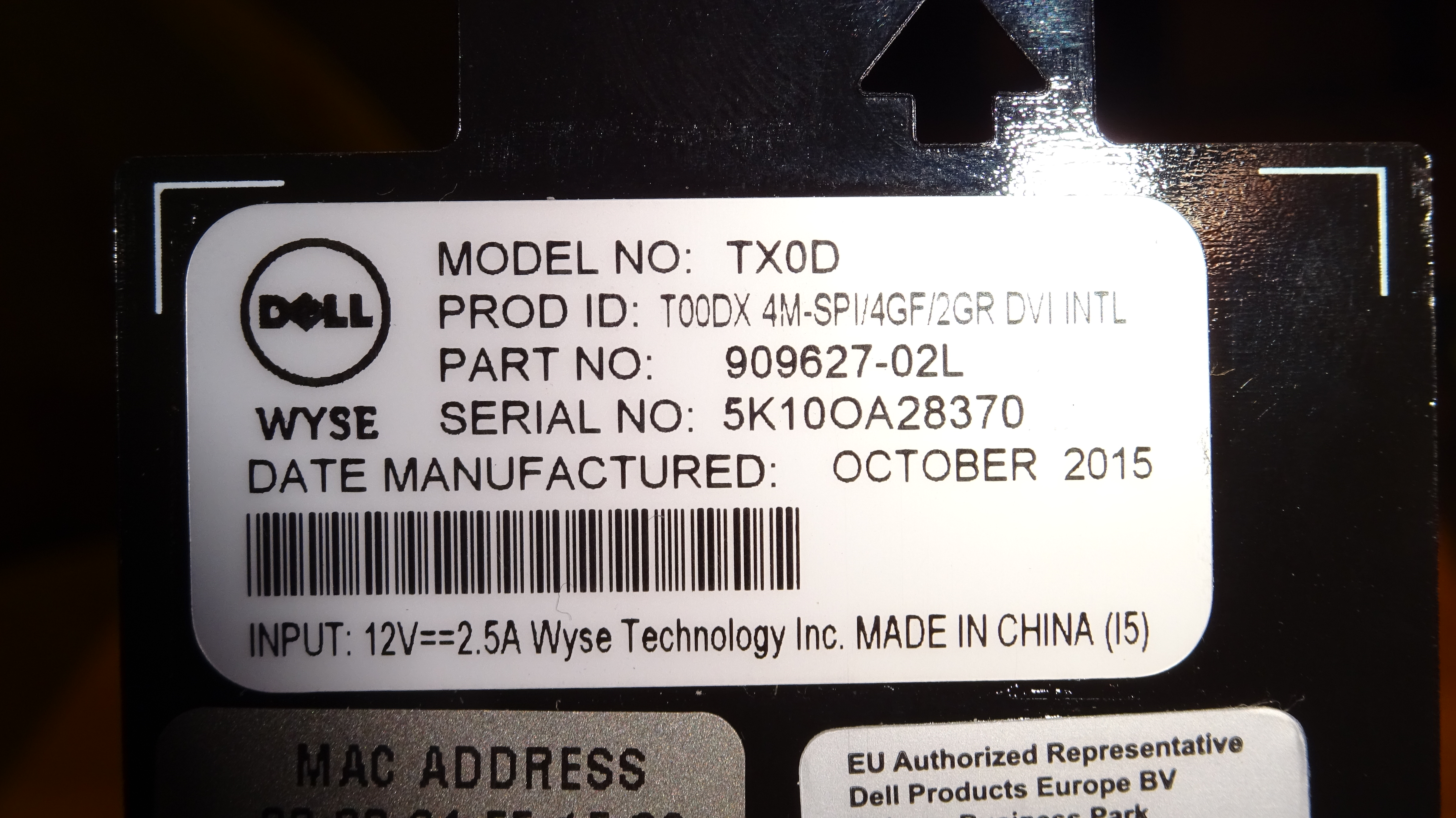

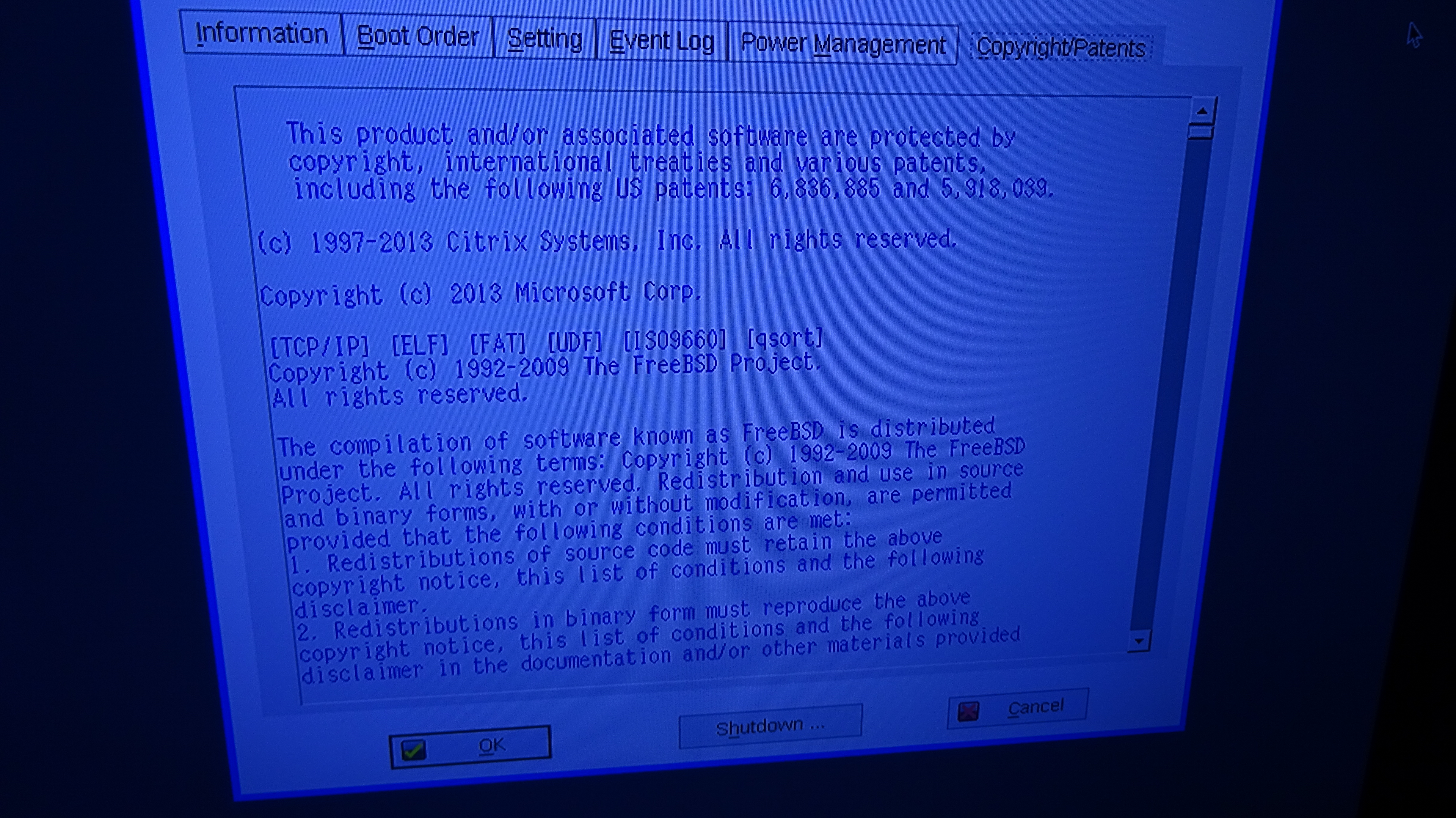

    Hello, I got a new terminal from a friend. You can enter the bios, set up booting, but it does not do anything when I record an ISO image of Linux or Windows on the pendrive using the Rufus program. As if it skips booting from usb.
    The login screen appears on the terminal, but I have no idea how to enter the desktop, I do not know what the passwords and factory logins are ...
    Maybe someone will help?

    In boot order, set the USB to the top. With what you have set up from the flash drive, it will not start.

    Putting the usb on the top doesn't do anything. It skips the flash drive as if.

    It looks like a badly prepared flash drive and the terminal does not read it. Rufus has several options for setting the partitioning scheme. Should work with MBR.

    I formatted Linux in MBR and it hangs for a while on the usb disk as D sees it. But after a while it moves on ...

    These terminals come with different systems (different models for different systems). You have to look for what your system supports and what you can install at least, but in my opinion it is enough to reset it to the factory settings and you will not have to reinstall the system. Here you have a link to various terminals http://www.arcy.com/wyse-thin-clients.html

    Dell - Wyse Xenith terminals for Citrix environment, Wyse 1000 series zero for Microsoft Windows MultiPoint Server environments, Wyse 7000 series for cloud operation with graphics acceleration and multimedia support, or basic Wyse 3000 and 5000 series for virtual environments. Wyse terminals are available with the following operating systems: Dell Wyse Zero Engine, Windows Embedded Standard 7/8, ThinOS or Ubuntu Linux.
    There is Windows Embedded Version in the bios
    On the first bios page, it shows booting from the hard drive, it's hard-set. Maybe there is a problem here, maybe it changed?

    I found out that it has an ARM architecture.

    there is a boot menu and i set usb, it shows usb: \ failure

    Remove this jumper. Also check the battery because it may not hold CMOS settings.

    But what do you want to boot from this USB as it is ARM architecture? You must have a USB loader for the ARM architecture.
    WITH support Dell shows that there are two systems for the terminal - ThinOS and SuSE Linux Desktop 11.
    Maybe try Windows RT 8.1 and SurfaceRT - you can download the WindowsRT recovery image from this MS pages knowing the serial number, e.g. this number 185036524352 is from SurfaceRT and the 3GB image file is SurfaceRT_BMR_20.8.17.0.zip

    comandos21
    Posts: 736
    Rate: 105
    Gelip wrote:
    comandos21 wrote:
    This is how it should look like if the contents of the ThinOS folder on the live are not to be unpacked in the folder?
    Wyse TXOD - Login and Linux or Windows installation
    Rather not so in the catalog wyse you want a folder pkg and files msg_8.5_020.tgz and T10D_wnos
    comandos21 wrote:
    Option54
    -I have to enter my network card from the PC or from the Terminal MAC address
    In the terminal where to enter the IP address (in bios ??) and it should be the IP address of the network card from the PC?
    Don't type in, just choose the IP of the Ethernet adapter. If you have several connections in the system, the program detects all of them, but you are interested in the Ethernet connection to which the cable is connected - in Windows, the default is that the connection is not available if the cable is not connected or the device on the other side of the cable is not turned on.
    I don't know about newer Windows but on XP you can make the connection visible even if the cable is not connected. I need to set the DWORD value in the registry DisableDHCPMediaSense on 1 in:
    [HKEY_LOCAL_MACHINE\SYSTEM\CurrentControlSet\Services\Tcpip\Parameters]
    It will work only after restarting the connection.
    In the terminal, you should enter the address unless in the running system in Central Configuration on the tab General
    Yes:?
    Wyse TXOD Terminal: ISO Image Booting Failure and Default Login Credentials
    As for the Ethernet card, I do not have a PC connected by a cable, only a WiFi card
    Connect the terminal to the wifi router with a lan cable or what?
    For me it looks like this: PC> TP Link network card> Tp link WiFi router

    With this arrangement of directories and files, I'm not sure - check both possibilities.
    You can connect via a router, but better directly via a PC-terminal cable
    Then you set the Ethernet card IP in a different subnet than your LAN has - thanks to this you will not lose Internet connection via the Wifi card and you will have a connection to the terminal via the cable, e.g. the wifi card has an IP from the router's DHCP 192.168.0.2 and you set the Ethernet card manually to 192.168.5.2

    I am not sure if Comandos has downloaded what it should for the right client. There is nothing to download on the product page. Dell wrote on its websites that to download something to WYSE, you need to register with them on the Dell Digital Locker website, add your device and then you will be able to download the software. Free and publicly available WYSE software can be downloaded here https://downloads.dell.com/wyse/ Maybe you will find something useful there.
