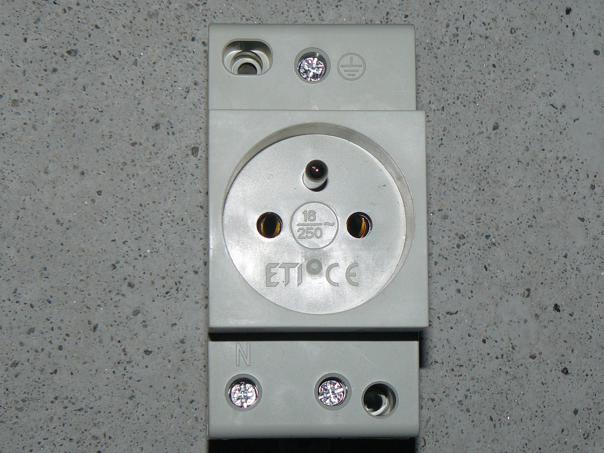

    Neuromancer_Kathar wrote:
    Schuko sockets need not be subject to PN ;) How will it be subject to some DN ;)
    Practically, it does not matter where which page is, but if there is a PN, it is for something.
    Please bardo, the same manufacturer and not schuko:
    Fitters connect sockets in different ways, is it the right one?
    Although I do not know what this designation is for and why only N, but it is and should be respected.

    Łukasz-O wrote:
    Here is the factory socket for the TH bus from ETI with the N terminal marked on the left side:
    Please let me ask a question.
    Isn't this a socket for mounting on a TH mounting rail? And if so, is the description of the terminals not due to the fact that in programs used to draw diagrams of control cabinets (in which almost everything is mounted on rails) each cable connection point must have some marking? It doesn't have to be labeled L and N, it can also be 1 and 2, or a and b.
    Just like the 230V fans installed in these cabinets - they will also work after switching L and N, but there is a description on the cube, otherwise the program will not digest the symbol.
