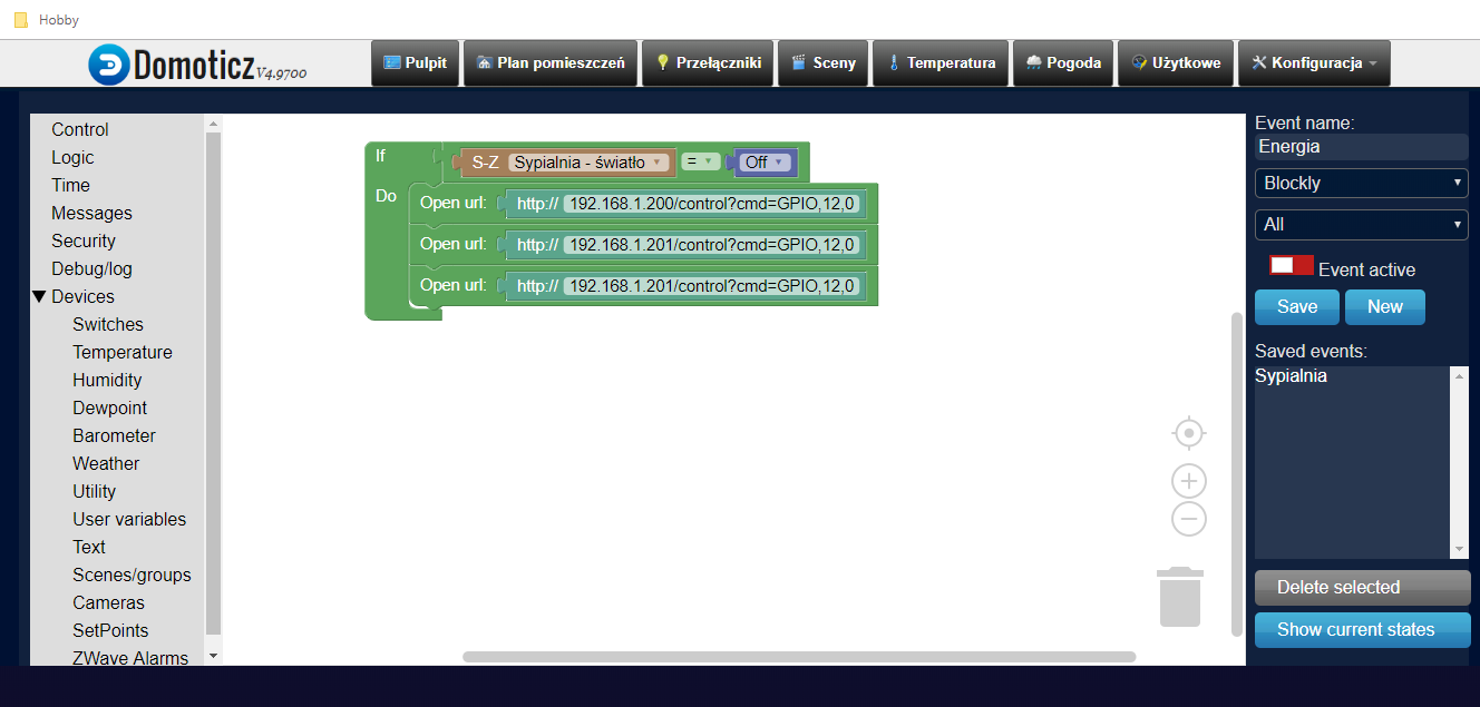

    I have an idea to control 3 relays via Domoticz,
    I was looking for a way in Domoticz to switch on all 3 relays at once, or each one individually, with one press.
    And with one button to switch all 3 off at once.
    I found something like this,
    How to control 3 relays via Domoticz with ESP8266? .
    It works but at any given time I can only fully control: GPIO 14
    and I would like to:
    http://192.168.1.84/control?cmd=GPIO,14,1 + GPIO,12,1 + GPIO,16,1
    What should a correctly written script look like? Or am I doing something wrong?

    You can simply do it like this, you go into Configuration/More options/Events and arrange from the blocks like this :
    Of course, you choose the name of the switch as you have defined at home and the commands in http also your own - here I have given for example. On the right you save as a name and give Event active.
    Standard switch definition :
    The moment you click Off on the switch, the event procedure is executed.
    Greetings
