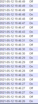

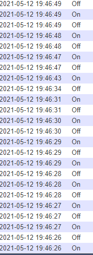

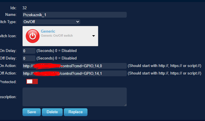

    I wanted to make a relay control based on a board with ESP8266 (nodemcu) with ESPEasy uploaded The relay board is connected with ESP through a logic level converter. Through the command http://192.168.xxx.xxx/control?cmd=GPIO,14,0 and http://192.168.xxx.xxx/control?cmd=GPIO,14,1 I can control the relay and it works.
    The problem arises when I do a Switch in Domoticz, because it can turn on and off twice in one second and so on and so forth :/.
    ESP8266 (ESPEasy) + AVT1666 Relay Board + Domoticz Switch Issue .
    What could the problem be? ESPEasy configured after Domoticz Http

    See in the logs what traffic is generated due to this switch.
    On a trial basis, swap onAction with offAction because it seems to be looping because of this.

    starob wrote:
    Look in the logs at what traffic is generated by this switch.
    On a trial basis, swap onAction with offAction because it probably loops because of this.
    It worked, thanks

    Added after 1 [minute]:
    Changed to try onAction from offAction
