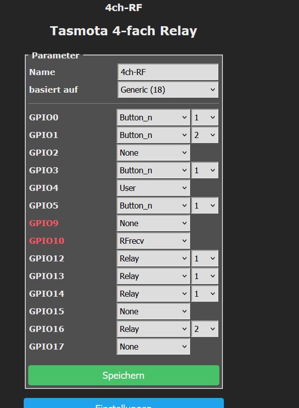

    hope it’s ok to ask for some Tasmota help/ideas.
    Guess everybody knows e.g. the 4ch relay boards available and I like to combine 3 relays at such a board to act as 1 relay for e.g. a 3 phase (3x230V) consumer.
    So 3 relays should be switched on/off always synchronised by one gui button or one command sent by mqtt.
    I searched for a solution and seems that grouping is a method for this, but the documentation says that only 1 relay can be involved in a device group.
    So I tried to map 3 gpios to one relay but this does not work.
    Kindly ask for your help
    Kind regards and big thanks

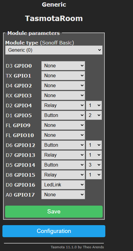

    Are you really sure that having 3 Relay entries with index "1" does not work? That's strange...
    Added after 3 [minutes]:
    EDIT: It seems you are right! It only toggles one relay:
    Tasmota interface with GPIO settings for a Sonoff Basic module.
    Ok it seems we need to use rules?
    Probably Rules can help?
    https://tasmota.github.io/docs/Rules
    Do something like, when switch 1 is on, turn on switch 2 and switch 3. If switch 1 is off, turn off them...
