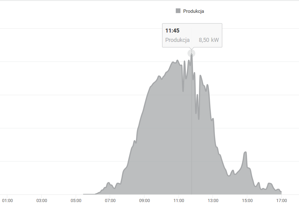

  • #33 17832706
    malak12
    Posts: 11
    Rate: 16
    I reported 10 kW but I have so much installed, the remaining 2 kW maybe in a month. They came, changed the meter and went after 15 minutes, nothing interested them.
    I've been playing with it for a few days but today at its peak it was over 80%.
    I have it on the ground, you know, this is the best form of installation.

  • #34 17835058
    gaz4
    Posts: 4992
    Help: 77
    Rate: 2982
    At what angle is it mounted?

  • #36 17847805
    malak12
    Posts: 11
    Rate: 16
    Cat 30 a few degrees. With the moment that he was doing 9.5 kWh, the pge meter recorded 7.5 kWh of energy, the rest went to the house right away.
    For 11 days of March, I consumed 450 kWh, gave 208 kWh, used 65 kWh. This more or less corresponds to what the inverters give and the pge counter. Because apparently their counter should be programmed in such a way as to rip off prosumers
