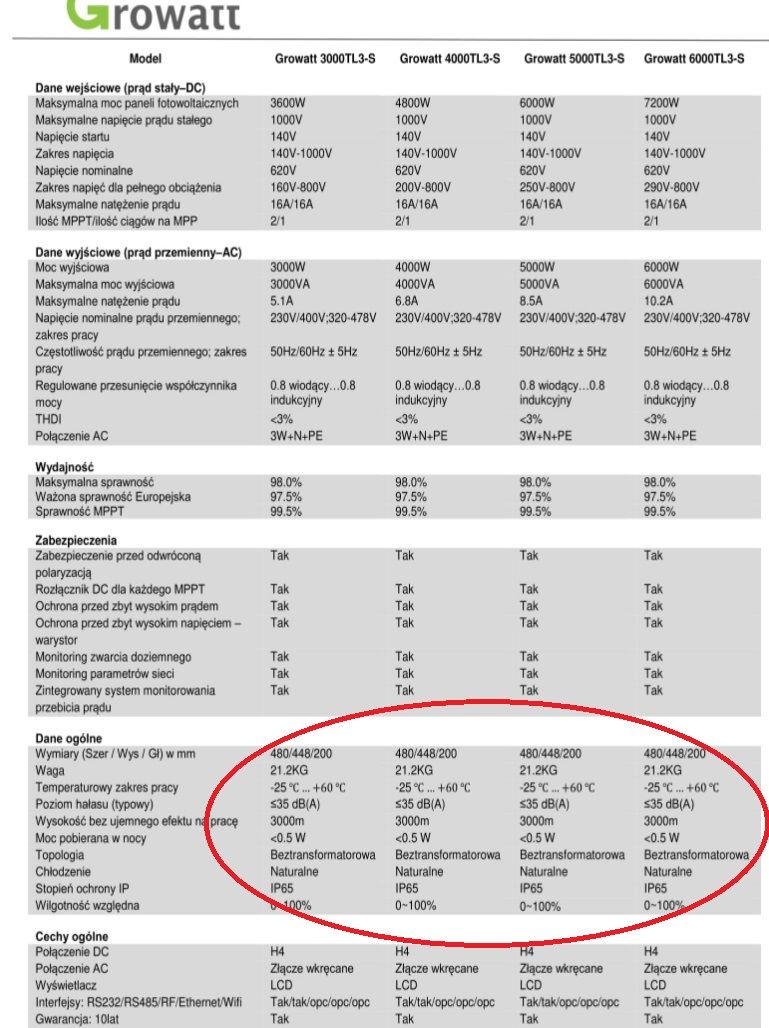

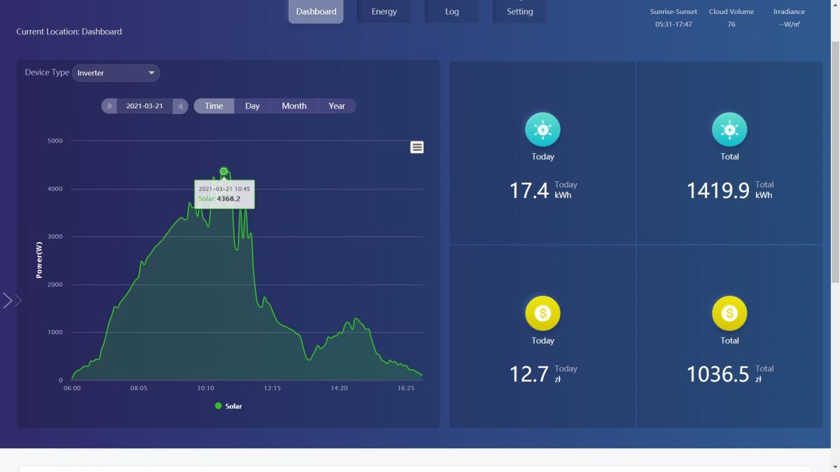

    I have this problem too I would like to add one or two panels. I have 13 panels 340w total 4420w facing south. growatt 4000 tl3-s inverter.
    I will add that the inverter allows more ac production power
    I give today's production and maximum production capacity.
    Expanding 14x310Wp PV System with Fronius 4kW Inverter: Adding Two Panels - Options & Solutions
    If I add 1 or 2 more panels, I have to report it somewhere or not, it has a contract with PGE.
    I wonder when the inverter will stop today it showed 4368w. and the max power is 4000w.
    But in the specification 4000 tl3-s to 6000 tl3-s have the same weight and other parameters.
    I think it's enough to just move somewhere in the advanced options growatt. Only I don't have access to it.
    For now, the graph has not flattened out at noon, that is, it does not cut off the power.
