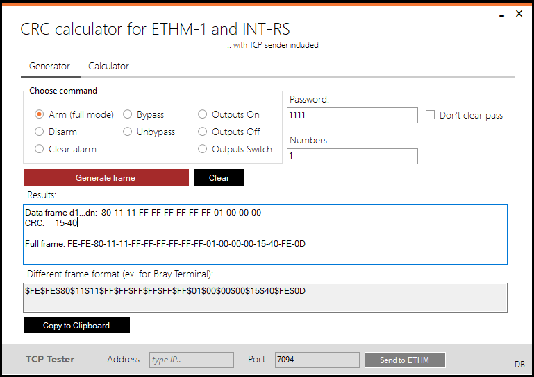

    On the integration itself: true, there is an integration protocol available on the Satellite side. It enables system control and, more generally, full management.
    You should write a TCP client (we are talking about your own apps), because ETHM-1 will act as a server here.
    Of course, instead of writing a program, you can simply insert a ready frame into ethm, which, for example, will turn on the control panel output and then this output will violate the input internally (the protocol does not allow for input violation). So writing a program or any code is not necessary, as long as the camera has the ability to send a frame to a specific IP address and port when an event occurs. Such a possibility is offered, for example, by HomeCenter2 from Fibaro.
    And is there a camera on the market (at a good price) that does something like that? I don't know, personally I don't.
  • #10 17670577

    If a colleague would find such a camera, then in the attachment there is a program that can be used to generate such frames.
    Satellite Integration & IP Cameras: Zone Violation Alerts, ETHM LAN Connection & SD Card Recording
    • CRCforETHM-1.exe (1.06 MB) You must be logged in to download this attachment.

    After entering the password from the keypad and generating the frame, everything works great. Now it's just a matter of finding a camera that can do it and the solution is ready.
