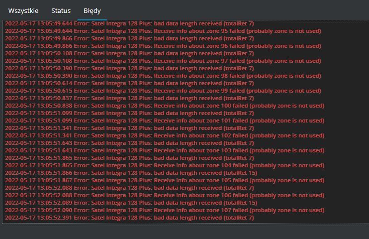

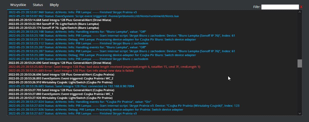

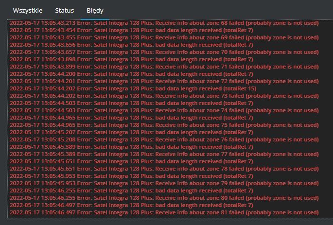

    I have an Integre 128Plus connected via an ETHM 1 Plus module to Domoticz which is on an SSD from a Raspberry.
    Everything seems to be working it transmits input and output states but as you can see below I have daily errors in the logs. Sometimes I observe that the state of a detector is not transmitted properly and for example Domoticz does not turn off the light in a particular room.
    What are these errors caused by ?
    Log errors when connecting Domoticz to Integra 128Plus via ETHM 1 Plus on Raspberry SSD .
    Domoticz updated to the latest version.
    Integra board updated to latest version.
    ETHM 1 Plus module updated to the latest version.

    Errors like "probably zone is not used" are normal behaviour when starting the plugin and scanning the control panel. After that, they should no longer show up until Domoticz or the plugin is restarted.

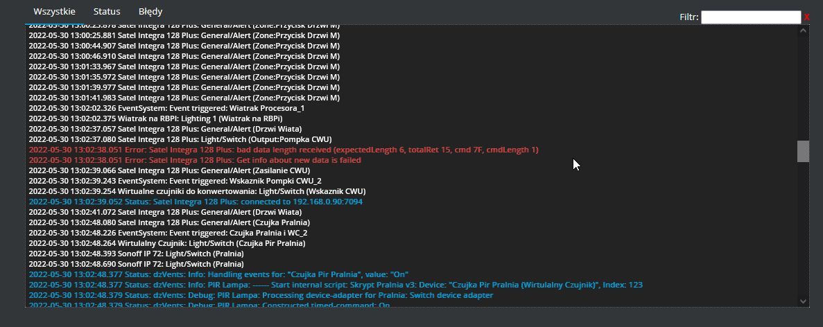

    I get errors every day.
    Today they also showed up. Log errors when connecting Domoticz to Integra 128Plus via ETHM 1 Plus on Raspberry SSD .

    Yes - this first error is nothing to worry about. During the first start-up, I scan what zones there are. ETHM1 does not, however, return a list of used ones, so I check all of them and store the ones that are used.
    So in total, every time the module is restarted, it will run again (but only once).
    If you say that it flies several times a day, then show the logs from the moment when these errors start flying - which is a few lines above. Because something is going on there (module or domoticz restarting?).

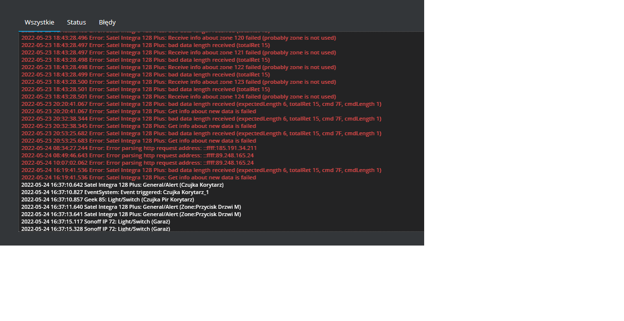

    Well, not really - this indicates a reboot of the domoticz or satel module.
    That's why we need the logs a few lines above, from the moment when the errors start flying again.

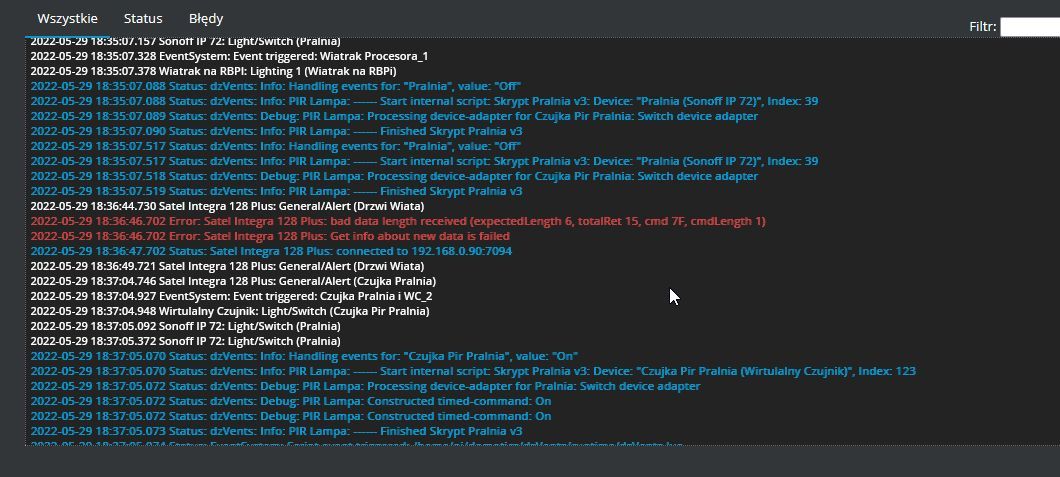

    I have just picked up one error during normal operation.

    This error also occasionally happens, and I could be wrong, but it could be related to the checksum count when, in an extremely rare situation, one of the bytes of the crc checksum has the value of synchronisation byte 0xFE.

    It is difficult to say.
    I need to get the string that was returned to such an erroneous log. That would tell more why it happened.
    ps. Unfortunately my last attempt to compile domoticz failed :( .

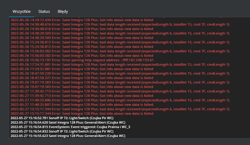

    I've been watching what's going on with my domoticz control and I've had two situations I enter the vestibule the detector detects movement and the light didn't come on. The second time the detector detects movement and the light went so I immediately ran to the computer and took snapshots. In total, I had two such instances within a few days. I am uploading the snapshots.

    When I manage to compile domoticz, I'll add to the logs what frame comes back in case of an error - we'll be able to work out what's strange.
