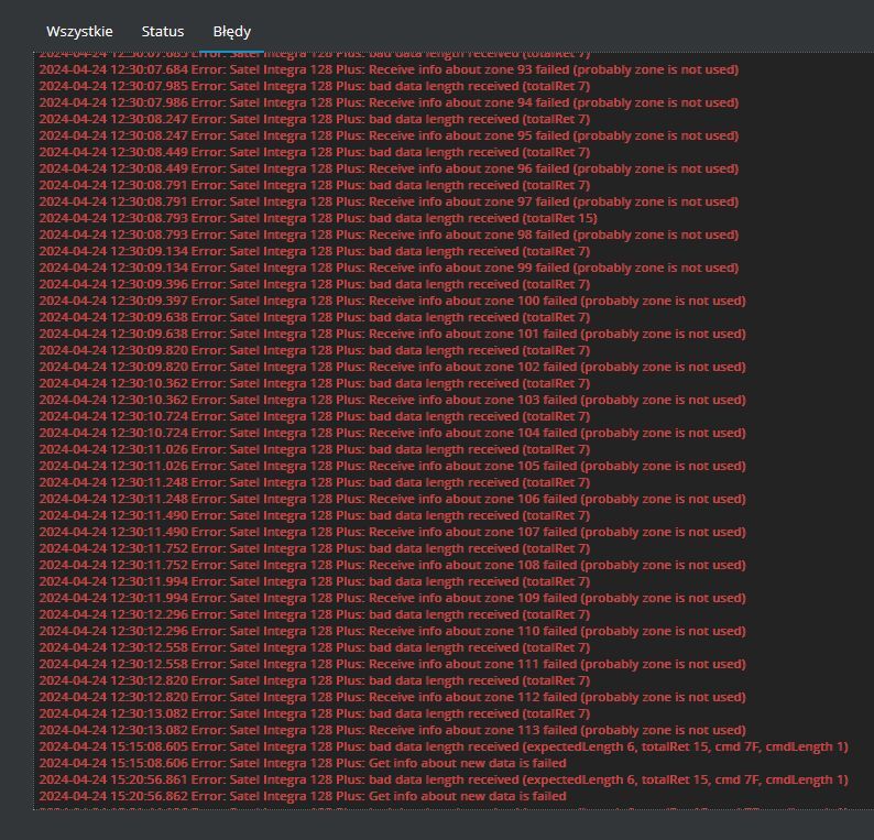

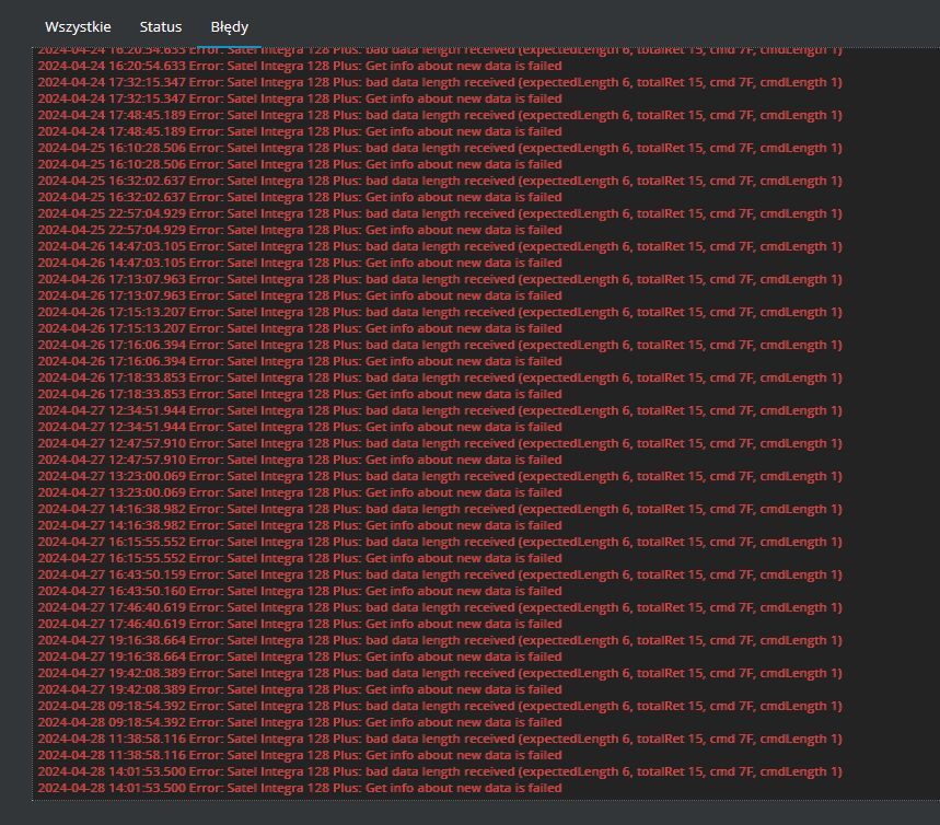

    Or maybe there is something wrong with me and that is what these errors are from:
    Screenshot showing a list of errors in the Satel Integra 128 Plus software with the date and time of each event. .
    Screenshot of system errors for Satel Integra 128 Plus.

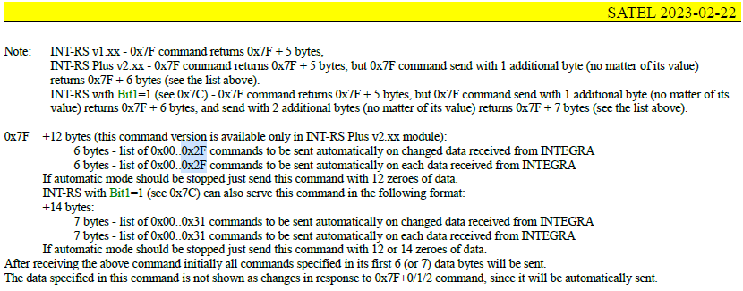

    7F command returns 13–15 bytes in latest docs
    #12 21063383
    szczukot
    Posts: 827
    Help: 6
    Rate: 83
    Hmm, I used to add this info in the errors so you can see a bit of what is flying. This 7F command should with ETHM return 5 or 6 bytes. And here as many as 15 are flying in the response ! That is, with the beginning and end of the frame and with the CRC as many as 21.
    ps. I just downloaded the latest documentation, and there were some changes. They write that it can return 13 or 15 bytes (instead of 5 or 6) as I understand correctly.
    But I'm not sure if I understand :) I don't even understand if these are bytes sent or received.
    Screenshot of SATEL documentation regarding command 0x7F for INT-RS and INT-RS Plus.
