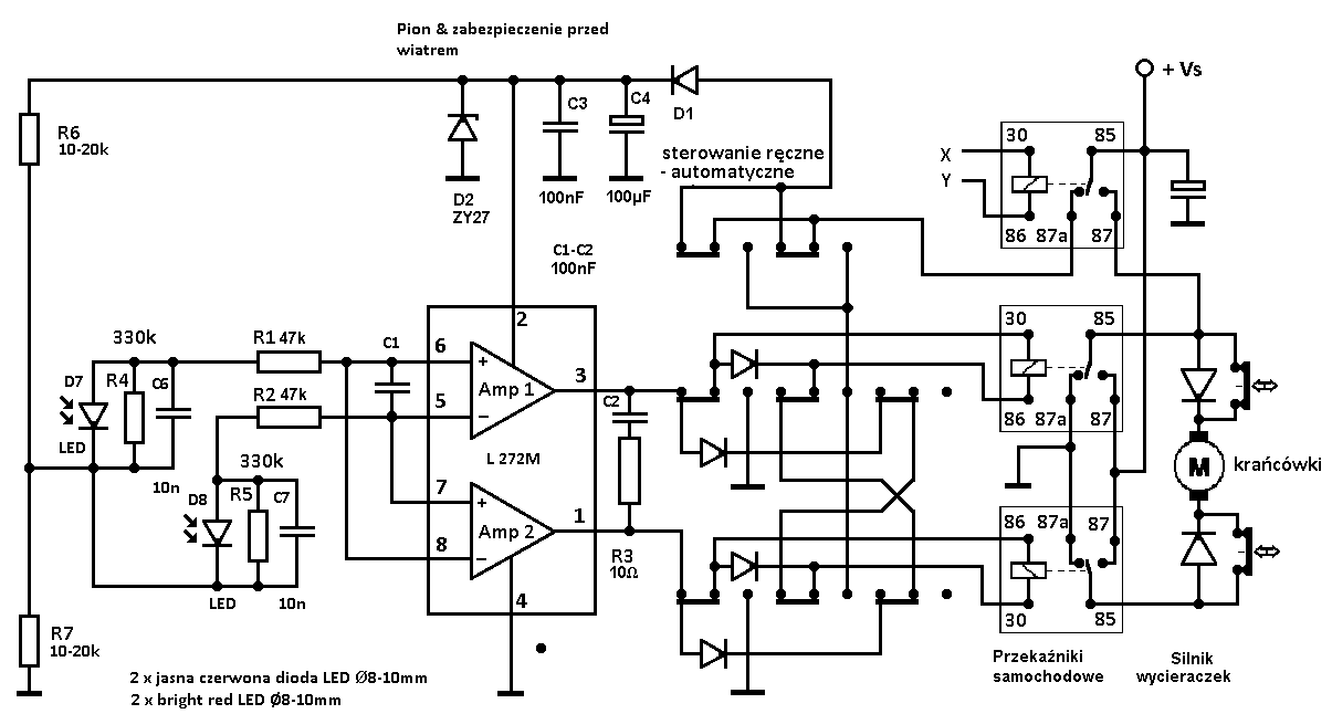

    I present a diagram of a solar tracker based on the L272M chip and bright red LEDs. The system worked when the LEDs were open a small angle and constantly illuminated by the sun. It also responded correctly when the LEDs were soldered straight and covered with the diaphragm. If the LED was coming out of the shadow, the wiper motor was turning in the right direction, if both were in the shadow it was standing.
    The version with an H bridge on car relays has been tested by me in a spider mount. The relay consumed a current of 120-140 mA. L272M is a double power operational amplifier according to catalog notes with a load of 0.7-1A depending on the manufacturer. I found it in the motor of the headlight adjustment motor of cars, VAG flu from the 90s, produced by Bosch. There he acted as a DC motor driver. There are TLE4201 - 4206 chips in Hella motors. I burned TLE4201 during tests. I had only one motor with TLE4201 among 6 bought on the road for PLN 25. Both types of integrated circuits are suitable for this solution, the only difference is the housing - the L272M is smaller (DIP-8). I was dealing with the headlight adjustment motors because they are some servos and I was going to use a similar solution for horizontal rotation of photovoltaic panels. At the moment it should be 90% successful. The control will be a clock mechanism using a servo built on the above-mentioned operational amplifier. I am going to receive feedback on the rotation by means of the vertical Żuk rear bridge, which was left to me after the construction of the tractor. https://www.elektroda.pl/rtvforum/topic1352007-60.html#7700395
    According to the presented diagrams, the solar tracker would control the photovoltaic panels only in the vertical axis. Which does not disqualify it from being used in both axes - I hope so. I used the L272M because its outputs can be used to control the H-bridge with car relays, which in my opinion greatly simplifies the design. Very few components are needed, and the system does not require any adjustments. Currently, I have little time and I am more concerned with the mechanics of my turntable. Before this solution was created by trial and error, I made a few prototypes. I even checked the 40-year-old solution, which was developed by Jeff Damm in 1978, then the reworked scheme was included in Nowy Elektronik 4/2004 (with a mistake). The problem was with alignment. https://www.freeenergyplanet.biz/homemade-windmachine/an-active-solar-tracking-system.html

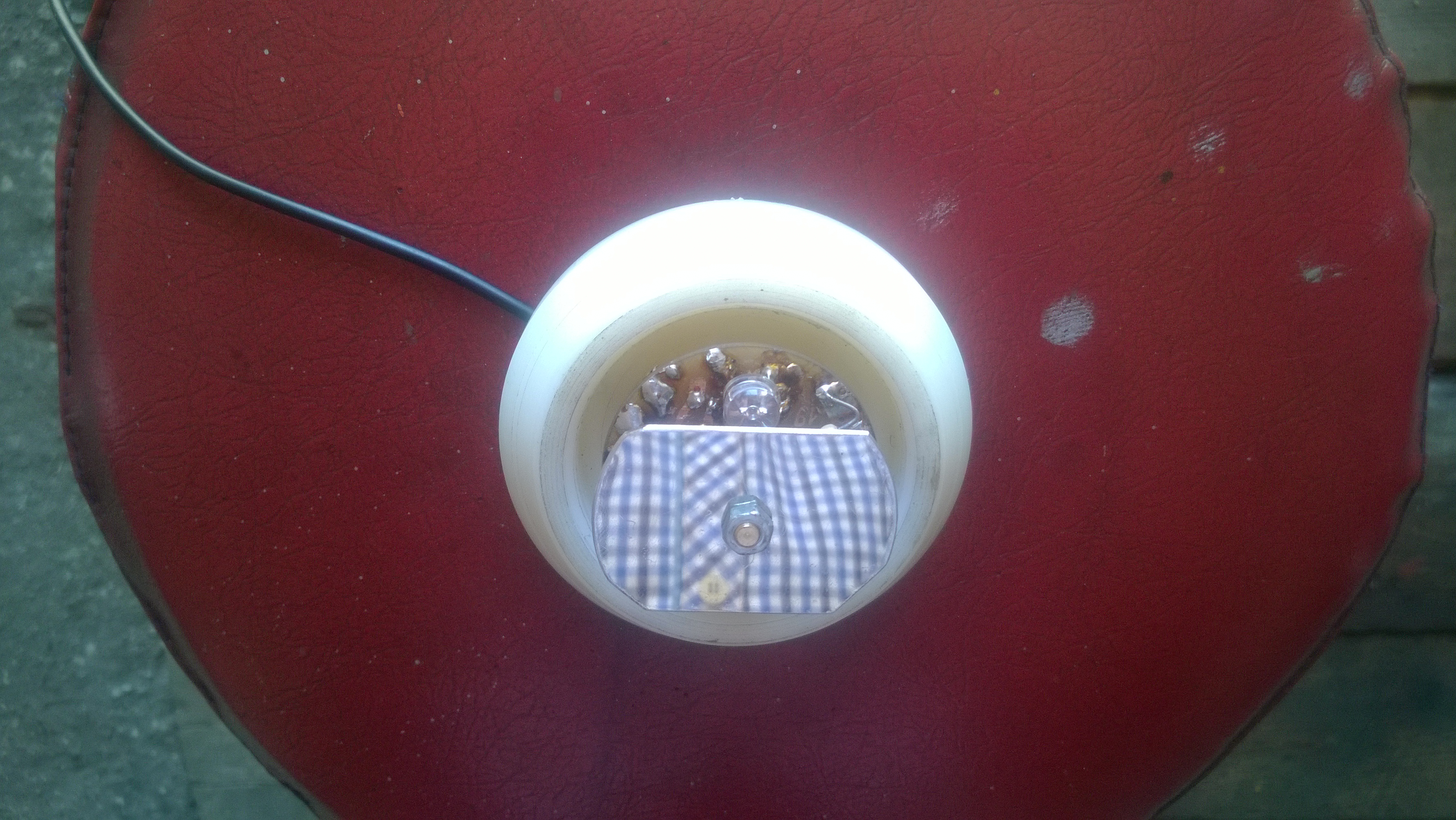

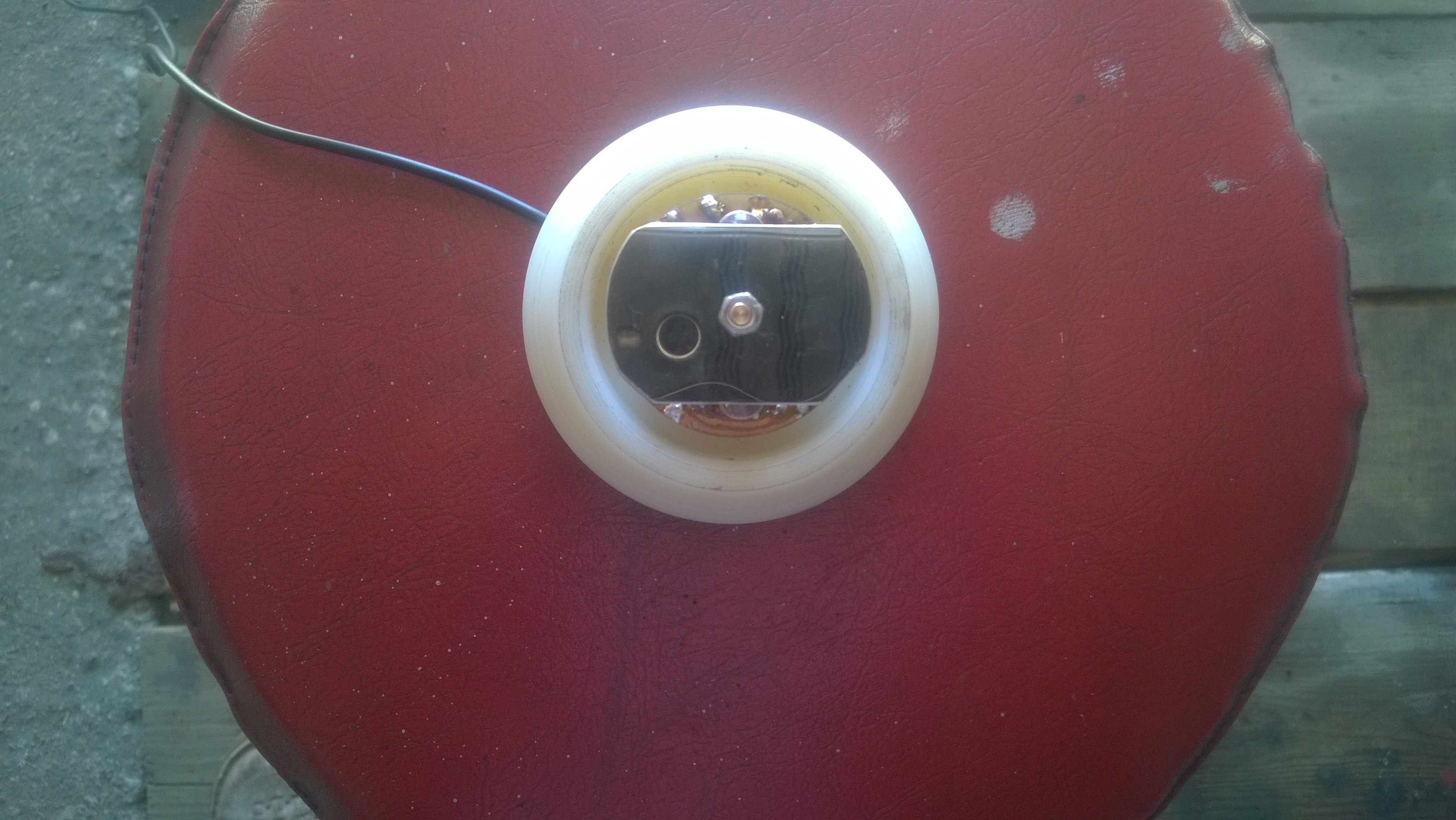

    I mobilized a little and rummaged in the boxes. This is how my prototype "spiderwebs" look like. I am going to close the electronics with the integrated circuit and the sensor on the LEDs in a glass jar of some wife's cream. It had a single-turn thread, so it was easy to add a nut.
    Simple solar tracker on the L272M for controlling solar panels. Simple solar tracker on the L272M for controlling solar panels. Simple solar tracker on the L272M for controlling solar panels. Simple solar tracker on the L272M for controlling solar panels. Simple solar tracker on the L272M for controlling solar panels.
    This is how the bulb from the workshop lamp works. The wiper motor comes from the Golf 3 and required a bit of preparation - it was two-speed, as is the case with the motors from the FSO 1500, the Polonez.

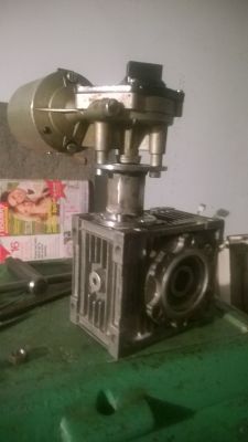

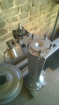

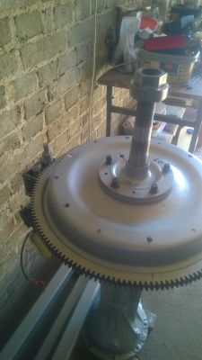

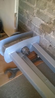

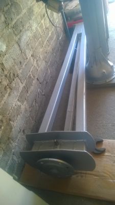

    Gentlemen, how do you solve the installation of the pinion shafts to the tapered and inch threads in the wiper motor?
  • #7 17719881
    heniek07
    Level 21  
    Posts: 432
    Help: 29
    Rate: 221
    I am posting a few photos, they should brighten up a bit. There were sleeves with Polish engines, because the engines come from withdrawn hospital equipment and not from cars. One seemed to be controlling the patient's bed cushion, the other one was controlling a pump. I drilled the nuts for the horizontal controls. As you can see, not all of them were successful - the best one was chosen. The angle and the hastily constructed knife from the drill are in the photo. By turning at an angle, using the manual feed of the post, you can similarly clamp what you need. The fact that a replaceable gear is mounted on the engine is an unfortunate accident at work. When making elements for the worm gear intended for vertical control, I chose the hole for the shaft and used the made element at the engine. I rolled it over and put it while hot on one of the aforementioned sleeves. In this transmission, I wanted to have the possibility of interchangeable gears to experimentally check which would be better, after all, all this is a prototype. Best regards, I wish you fruitful work and as few mistakes as possible. :D
    Simple solar tracker on the L272M for controlling solar panels. Simple solar tracker on the L272M for controlling solar panels. Simple solar tracker on the L272M for controlling solar panels. Simple solar tracker on the L272M for controlling solar panels. Simple solar tracker on the L272M for controlling solar panels. Simple solar tracker on the L272M for controlling solar panels. Simple solar tracker on the L272M for controlling solar panels. Simple solar tracker on the L272M for controlling solar panels. Simple solar tracker on the L272M for controlling solar panels.

    The circuit with MOSFETs when switching will make short short circuits of a few microseconds due to the activation of all four MOSFETs.

    heniek07 wrote:
    Buddy Jarek, thank you for your interest. Please do not be offended by what I write. Your post did not help me, I do not expect such help.
    I wrote to let you know that such a problem exists, that when you power from a power supply with a current limitation, it is ok, but the power supply from, for example, a car battery may cause damage, because a very large current flows can cause EM interference to nearby devices, you can also expect power surges when the transistors will interrupt the short-circuit current, the most popular solutions are timing circuits delaying the switching on of the transistor and only switching on, the solutions I can quickly come up with are not as simple as you would expect.

    heniek07 wrote:
    I did not make experiments. Today I measured the voltage at the outputs of the amplifiers, when the engine is not working, both are 12V. For the H-bridge with MOSFET, this is hardly advisable.
    Not true, it is correct, the motor has 0V whether it is 12V and 12V or 0V and 0V

    Quite complicated like this bipolar circuit, when I "stuff" so many elements, it is usually due to the need to solve many technical problems, and what problems did you encounter?
    In this case, the appearance of two zeros on the outputs of the amplifiers will destroy the transistors, you would have to be sure that such a state will never happen.

    Thanks boys for your interest. The states are normally high at the output of WO. Two zeros do not appear simultaneously. A single zero always appears at the exit of one of the WO. I stuffed two transistors in the control to control the zero, the high-state H-bridge found on the net. Will I check this project - implement it - I do not know. I created this whole topic just to make things a bit confusing. It certainly works on relays, which I checked in the early spring of last year. The only thing left for me is to connect the bridge control (no matter what it is made) with the twilight switch and switches for manual control. In the version for the horizontal axis, the turntable will return in the morning. Thanks again and best regards. :D

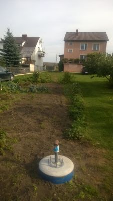

    I feel called to the board so I'll do some writing. I create all the time and experiment a little. The aforementioned solar tracker system, in the version only for the vertical axis, will ultimately control the relays. I believe that the implementation on relays will be easier. In addition, 2 LEDs about 5-10A and two limit switches (I do not have it yet), and there is a great protection. By using one more additional relay and some circuit on one operational amplifier, I am going to make a protection against strong winds. I made an anemometer from the HDD motor (the donor was probably Samsung 80 GB).
    https://www.youtube.com/watch?v=U8IMlxBONsI
    The engine working as a 3-phase alternator, after straightening, generated about 1V voltage in a fairly strong wind. Electronics of the "anemometer" will be connected to points X, Y. This signal is to place the PV panels horizontally. If there is then the sun, the solar tracker system should set the panels back to the sun. This is confirmed by the video from the experience with the solar tracker system. The indicator diodes (yellow and red) show that one "photodiode" illuminated by the horizontal sun will raise the panel and position it perpendicular to the sun.
    https://youtu.be/hIoZ1-Xpso4
    You can also add a vertical partition to the horizontal barrier - the diffuser, which should improve the operation of the system even more. The photo of the solar tracker plate shows a blue accurate potentiometer. Please do not be influenced by this, it is a remnant of my attempts to connect the anemometer directly to the solar tracker system. Unfortunately it was not possible. The circuit according to the scheme after soldering should work properly. The width of the blind spot is regulated by the width of the diaphragm and the bending-bending of the LEDs working as sensors. (To the left of the L272, I won't change anything, on the right, maybe, yes. Isostat switches from old stocks were supposed to be used there.)
    The horizontal rotation of the panels is to be controlled by a system based on an analog clock. The return to the east is to be carried out in the morning using the twilight switch. The mechanical elements look like in the pictures for now. What you can see are the elements of the Żuk's rear bridge. Generally, I use recyclable materials to build my device.

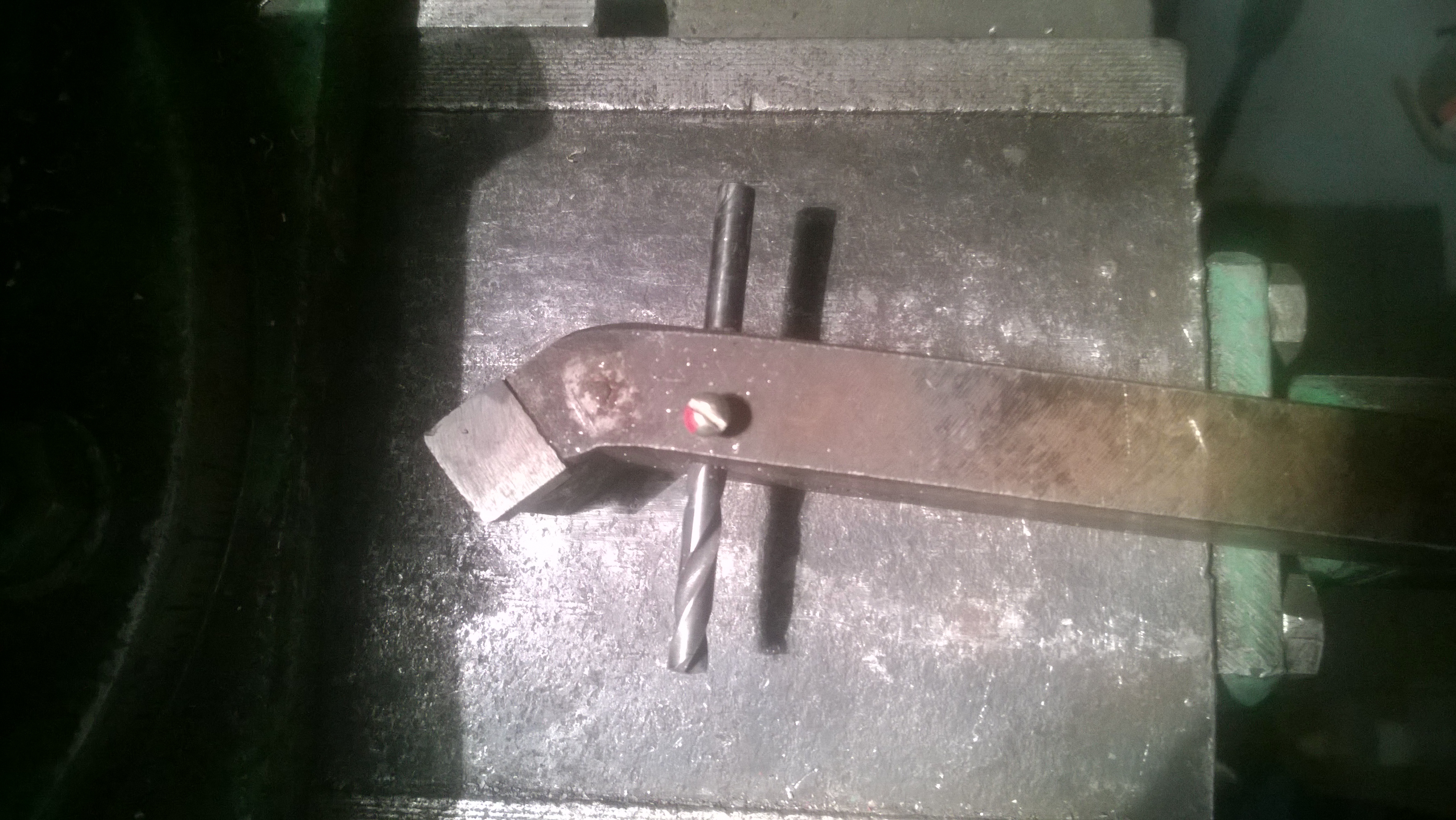

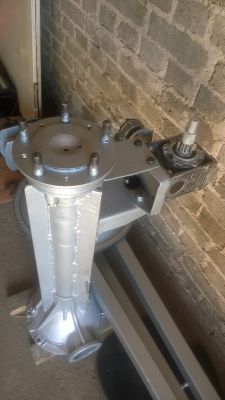

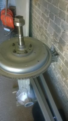

    can you describe how you made the connection for the taper spline on the motor? which is what you are installing the rack on it :-)
  • #26 18025695
    heniek07
    Level 21  
    Posts: 432
    Help: 29
    Rate: 221
    In the material fixed in the lathe chuck, first I drilled 3 holes, probably 6 mm, on the appropriate diameter, then rolled and cut the thread. I have a TUE 35, it has a wheel on the spindle of 96 teeth and I made a "dividing head" on it, I also have a new handle in which I attach the drill in a tool post. Two handles were created, because in the first one prepared for the worm gear, I changed the diameter for the shaft and used it for the engine. I did not plan to make a second handle to replace the rack. I was going to saw 3 lugs holding the rack and attach it to the weld at 3-4 points. Simple solar tracker on the L272M for controlling solar panels.
