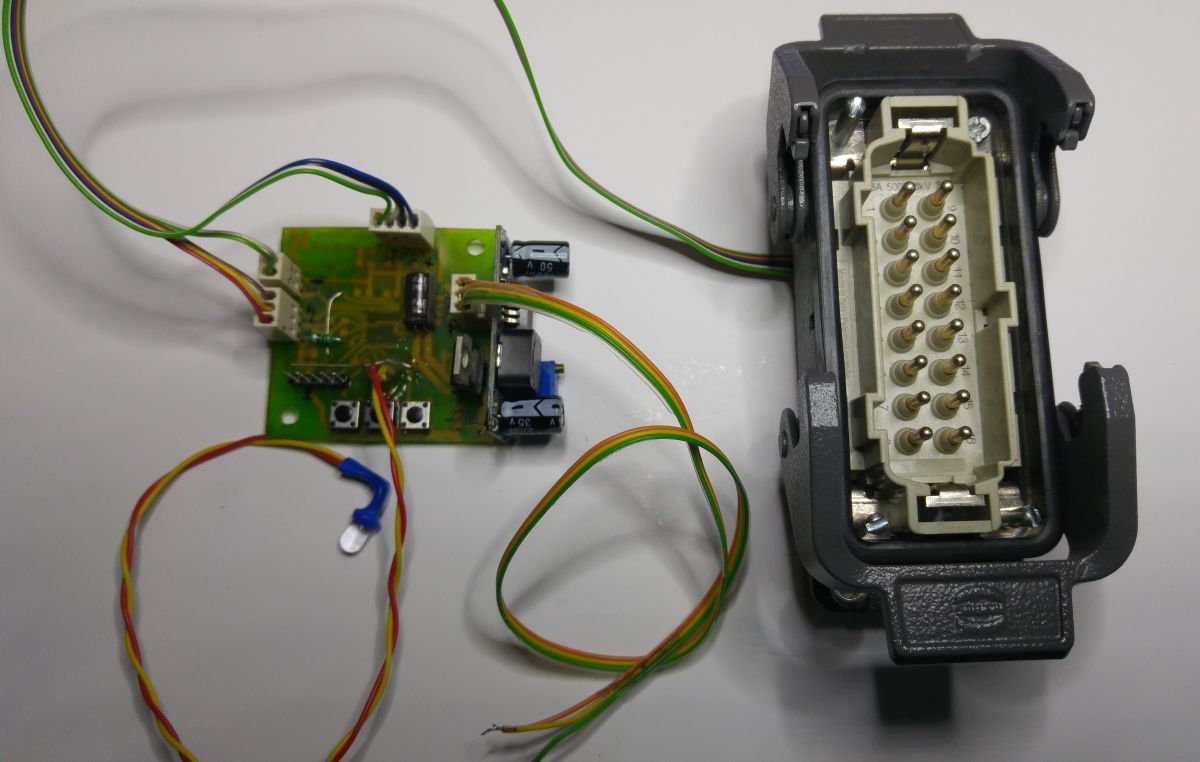

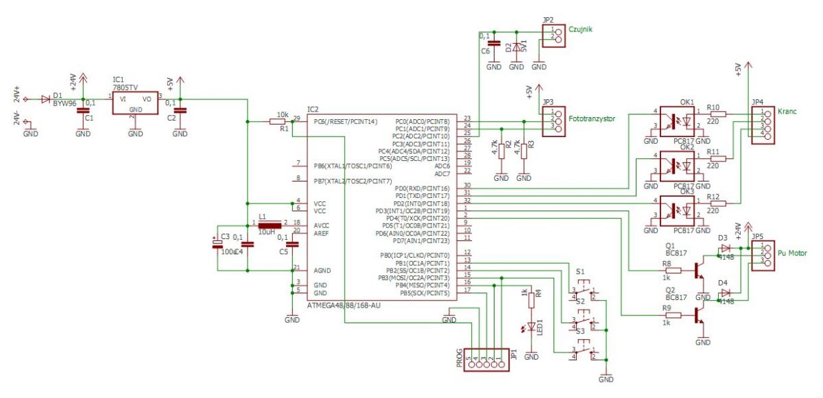

    Today I am presenting another controller of my creation for the solar tracker (the first one from 2011 is described here: Photovoltaic panel turntable controller ). This time, a rudder designed for a friend who made the mechanics himself based on an old trampoline, or more precisely, its rim with a welded-in gear. Everything is placed on a relatively flat garage roof, mounted on pins with stiffening reinforcements. They are not in the attached photos yet (actually there is one, the rest are being made). The structure with panels rolls on rollers, and there are similar rollers on the bottom to prevent the wind from blowing away the "sail". The rotation could be 360 degrees, but for obvious reasons it is limited to about 260-270. If by some miracle the limit switches do not work, the rack will simply run out and the movement will stop, and the engine will turn off automatically after a short time (time protection in the program will activate). The controller is single-axis (panorama only) - these were the assumptions.
    It would seem that tracking the sun could be done using one or two comparators and the matter would be solved - nothing could be further from the truth. As my experience has shown, a good algorithm means failure-free and fruitful operation of the whole. There are two schools of following the sun: 1-tracking, 2-clocking. I support option 1 and no one has yet had strong enough arguments to convince me to choose option 2.

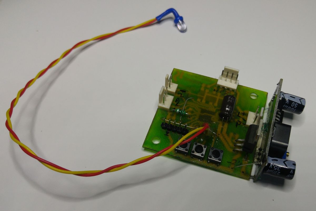

    So what does my driver have in it? It is based on Atmega168 (smd), and the program takes about 8kb written in C (predecessor in BASCOM. First of all, all movement options, buttons, etc. are protected by a time delay, e.g. there is no sudden change of direction without waiting first at least 1-2 seconds (longer in some situations).

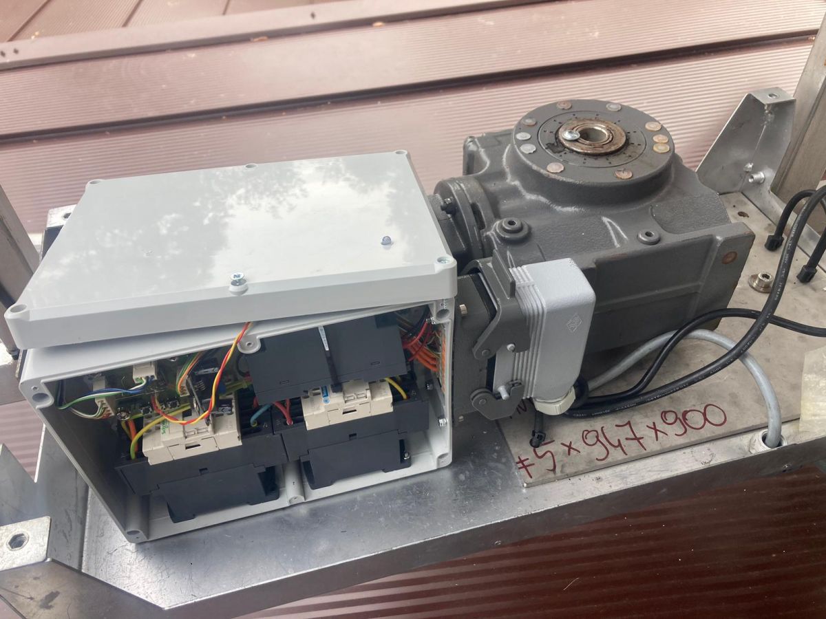

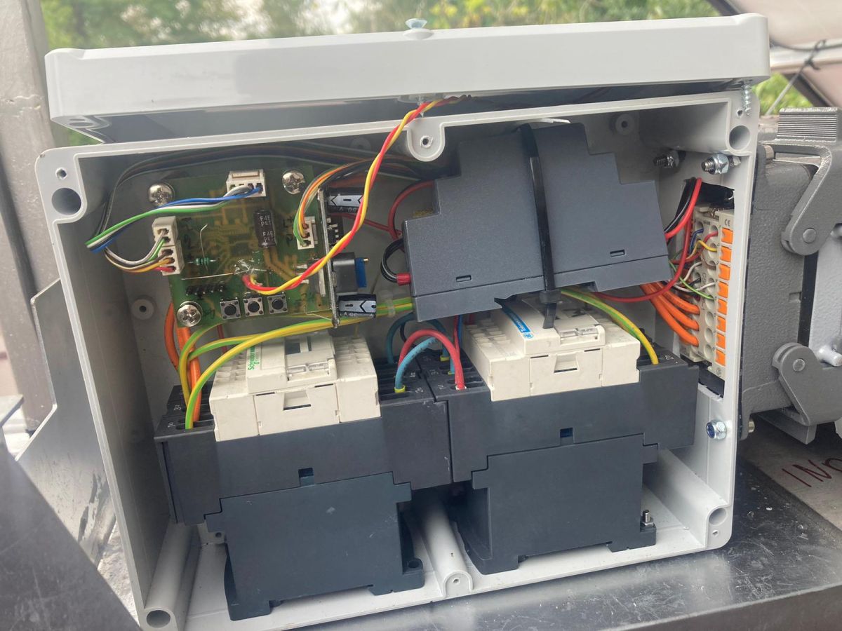

    The controller manages two 24V relays, switching on and changing the direction of a three-phase motor (a friend had one and it suited his project). If there was a sudden turnaround without time delay, it is easy to imagine that even a strong fuse would blow.

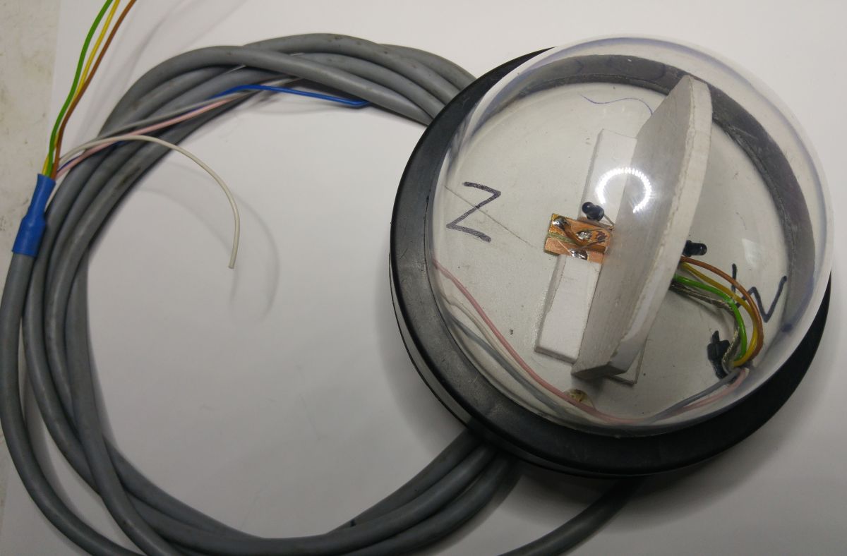

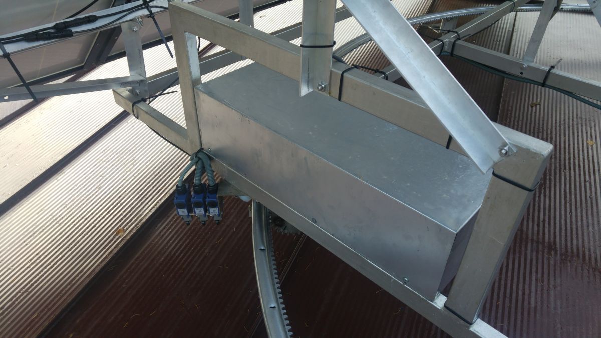

    The light sensor consists of two phototransistors placed with a partition in the dome camera housing (hermetically improved). This casing worked well in the first project, so why drill down.
    There is no additional photoresistor, which is sometimes found in other controllers of this type, to determine the parking level, and I am surprised by such solutions, because it is completely pointless, having two photoelements on board, which are perfectly capable of assessing the light level. The use of phototransistors instead of photoresistors as directional sensors is also important, because it is impossible to wake up the system by shining a typical, popular LED flashlight on the sensor, even if someone wanted to do it out of curiosity or malice.

    Main features of the controller:
    - tracking in both directions east - west,
    - on-demand programming of the tracking threshold (brightness level at which work starts and ends) stored in the eeprom memory,
    - tracking interval of at least 10 minutes (fixed), sometimes depending on the sunlight or lack thereof, after the countdown there is a waiting time for stronger light,
    - protection against momentary flashes (the sensor must be in a clear lighting state for at least 2 seconds),
    - manual positioning with tracker buttons in both directions (e.g. for maintenance purposes),
    - time protection against failure to reach the target (tracking, parking) and related personalized alarms to quickly determine the cause of the fault,
    - manual shortening of time delays (tracking interval, parking on demand, wake-up) for maintenance and testing purposes using a button,
    - each controller state is signaled by an individual, very intuitive and clear LED blinking time combination (9 states),

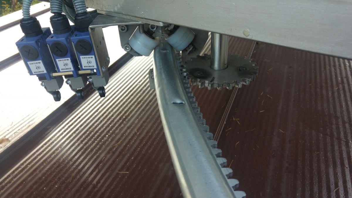

    - the parking position is determined by an additional switch (in this case the southern one),
    - all limit switches are connected to the processor via optocouplers for safety reasons (e.g. induction of voltages in the cables).
    The rudder also has an anti-wind input prepared and it is partially programmed (the executive part, i.e. parking on the southern end switch regardless of which side of the end switch it is located on), but my friend does not have any sensor at the moment and does not know the parameters to which the program should respond, so for now the input is unused and inactive.

    Electrical schematic of a solar tracker controller with ATmega168 microcontroller.

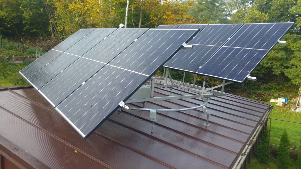

    Photovoltaic panels mounted on a garage roof with a rotating mechanism. Controller block mounted on a metal structure of a solar tracker with visible cables. Panel tracker control system with gear and sensors. Solar panel mounting structure on a roof.
    Solar tracker controller inside a housing with visible wires and components. View of the interior of the solar tracker controller housing. Geared motor with mountings on a metal structure.
    The image shows an electronic controller module with a multi-pin connector and colored wires attached. Solar sensor with two phototransistors in a dome-shaped enclosure.

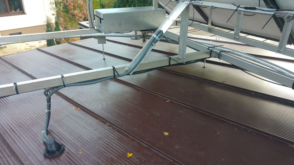

    Cool driver. What is the total cost of RBH? Why not something industrial? Even this Logo! to be enough, you can add a preview online, etc., etc. I don't like the use of the yellow-green cable to control the contactors (by the way, an interesting option of connecting them vertically on Schneider) and the lack of a DIY diagram ;)
    As for the mechanical structure, I hope it will be supported quickly, because the pins look very weak. The same applies to protection against falling off the wheel - I simply recommend a steel cable to the roof/lower structure. At most, the wind will knock the panels off the rollers, but it will not fly.
    Without exaggeration, this is not a thriller film in which the main character has to cut a red or blue wire :) I don't want to believe that when you make something for yourself, where no one will probably look, you always run to the store to buy 30 cm of blue to combine some crap when you have a roll of yellow-green at home. If it was a complicated box, you are of course right, it is worth maintaining some standards, but here, after opening, there are only two contactors and you can clearly see what is connected to what.

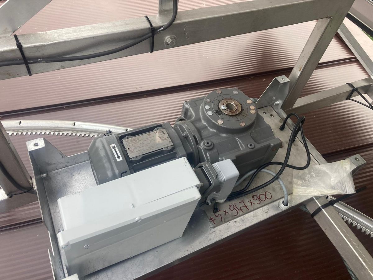

    Yes, I also pointed out to my friend the stiffness of the structure, and he also sees how it is, which is why he started making supports. One of the photos shows one already installed - and it does its job.
    However, the stroller will not fall or be blown away, because there are rollers at the bottom (see the video).
    (I added the diagram to the first post)

    A friend just sent me a video of the teacker waking up after parking overnight. A shot from literally half an hour ago as I write this post. Apart from the losses due to the covered second row of panels (I don't remember if the two independent streams are connected), the production is quite decent compared to if they were rigidly placed south.
  • #23 20795907
    sq3evp
    Posts: 6705
    Help: 226
    Rate: 900
    It looks nice.
    If there was adjustment in the Y plane, the panels would be slightly more vertical and both would be properly illuminated
  • #24 20797975
    Sofeicz
    Level 20  
    Posts: 401
    Help: 12
    Rate: 123
    In this configuration - not really.
    The panels are close enough to each other that at small angles one covers the other.
    In my opinion, it would be better if the panel "closer to the Sun" rose later than the next one.
  • Suggesting contactor interlock and analog supply filtering checks
    #25 20818297
    mfac
    Posts: 246
    Help: 18
    Rate: 65
    Epic! Respect!
    I once had an idea to build three rows of panels on the roof of a farm building, sloping to the west, with the top mounted on wheel bearings from a passenger car and the bottom running on guides or glides. This was how it was supposed to travel from the south-east to the south-west, and the vertical inclination would also be somehow driven. Unfortunately, due to lack of time and rather low profitability of such a combination, I am currently creating an installation with a constant azimuth and inclination set manually once a quarter in one of three positions - winter/spring-autumn/summer, respectively.
    And now back to your device -
    1. Do you have contactors between them protected against simultaneous switching on using auxiliary contacts? I understand that the program does not allow for simultaneous control of both transistors, but UC damage or transient states at the outputs do occur and it would be good if the control of one contactor went through the normally closed contacts of the other.
    2. Is the filtration of the voltage supplying the analog part of the uC really well done? Shouldn't the choke precede the capacitor?
    3. I would move the control buttons outside. They may be rarely used, but why open the can every time?
  • Relay interlock delays prevent simultaneous switching
    #26 20819010
    SylwekK
    Level 32  
    Posts: 2764
    Help: 82
    Rate: 2763
    @mfac, thanks :)
    I don't know how my friend connected these contactors - probably standardly, but from the program level there is no chance that both of them would be triggered. Not only are both of them always turned off first, but there is ALWAYS a time delay (min. 2-3 seconds) before one of the directional relays is turned on. This applies to both automatic and manual traffic. If the uC were damaged, and in my entire microcontroller career the processor in the controller failed only once, and that was at my own request (I didn't seal the housing and poured water on the controller) and somehow two relays were tripped, it would trigger the overcurrent protection and that's all it was supposed to do. place at the beginning when testing the tracker - I forgot about the delays in some places and it changed direction too quickly :)
    In fact, the diagram does not include one additional cap, which should be directly between AVCC and GND after the choke. In this case, however, it does not have a significant impact on the operation of the system, because the power supply is filtered well enough anyway. Either way, it's a good idea to have 100nF there.
    You don't go there often. After startup, the system is virtually maintenance-free. I added the control mainly for testing and maintenance purposes, e.g. when I needed to turn the set to correct something on the panels or drive. I would only place the LED in a more visible place, but my friend says that it is enough for him :)
