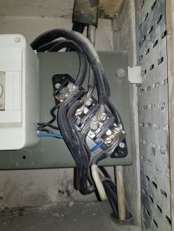

    Thanks Luke for unlocking (i cash register ) I wanted to write one more post for the future for others so that they would know that it is not always worth believing what the manager says and maybe they will know how they can check what wires are in the building,
    I wanted to add one more photo, following the directions from cash register I went to check what's in the corridor and it looks like the manager doesn't want to bother with pulling the 3 phases to the apartment, and not that it is impossible, I will try to attack him again, which is a concrete obstacle.

    But there are 3 phases from the vertical in the picture.
  • #36 17774327
    Elektromaciek
    Posts: 17
    I understand this photo as 3 phases vertically and after one phase it goes further to the pre-meter protection (on the left there are 3 security devices for 3 apartments)
    So, I'm assuming it's not an installation problem, but a problem that the manager had to do something so that I could have 3 connected to the apartment instead of phase 1? because the possibility according to the photo would be?

    Yes, in the normal world, you apply for the issuance of conditions for an increase in power to the EV, you get the conditions from them, as well as for the potential manager. Everything is possible, only this is a matter of costs. This current situation is typical, the risers are normal 3 phase and the apartments are single phase powered. All that stands in the way is that the manager does not want to play with it and puts you off. I don't want to destroy walls that have just been repainted, or for some other reason. Everything and the question of whether the tray / tube is on top, or you will do it differently and restore the previous look of the cage on your own.

    In the photo, 3 phases and PEN pass through the rail.
    So you have 3-phases and you have something to connect to.
    It is easy to check - check the voltage if it will be 3x 400V.
    Author, start with ZE.
    Apply for 3-phase conditions.
    That he has documentation. ZE decides if you can have 3 phases.
