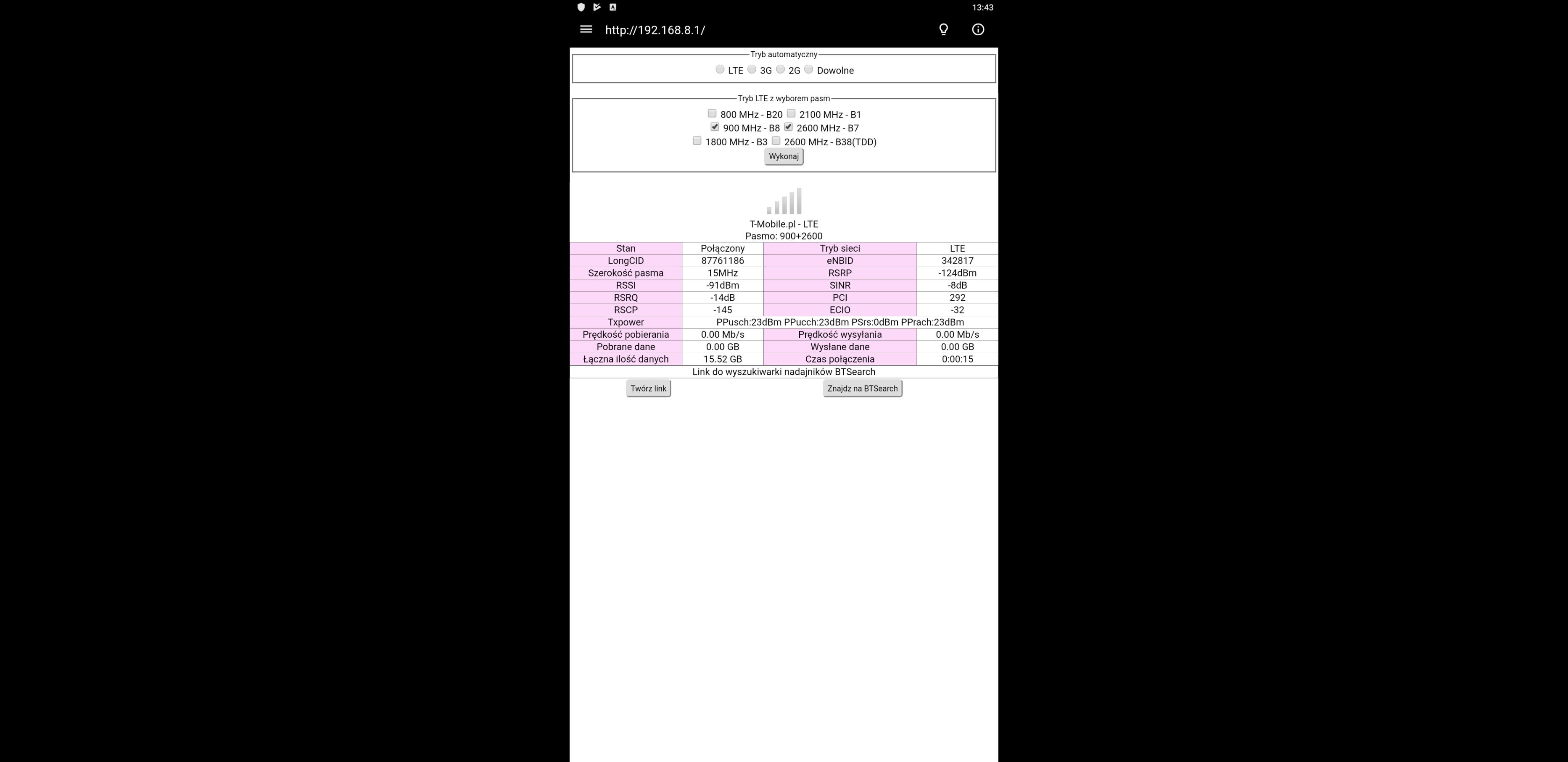

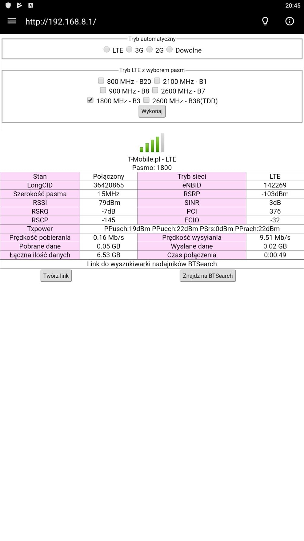

    with the lte 2100 you can not connect at all
    Hmanager dump from 1800

    Cyli BTS in Sianów at Dworcowa Street was not modernized, no LTE2100 and LTE1800 still shared 15MHz as part of NetWorks. LTE2600 is on Slovak, so the antenna is on it. Check also LTE800 in this direction.

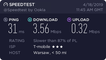

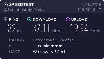

    The antenna is spinning to the sides and I get the same bts. In addition, on 2600 I can connect to this bts as in the picture:
    How to Check BTS Connection on PC with Huawei B592-22s Router & Typhoon Antenna (76-004 Sieciemin)
    The lte 800 works best in my case. Here's a screenshot taken today at 15.20:
