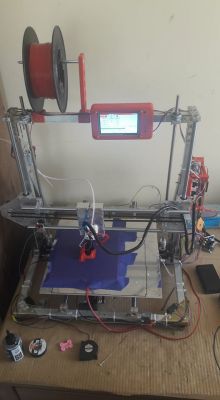

  • Hi, today I wanted to present you my construction of a 3D printer from start to finish designed and made by me! I'll start with the construction, at the end I'll summarise the costs :) I got interested in 3D printing through the 3D printing circle in my department at university, as I had just finished high school it would be worthwhile to get involved in something like this, but instead of participating in the life of the circle I was more interested in the machines themselves, which is why I decided to build one myself (to this day I am not in this circle, and all the knowledge about 3D printing I owe to the Internet and experience)
    I started by understanding how such a printer works and it's quite simple, there are three axes controlled by XYZ stepper motors and a head which heats up and through it the filament is "pushed" for printing. If anyone wants more information the internet is a huge source.
    My printer is of the FDM type i.e. three axes in a Cartesian system. The frame is made of 20x20x2mm aluminium profiles (about 5-6m) and quite a few allen head screws (M3 and M4 of various lengths). The dimensions are about 50x50x50cm, the working area is about 30cm in the x and y axes and 40 in the Z axis.

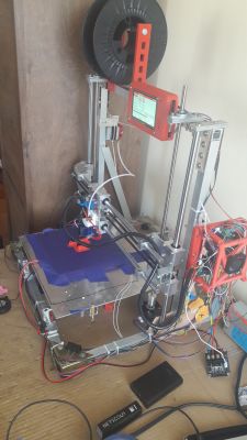

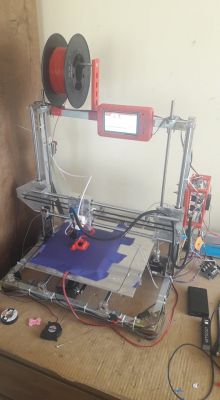

    Here a picture from a week ago, since then I have added a heated table and arranged the cables (a little). Now the printer is almost finished and ready to play with.
    DIY 3D printer on Ramps 1.4 + Arduino Mega2560 DIY 3D printer on Ramps 1.4 + Arduino Mega2560 DIY 3D printer on Ramps 1.4 + Arduino Mega2560
    As far as the electronics are concerned, I used a fairly common solution which is an arduino mega2560 (clone) with a ramps 1.4 overlay (+stepsticks A4988 for the stepper motors). The stepper motors are the well-known nema 17 (no point in packing bigger ones). The addition here is an LCD controller that allows the printer to work without a computer.

    I must sadly add that unfortunately still not every print comes out nicely, I blame this on the Chinese head and I am trying to buy an original e3d head :)

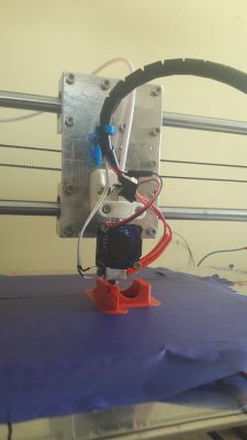

    The table is a popular heatbed on the internet
    Software:
    - software is Marlin 1.1.9 configured for my printer
    - slicer to cura
    - for controlling the printer I use repetier host
    - in addition, for design I use fusion 360 from autodesk (student version for free)
    I forgot to add that the mosfet is already there, you can see it on the photo next to the LCD.

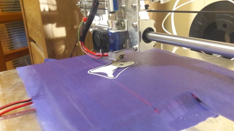

    This design has little rigidity, it is not the head that is bad but the nozzle, on top of that the extruder is a failure. How many steps per mm do you have 90? with a knurl fi 12mm.
    Print extra support for the vertical design, make the extruder for at least 300 steps per mm. and Give some better electronics than the Mega.
    What kind of microstep do you have?
    With these dimensions, be tempted to get a dual or at least a multi hotend.
    The only thing left of my Chinese printer is the frame, which in a cube arrangement gives fantastic rigidity, the rest has been replaced. give a neoprene pski.
    With these materials what you have used it will never be a good print strips like rubber bands from underpants, what is the oval tolerance for these rollers?

    For the contraption I'm planning stiffeners. The steps I have about 95 per mm, the extruder goes to change in the near future. As for the electronics, the 8bit mega must stay for financial reasons. The microstep, if I am not mistaken, is 1/32 or 1/16. As for the dual/multi hotend, again for financial reasons I cannot afford it at the moment

    The printer has been running for almost a month now, it has undergone some improvements. At this point the prints look very decent, here are pictures of some of the largest prints I've done, about 15x7x7cm and took about 6 hours.

    The printer is still undergoing modifications, the last biggest change was the installation of a new head board, namely a duo 2 wifi (clone). I'm now even happier with the prints and the culture of the machine :) I'll soon be rebuilding the printer into a larger one with a 50x50x50 working area, as I'll have access to cnc milling so I won't have to cut anything by hand :) I'll post progress from time to time :) :)
    DIY 3D printer on Ramps 1.4 + Arduino Mega2560 DIY 3D printer on Ramps 1.4 + Arduino Mega2560 DIY 3D printer on Ramps 1.4 + Arduino Mega2560 DIY 3D printer on Ramps 1.4 + Arduino Mega2560 DIY 3D printer on Ramps 1.4 + Arduino Mega2560 DIY 3D printer on Ramps 1.4 + Arduino Mega2560 DIY 3D printer on Ramps 1.4 + Arduino Mega2560
