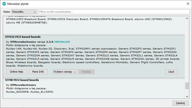

  • Suggesting alternative ways to add Blue Pill board support
    #50 20178376
    MVictor
    Posts: 27
    Hello!
    I am a total beginner in MC. I want to add to the Arduino IDE stm32 Blue Pill, according to the description provided here, unfortunately in the preferences it adds (I type manually, I can't paste) the link here: http://dan.drawn.org/stm32duino?..... etc. I get a "download error" message.
    I don't know what I'm doing wrong. Is there any other way to add this board to the Arduino IDE?
    I will be grateful for your response.
    Regards.
  • Updated Arduino board manager URL for STM32 support
    #51 20178464
    rb401
    Posts: 3002
    Help: 750
    Rate: 984
    MVictor wrote:
    I want to add to the Arduino IDE stm32 Blue Pill, as described here
    The description at the beginning of this thread is no longer valid. At the moment, the handling of STM32 boards is much richer and, above all, officially supported by the STM company. The server that was indicated at the beginning of the thread to add to the preferences is currently turned off and your Arduino has no way to download these tiles.
    To download STM32 support you have to add another address to your preferences (you can remove this old address "http: //dan.drawn.org ..."):
    and then what you need will pop up in the tile manager:
    STM32 Blue Pill - an alternative to Arduino
    Here is the current, official installation description for STM32 boards:
    https://github.com/stm32duino/wiki/wiki/Getting-Started
  • #52 20179302
    MVictor
    Posts: 27
    Hello!
    "rb401" - thank you for comprehensive and specific information!
    Installation went smoothly.
    It's a lot for me, because I spent two days trying to install stm. I looked at a lot of tutorials and videos on YT, and they all referenced this broken address.
    And I will say as in the ad: "I did not know there was such a simple solution"!
    Thank you.

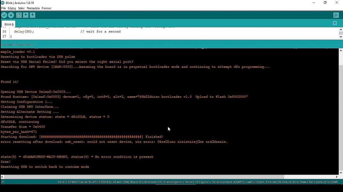

  • Blink upload indicates bootloader installation succeeded
    #53 20254436
    MVictor
    Posts: 27
    Hello colleagues!
    Once upon a time, I got very constructive help in this forum regarding STM32.
    I mark I'm "green" in the subject of this MC. For several days I have been struggling with uploading the bootloader to the Blue Pill STM32F103C8T6 board. Unfortunately, the tutorials found on the web did not help me much.
    Somehow (?) I was able to install the bootloader to my MC. It looks like the Blink arduino IDE is working. Receives a jakk message on an attached .jpg.
    Therefore, I have a question for colleagues who are familiar with this topic: is everything ok. And can I assume that the bootloader installation was successful?
    I would be grateful for a constructive reply and possible suggestions.

  • Bootloader installed, but Arduino build tool missing
    #55 20256704
    MVictor
    Posts: 27
    "rb401" Thank you for reply. But that's not what I meant.
    FTDI + Flash Loader Demo (v2.80) + loading boot20_pc13.bin + Installing USB drivers from (Arduino / hardware / Arduino_stm32 / drivers / win / instal driver, bat)
    After connecting to USB, Blue Pill is recognized by the IDE on COM8.
    In Win10 Device Manager as STM serial (COM8).
    And I manage to upload a blink from the examples. (it takes ... a long time).
    My question was whether I was able to properly install the bootloader.
    I do not understand the message displayed under the sket, is there a problem with my STM?
    These are my own settings (I will not list all of them now, because I don't know if it is needed), other than those found in the network.
    Added after 14 [minutes]:
    However, if I upload the blink as: "STM32F103c8 (20k RAM, 64k FLASH)
    Upload Method: "STMduino bootloader"
    I get a message when uploading:: /Arduino:1.8.19 (Windows 10), Tile: "Generic STM32F103C series, STM32F103C8 (20k RAM. 64k Flash), Serial, 72Mhz (Normal), Smallest (default)"
    exec: "/ bin / arm-none-eabi-g ++": file does not exist Build error for Generic STM32F103C series board.
    Through the Library Manager I am unable to download and install (necessary, as I found on the web):
    Arduino SAM Boards (32bitARM Cortex M3) by Arduino "v1.610
    It's just that Library Manager doesn't find it on the web!
    Regards

    #56 20256854
    rb401
    Posts: 3002
    Help: 750
    Rate: 984
    MVictor wrote:
    FTDI + Flash Loader Demo (v2.80) + I'm loading boot20_pc13.bin
    Aaaa. So via UART, jumpers, etc. I missed this information.
    That's ok. In STM32, uploading the bootloader is identical to any other standalone program, because it is basically the same. You have uploaded it, it started and it works as the author wrote it. It is difficult for me to comment on the speed of programming, because I upload programs only with STlink.
    On the other hand, programs loaded by such a bootloader must be adapted to be loaded "a bit higher" in memory, because the bootloader is at the very beginning of memory. But Arduino controls it.
    By the way, it is different, for example, in Atmel's uC (eg ATmega in Arduino UNO), where the bootloader is loaded at the end of the memory, it switches to start from the address at the end of memory in fusebits, but the programs are "normal". And here just installing the bootloader is not only about uploading the memory content.
    Added after 12 [minutes]:
    I have the current version of the package for STM32 and I don't have the "STMduino bootloader" option in Upload Method, just some DFU maple.
    Maybe it's some not exactly matched versions of the bootloader and support on the Arduino side.
    As for the error you have on the screen that some reset did not work, it may not be important. It is important that it has been installed without errors.
  • #57 20256885
    MVictor
    Posts: 27
    Well, thank you again for the answer.
    I hope that this bootloader is actually installed in my STM-e ...
    The point is that he doesn't give me extra trouble. I'm an older guy now and have a hard time solving these kinds of problems.
    For me, the most important thing is: "copy + paste + send to MC + run" Ready project developed by someone.
    Thank you and best regards.
  • STM32duino can upload directly over serial
    #58 20257809
    rb401
    Posts: 3002
    Help: 750
    Rate: 984
    If Flash Loader Demonstrator did not throw an error, you have installed it correctly.
    It is no longer relevant. Once upon a time the package for STM32 used the compiler for ARM processors from that package for SAM Boards and it was actually needed. But now the package for STM32 includes its compiler and that package is completely redundant.
    But does this project of yours necessarily require a bootloader for some reason other than just uploading a compiled sketch from Arduino? However, because the bootloader complicates various matters (reduces the available memory, delays the start of the program, etc.), in relation to uploading only the main program.
    I am asking because from Arduino you can directly save the program to Blue Pill in the same hardware way as you uploaded this bootloader with Flash Loader Demonstrator, i.e. via FTDI (or a similar adapter) to pins A9, A10, BOOT0 jumper etc.
    Only that you do not use Flash Loader Demonstrator, you just select "STM32CubeProgrammer (Serial)" as Upload methods in Arduino and below you enter the COM port number of this adapter. Now I tried practically this way of uploading to Blue Pill and it works as it is supposed to work.
    In order not to be too easy, before using this method in Arduino, this program must be downloaded and installed on the computer:
    https://www.st.com/en/development-tools/stm32cubeprog.html
    although you don't need to do anything or even run it. Arduino uses it internally.
    Simple installation, no hassle. The only inconvenience is that you need to register and log in before downloading the installer. But if what, I give here an account ready not to waste time:
    In fact, it takes a long time from pressing the Upload button to the end. But what I see this long time is not a matter of just uploading to the bone, but some long thinking about Arduino before starting the compilation and then processing a lot of files. And it doesn't depend on the save method you choose.
    And the proper programming of the cube itself, i.e. how the red inscriptions in this bottom window are going, is a little while.
    For example. With this method, through an adapter, an ordinary blink with about 22kB enters in less than 6 seconds (the same, but via STlink it enters in 1.5 seconds). So these times are bearable. You can be similarly fast by this bootloader. Just pay attention to how long these red inscriptions fly.
